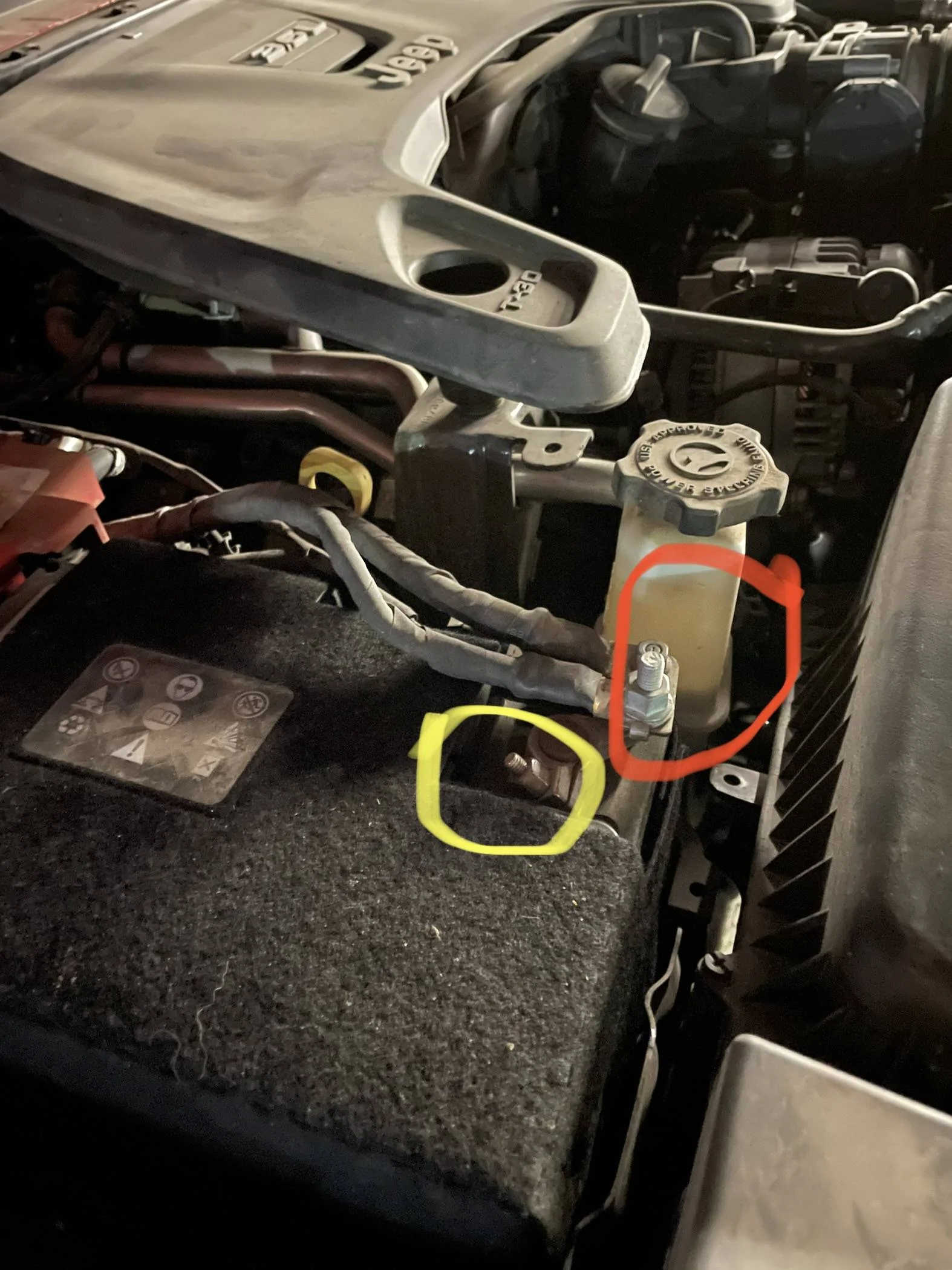

To disconnect both batteries use a 13mm to remove the nut circled in red and bend that cable up out of the way, make sure it is not touching anything. Then use a 10mm to disconnect the terminal circled in yellow, make sure it isn’t touching anything and wait a few minutes and reconnect. Everything will reboot and reset.

Now it doesn't list Doors and Locks in the Settings menu. The line that listed Lock preferences and Passive Entry is not there now.
disconnected the battery for a while and reconnected. When I powered it back up, the display writing was now blue (used to be red--because Rubicon?).

Give it some time to reboot and recognize all the hardware. Takes a bit to come back to normal after a battery disconnect.
