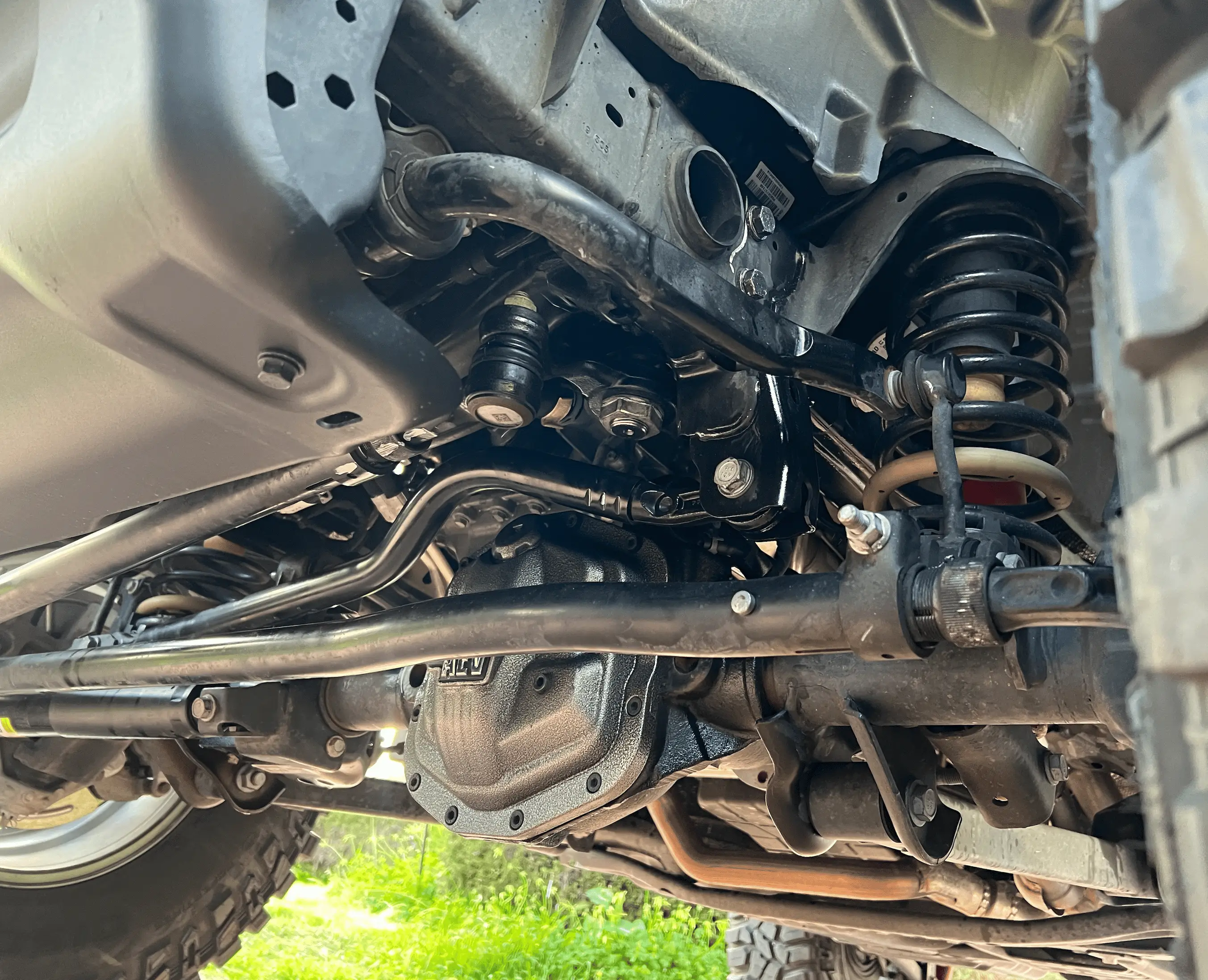

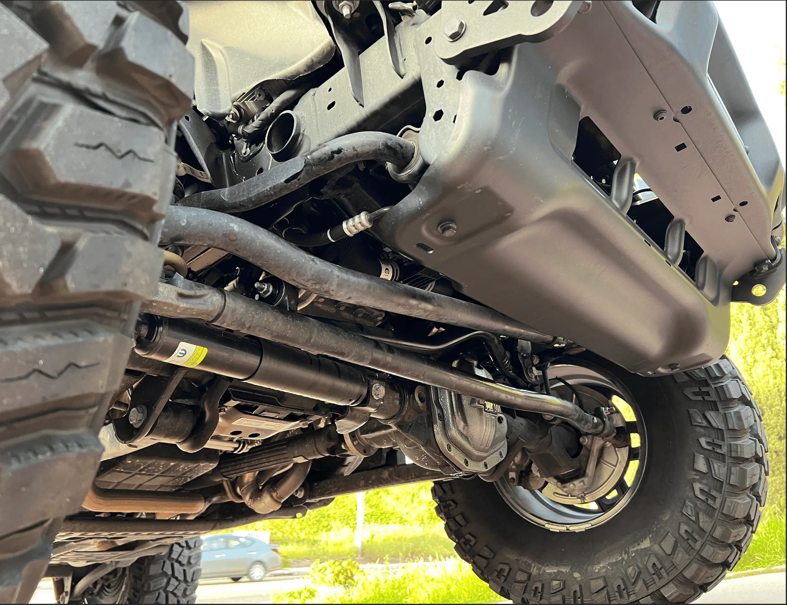

No. My replacement did not show such signs. Almost sounds like steering damper is not centered correctly. Can you post a picture of your steering linkage? Another thought is they did not reprogram after box install which some people here have seen issues with.
Here you go! Let me know if those work :fist bump:
Also, before the steering gear update they changed my steering damper and that was fine. Then fast forward to today, the steering gear was updated. Everything else is bone stock
