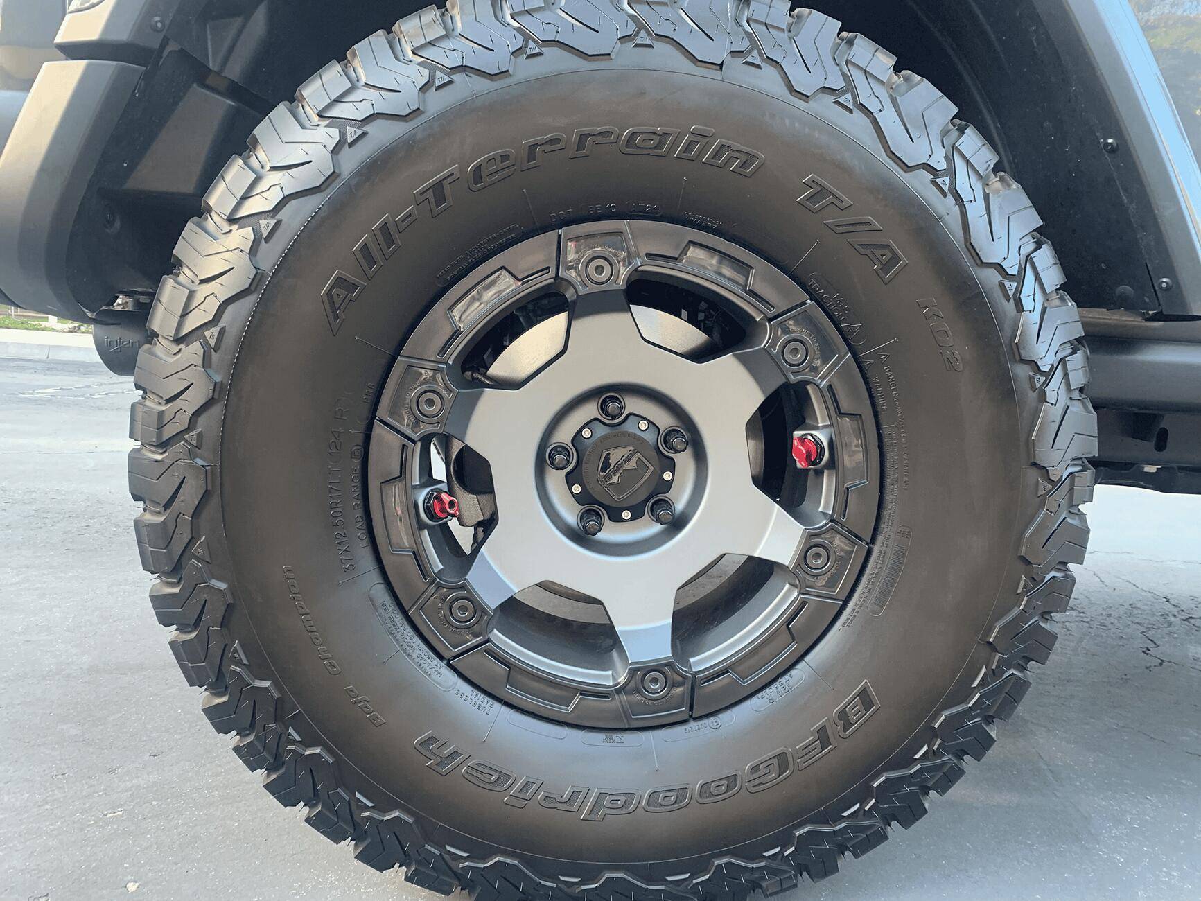

I went with the TeraFlex Nomads for the rapid deflators, the knurled inner edges to hold the tire edges on the wheel better when aired down, the protected valve stem, the replaceable rash guards, the offset, lightweight, easy to clean, and because they look rad.

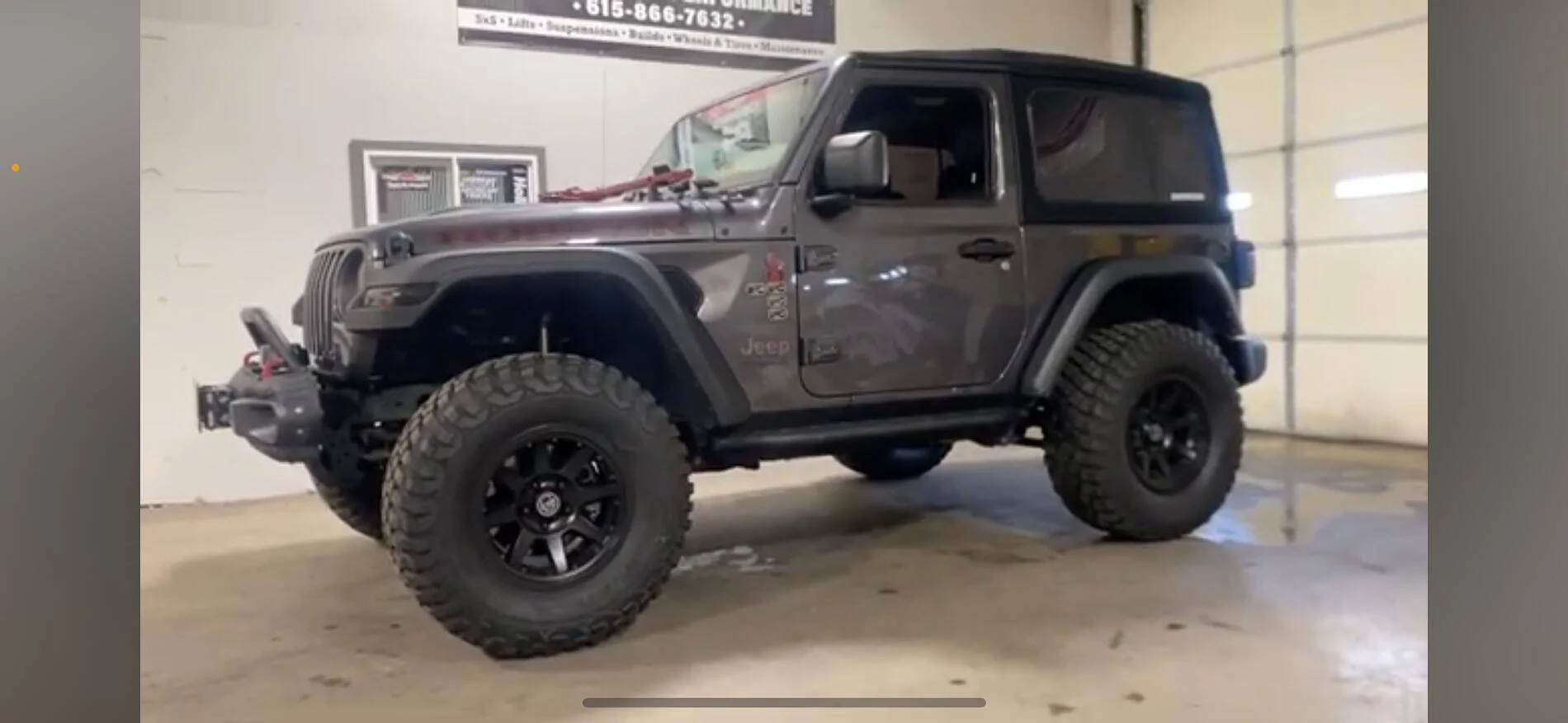

I like the Icon Alloy rebound pro. Internal bead lock. Street legal (DOT approved). We have a lot of rocky terrain and need to be able to air down. Mine are satin black.
2-1/2” RC lift and 315/70R 17 with 4-1/2” backspacing

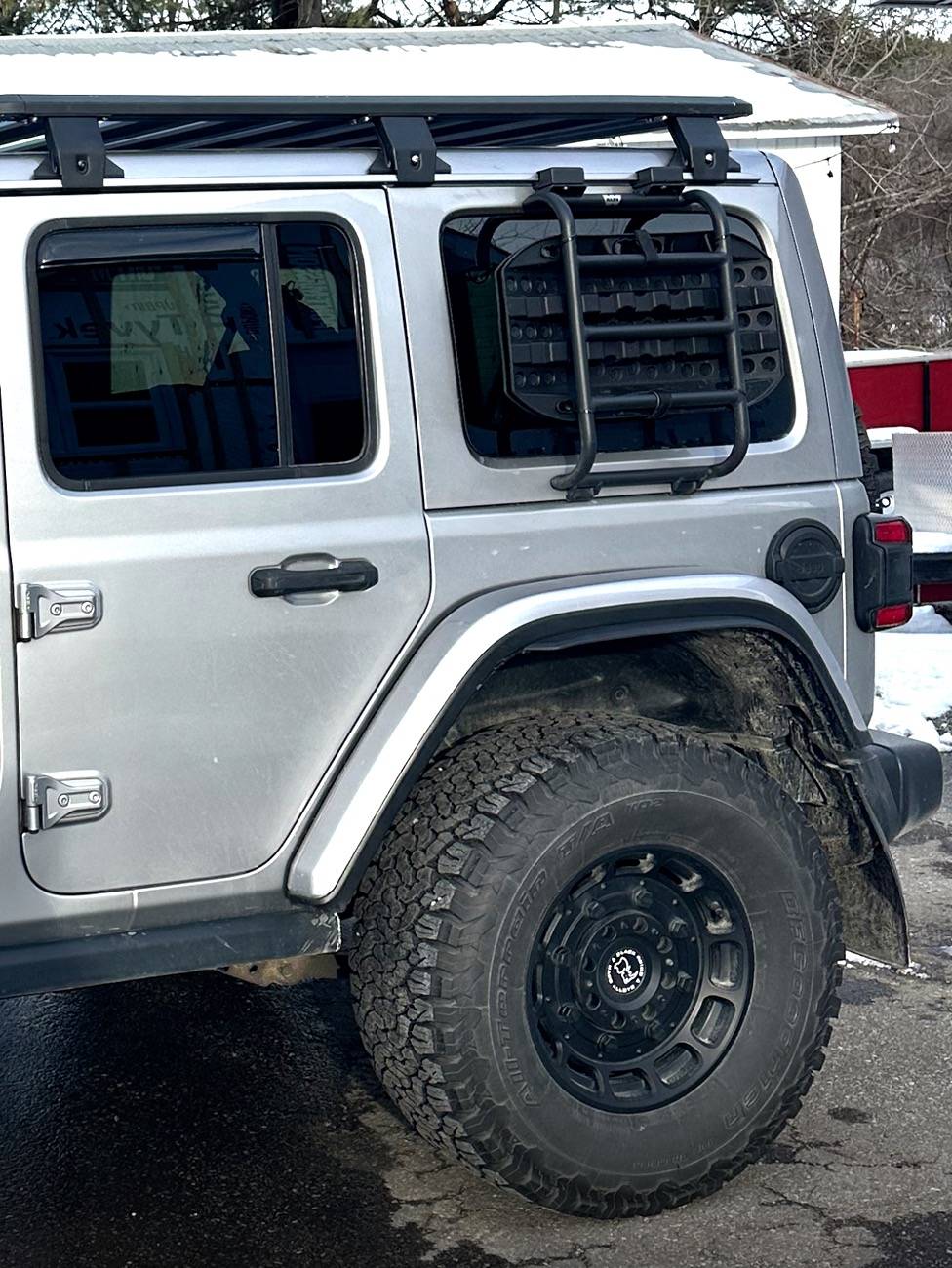

I don’t blame you, Rockstar wheels were a thing 25 years ago, but have become quite cheezy.
Black is always a sure thing as it matches every exterior colors. Bronze look good on burgundy, white and black, but is definitely a trend on its way out.
I recommend you look at Black Rhino wheels, they have different offsets, are hubcentric on Jeep applications and depending on the model, fairly light. My 17x8.5 only weight 27lbs.
