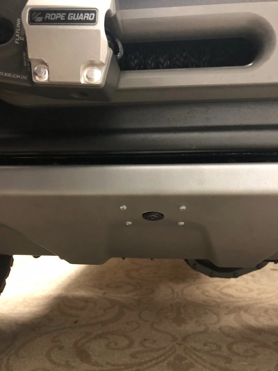

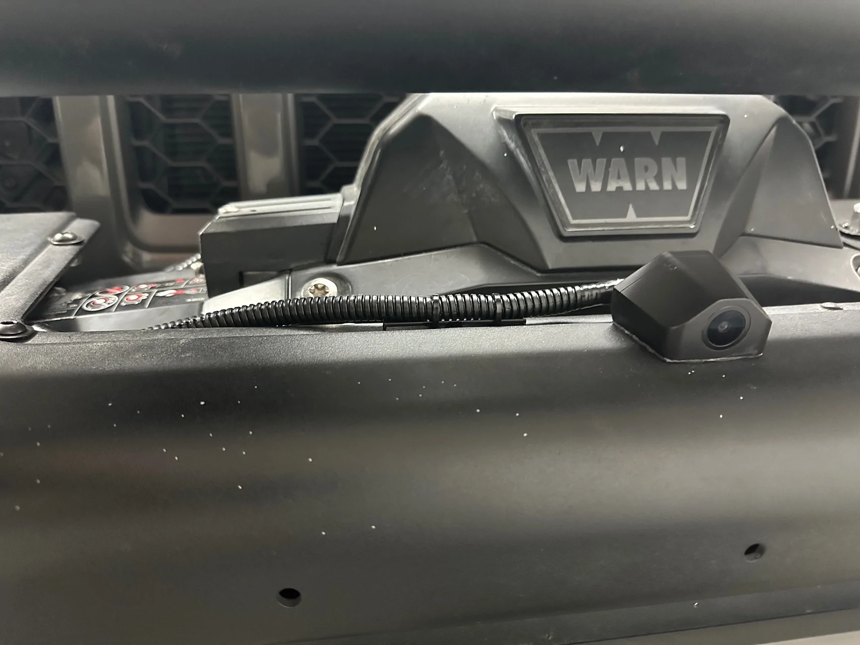

The Bolt aasembly does require moving the OEM “trail camera“. I moved mine to my ARB skid so I see the leading edge of my front tires and maybe 6-8 feet in front of them. This way I don’t inadvertently run over shopping carts laying on their sides at the mall. I have the Wolfpro set up with a bumper cam in front of the winch.
Jeep Wrangler JL Hood lock IMG_1140
Jeep Wrangler JL Hood lock IMG_1141

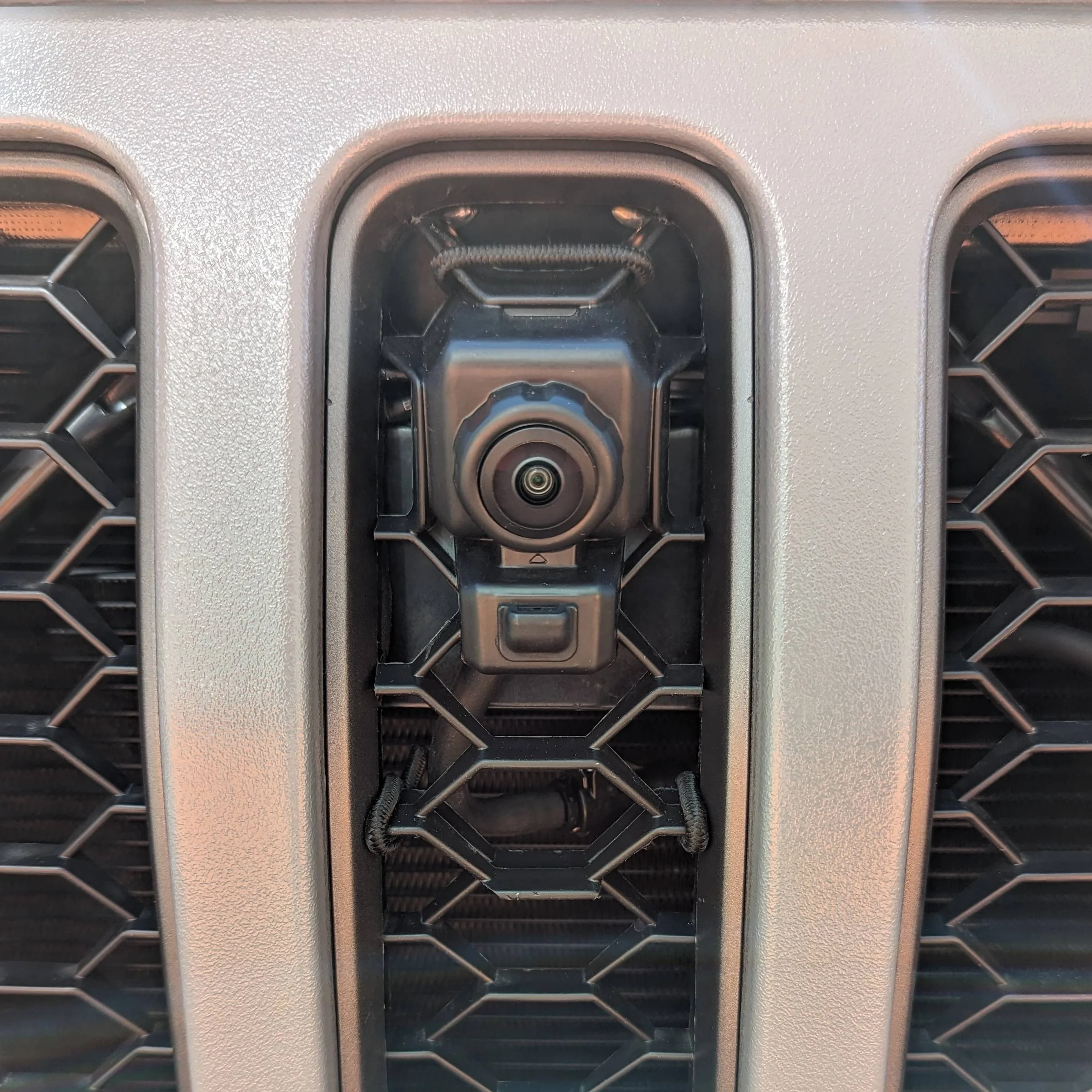

I have the Bolt. Works great but I hear it conflicts with front trail cameras. I don't have one so maybe someone can confirm or deny that.
I primarily have it to impede young & dumb shenanigans at trailheads, not professional thieves.
I DIY'd a solution for the Bolt Hood Lock and factory TrailCam.
Jeep Wrangler JL Hood lock {filename}
