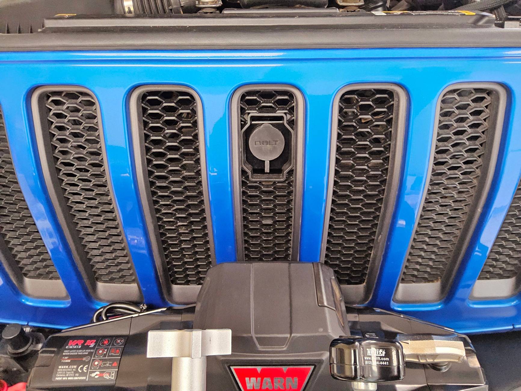

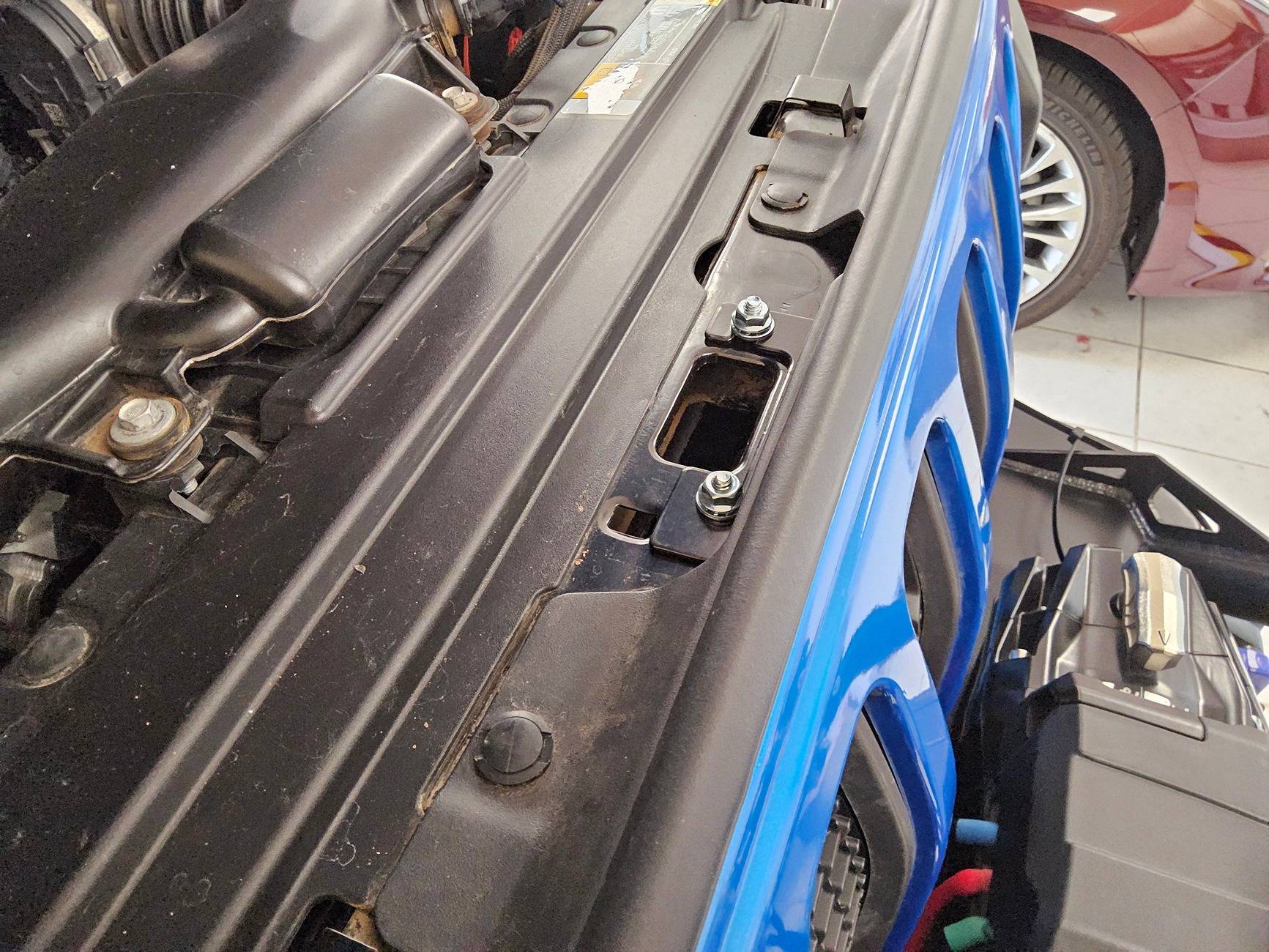

I got my Bolt Hood Lock installed today. I had to improvised regarding installing the locking mechanism to the vehicle. I thought I had the appropriately sized pneumatic Rivet Gun doohickey for the 1/4" rivets. So, I elected to use bolts, flat and star washers, and flare nuts to bolt in the locking mechanism. Since, the mechanism assembly really isn't load bearing, I didn't see any reason why wait and order the Rivet Gun things, so I went the bolts, etc. I'm sure there won't be a future problem with the bolts and nuts, it's not going anywhere.
As a few of some previous posts stated, coding the key was a little challenging but, it does work fine now.
Speaking of challenging, my Warn Winch is just an inch or two away from my Grille. It was very tight in removing the screws holding the grille panel in the grille and removing the grille panel but got er dun.
Onto my next project. I'm going to install/mount an ARB Twin Air Compressor in the engine compartment. That'll keep me lugging the Air Compressor out of the back of the Jeep when I air up.

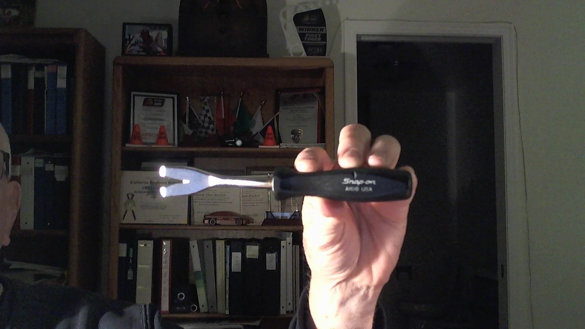

And as a less than the $20 option if you don't want to do the Rivet thing because you more than likely won't ever need a Rivet tool for a 1/4" rivet, the screws and stuff were only $12.43 from the local True Value Hardware, and if you have a winch in front of your grille, unless you're up to removing the winch, you will never get the Rivet Tool on the two front rivets anyways.
The Clip and/or Trim Removal Tool definitely does help, but the Snap-On A1618 tool these days are a tad more than $5.00. Snap-On wants $49.25 however, you can find the same Snap-On A1618 tool on eBay for $42.77, not including shipping, for a pre-owned tool. I recommend don't buy the eBay item because they want $37.73 for shipping from the United Kingdom.
So, just go with the $5.00 tool. It'll do the same thing popping out your little plastic doo-hickeys.
