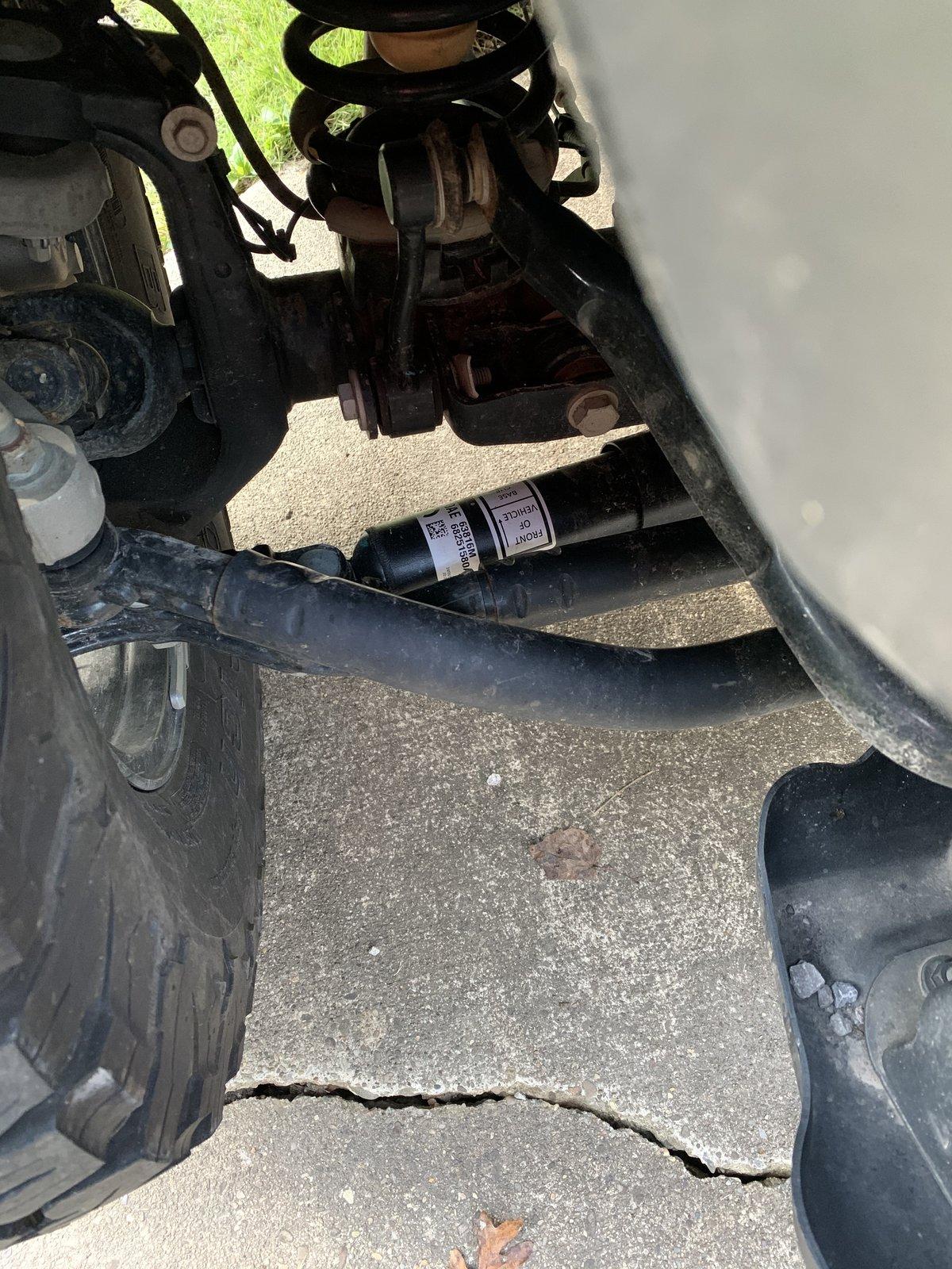

I just started a thread on this. The dealer did the recall and put the shock on upside down. Look at the sticker then check yours as this causes bad bump steer and wheel shake
Confirmed. Dealership put it on backwards. Unreal
My V41 got installed upside down and it drove like crap (worse than before) straight off the lot. I drove the 1-1/2 miles from the dealership to my workplace before a quick check revealed my suspicions. I should have checked it on the forecourt but it was chucking it down with rain!
When I phoned the workshop to try and get it back in they couldn't look at it until the following day. When I asked if it was safe to drive until it was fixed their response was 'it's only a steering stabilizer, it shouldn't make make much difference' :mad:
Make sure you enter this poll, currently running at 40% of V41's installed upside down:
https://www.jlwranglerforums.com/forum/threads/v41-recall-installed-upside-down-club.39327/
That's what so weird. Mine drove 100% better after the recall and it was on backwards. Who knows what I'm gonna get when it's put on correctly
