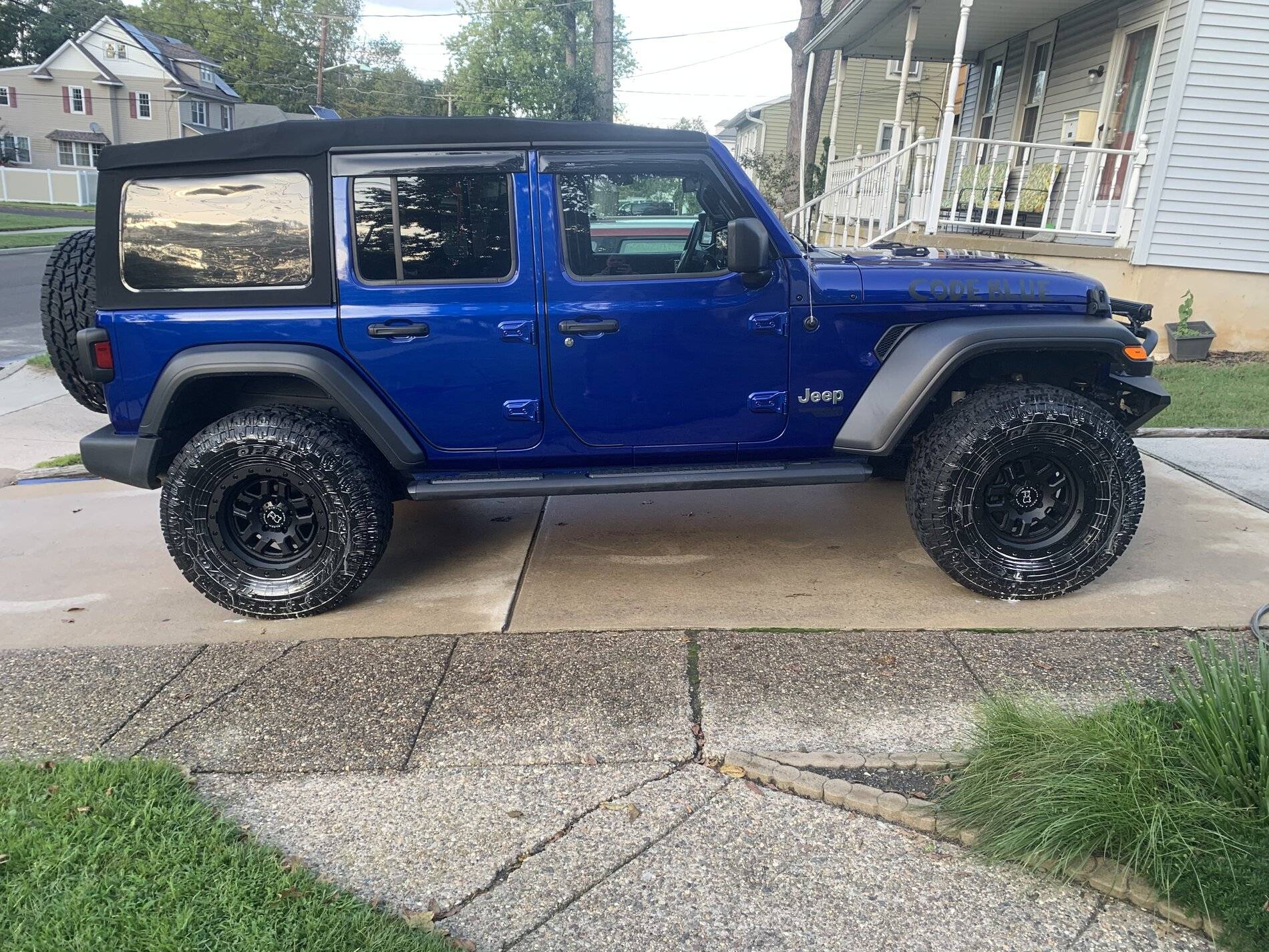

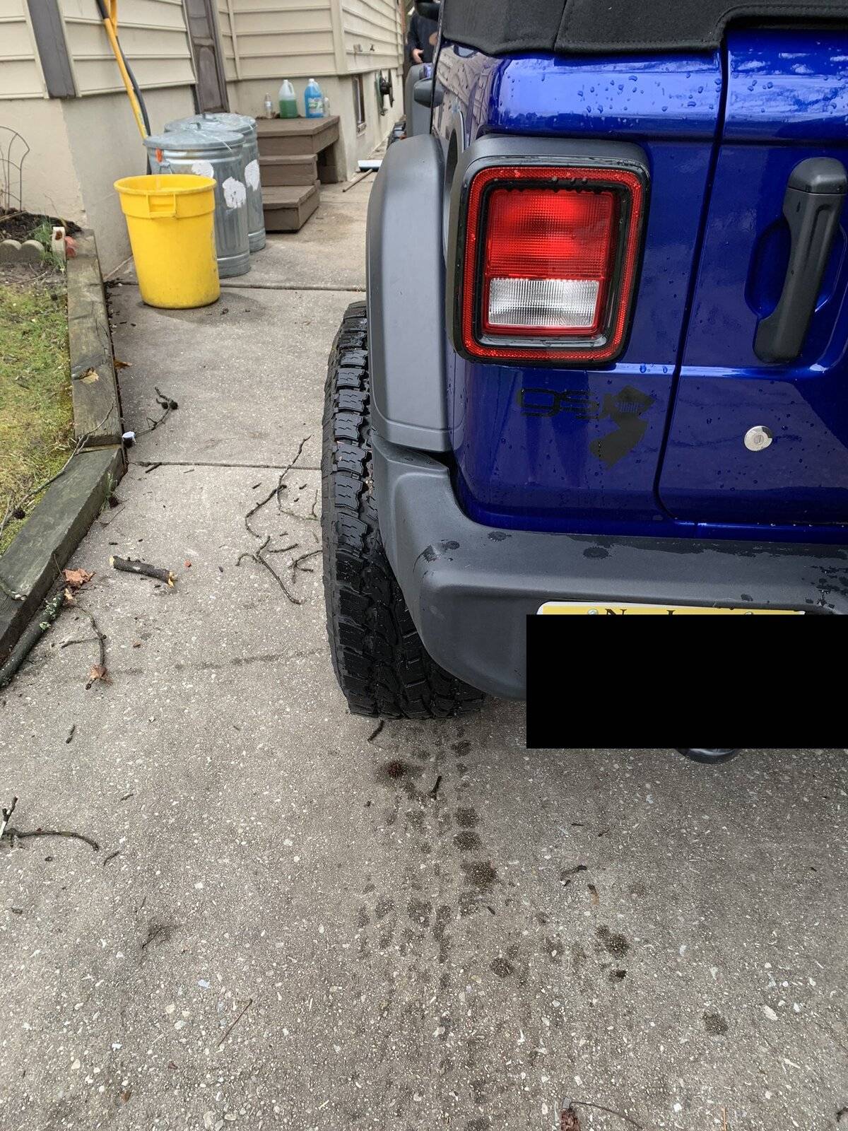

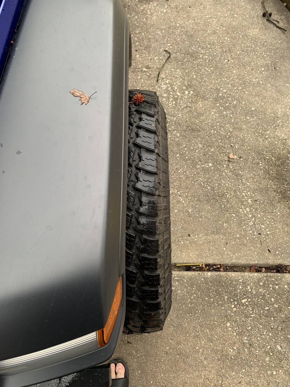

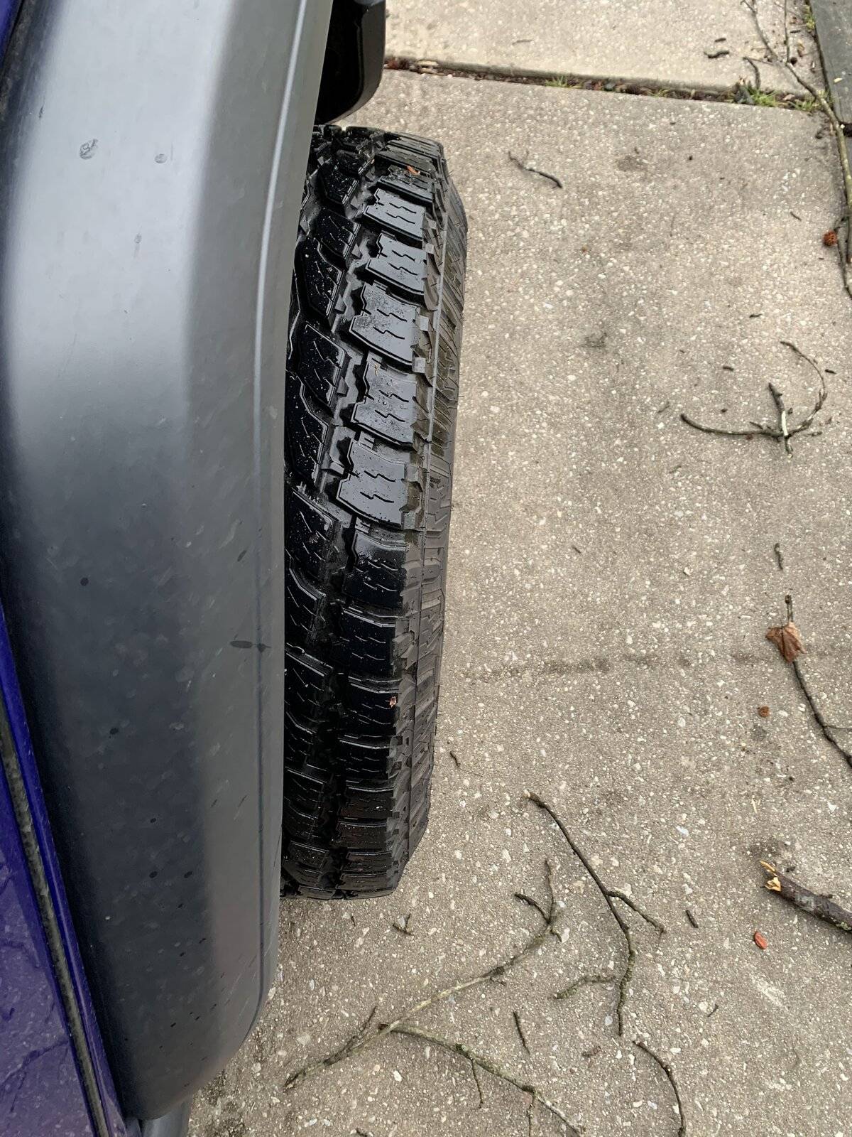

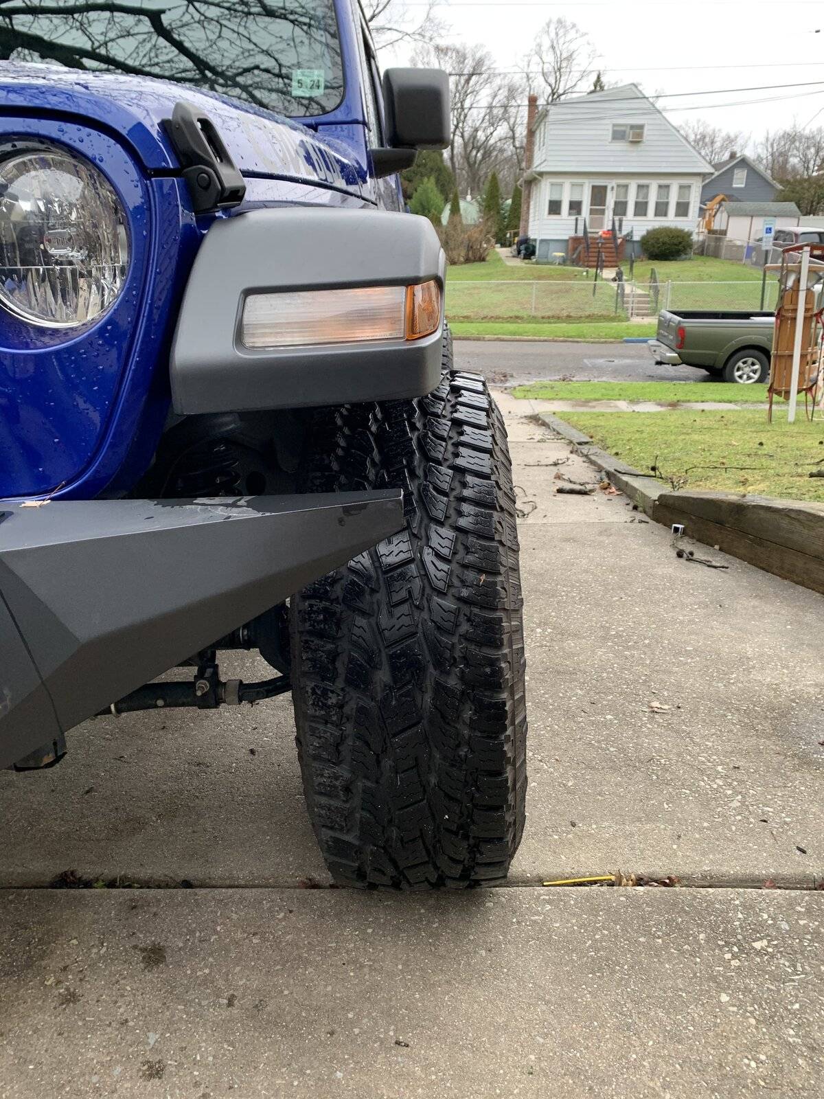

I run the same kit with 17x9.5 -18 offset. I put the spacers on and didn’t change anything else. No issues with tracking at all. I run 17 miles highway to work everyday. Not saying blnewt is wrong just my experience. If you go -12 you’ll poke 1/4 less and the -6 will be about 1/2 less.
