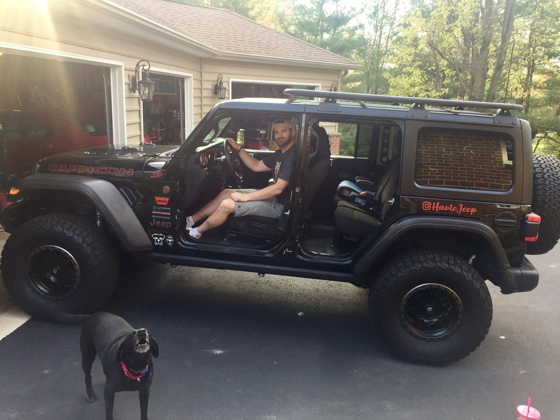

IF you go with the Maximus-3, which is essentially a Rhino-Rack, it is really great because you can switch between the cross bars and the pioneer platform. I just put on my pioneer platform today and it is rock-solid! You won't regret it.
Jeep Wrangler JL Help with roof racks please! IMG_2855

What a nice rig you have dude! I like how that roof rack fits! Have you made any other update to your rig?

Thank you! I actually took the Rhinorack off! But yes, I’ve added a KC gravity pro light bar, which, grill guard, etc.
