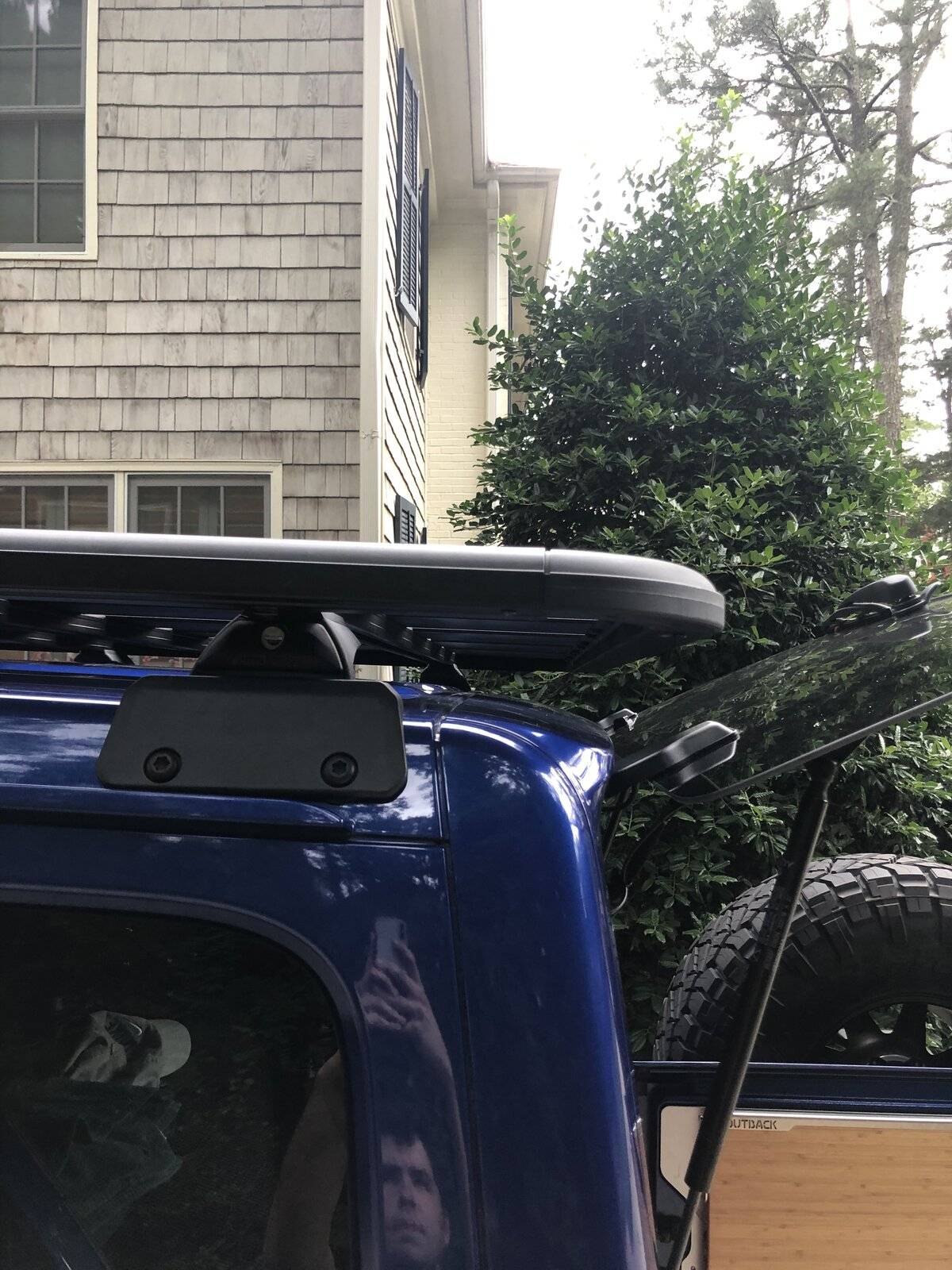

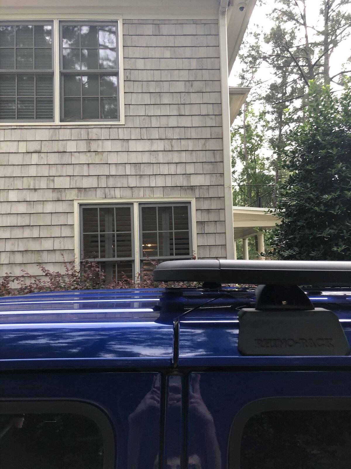

I recently mounted my pioneer platform and noticed that the back of the rack stuck out a little on the back... any ideas as to what I did wrong? Is this normal?

Also, it is the 72 x 56 inch, the first gen version of it. I mounted it with RCL Legs and QMHD05 spacers. I also did the bit where you have to drill new holes for the legs to match up with the backbone.

Disclaimer: I didn't install my own so I'm not 100% sure what options you have. That said, mine is definitely slid more forward than yours. I don't have the rear overhang and it covers my freedom panels more. If you loosen the mounts, can you slide it forward? If not, maybe rotate the whole thing?

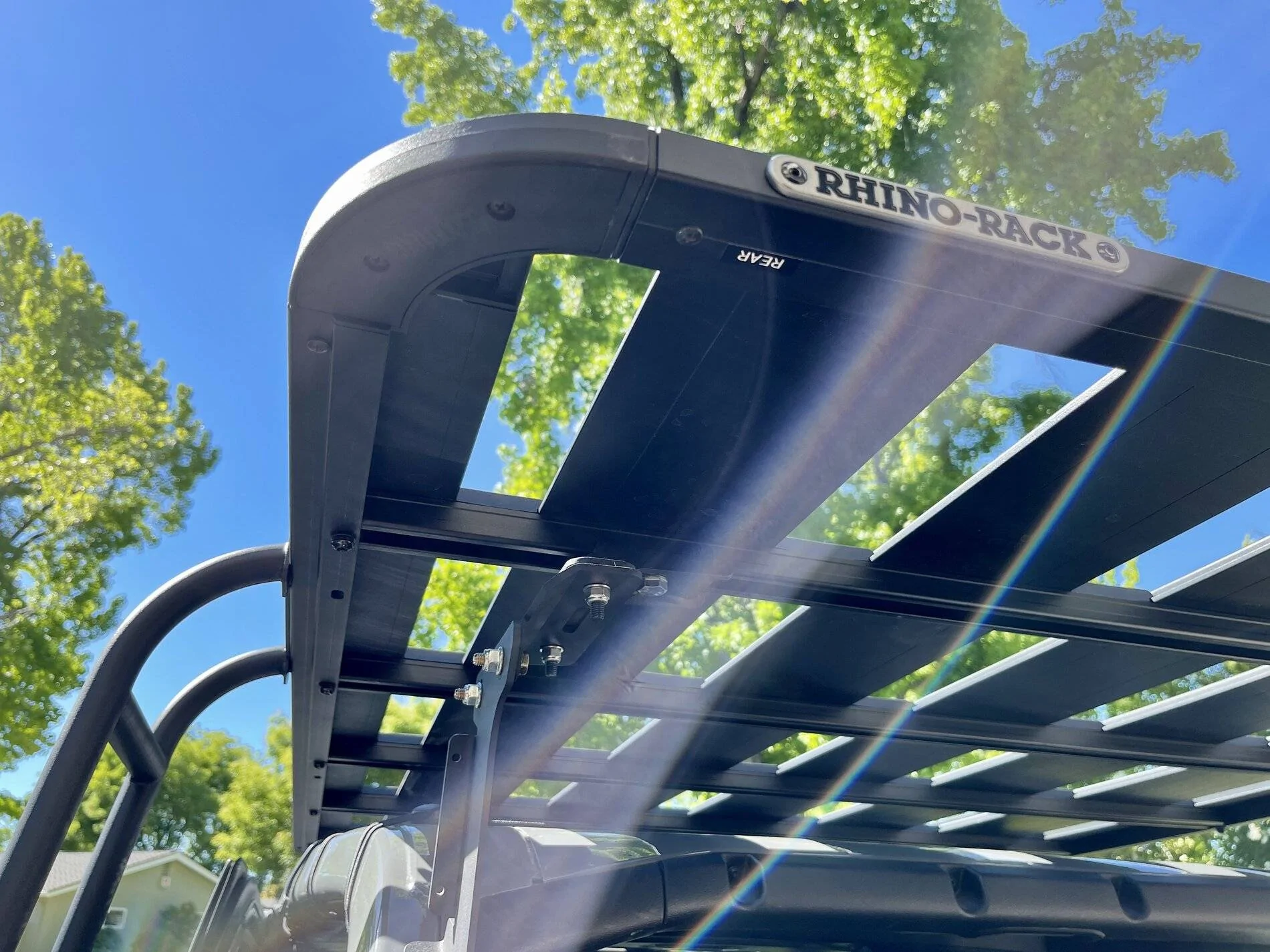

Silly question, but is the rack on the right way around? I have the Maximus 3 Pioneer Rack, so different mounts, but mine also sits further over the freedom panels. I remember the assembly instructions were pretty implicit on making sure the rack was facing the right way. I also remember reading that some people didn't have the stickers on the panels to denote front or rear.

I looked at my rack closely today, you definitely have the platform backwards. Spin it around and you'll be set.

Here’s where I’m confused. The back piece very clearly has “Rear” on a sticker on it.
This leads me to believe that I may have the side pieces flipped. If i switch the side pieces then the rear holes underneath where the crossbars mount will be closer to the backbone mount points and thus the rear won’t stick out as much. I could be wrong, but it’s my best guess right now.

Hi There! I confirmed that I had the rails backwards. There is very little labeling on them, but when you assemble the rack, make sure that the rear-facing part of the rack has a SMALL GAP between where the rack bolts to the backbone - and the back of the rack. The larger gap between where the rack bolts to the backbone and the front of the rack should face forward and protrude over the two roof panels that are removable.
