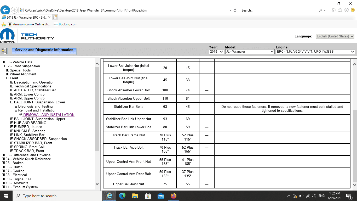

I listened to some of the sound bites from that thread. Sounds like the same issue. Any clue what the torque specs are for the ball joints?
You typically just want to advance the castle nut to the next hole and then reinsert the cotter pin. As the ball joint wears normally you'll start to hear it again later on, this is normal behavior for the most part though - once your ball joints are worn and ultimately need replacing I would go with an upgraded set. The stock ones have plastic internals.
Second number is Ft Lbs

That's exactly what it was. I advanced the castellated nut two holes and reinstalled the cotter pin. It is an issue no more! Thanks all for the help!
