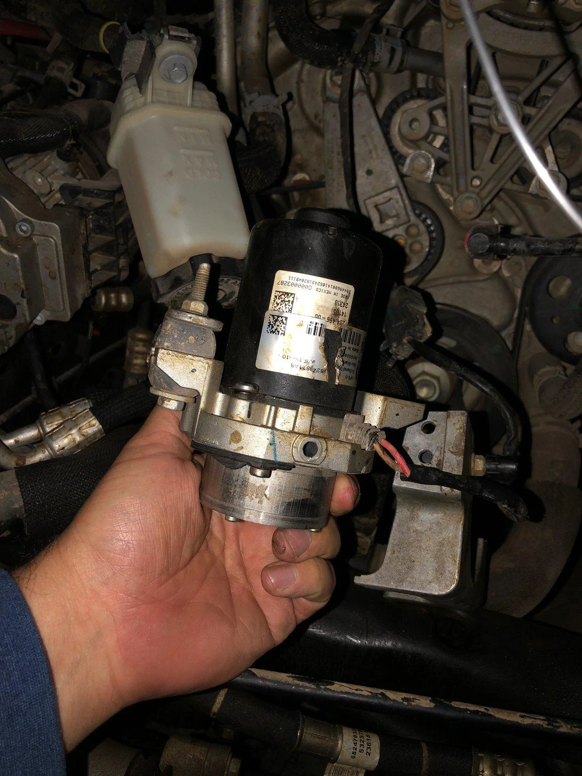

Hi,
I got my first jeep through Copart a few weeks and just started tearing into it this weekend pulling off the broken and bent stuff and came across this little guy and I can't seem identify what it is, any ideas? Also is there a good parts catalogue or repair manual that folks would recommend? Many thanks.
Jeep Wrangler JL What is this? IMG_6251

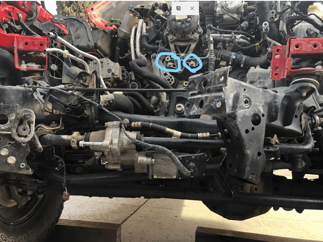

It mounts here where the blue circles are. The mount broke during the collision.
I think @MarkY3130 is right. It looks like the vacuum pump. Part # 68338787AB is partially visible.
Jeep Wrangler JL What is this? upload_2019-12-22_7-45-38
