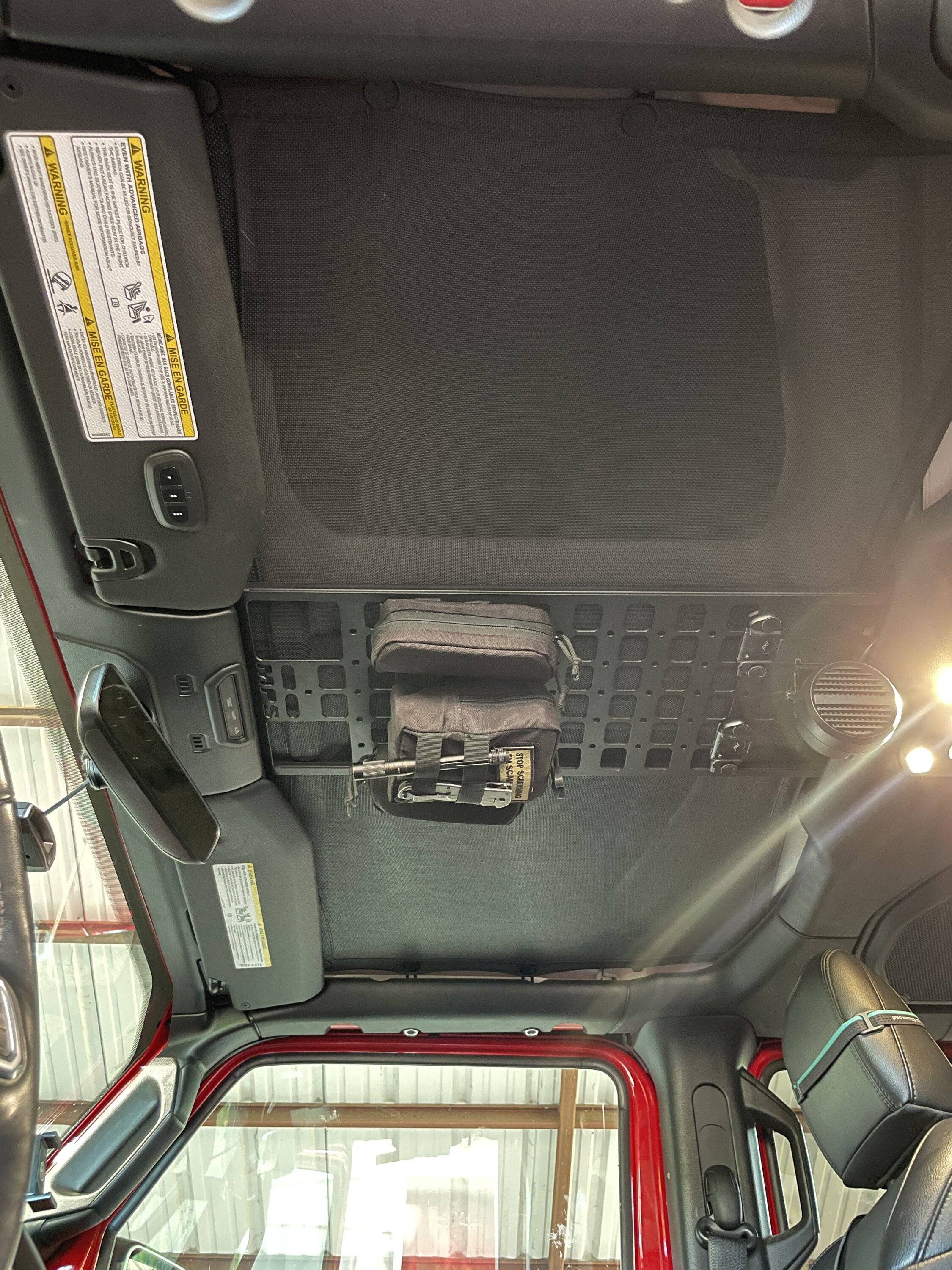

I’ve got the headliner and a black sun shade and I can’t see it anymore, the cabin is quieter/cooler, and I’ve got a sun shade when the top is off
win/win/win
Pic at extreme angle will show the small transparency, but for the most part it goes away and just looks black

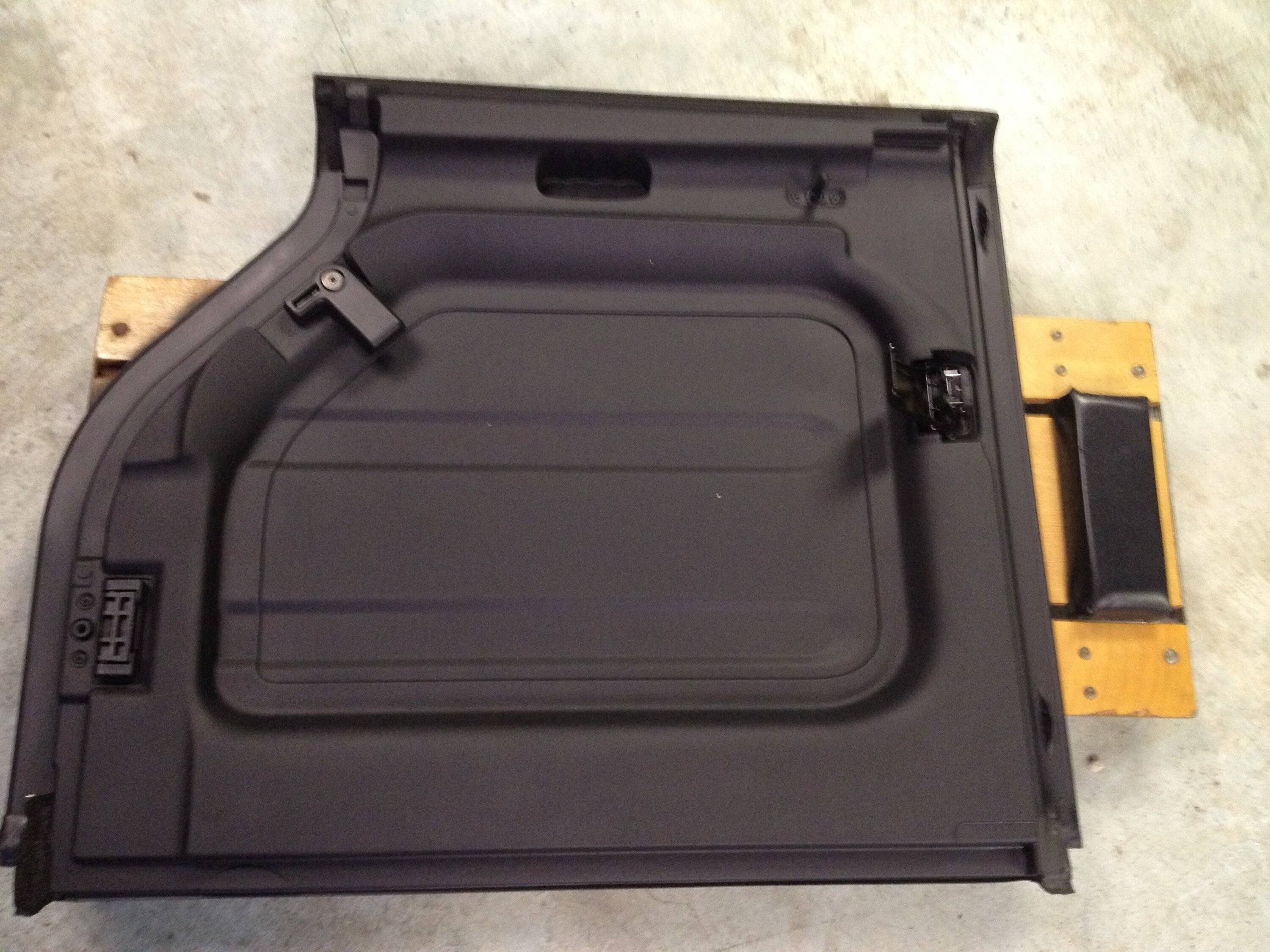

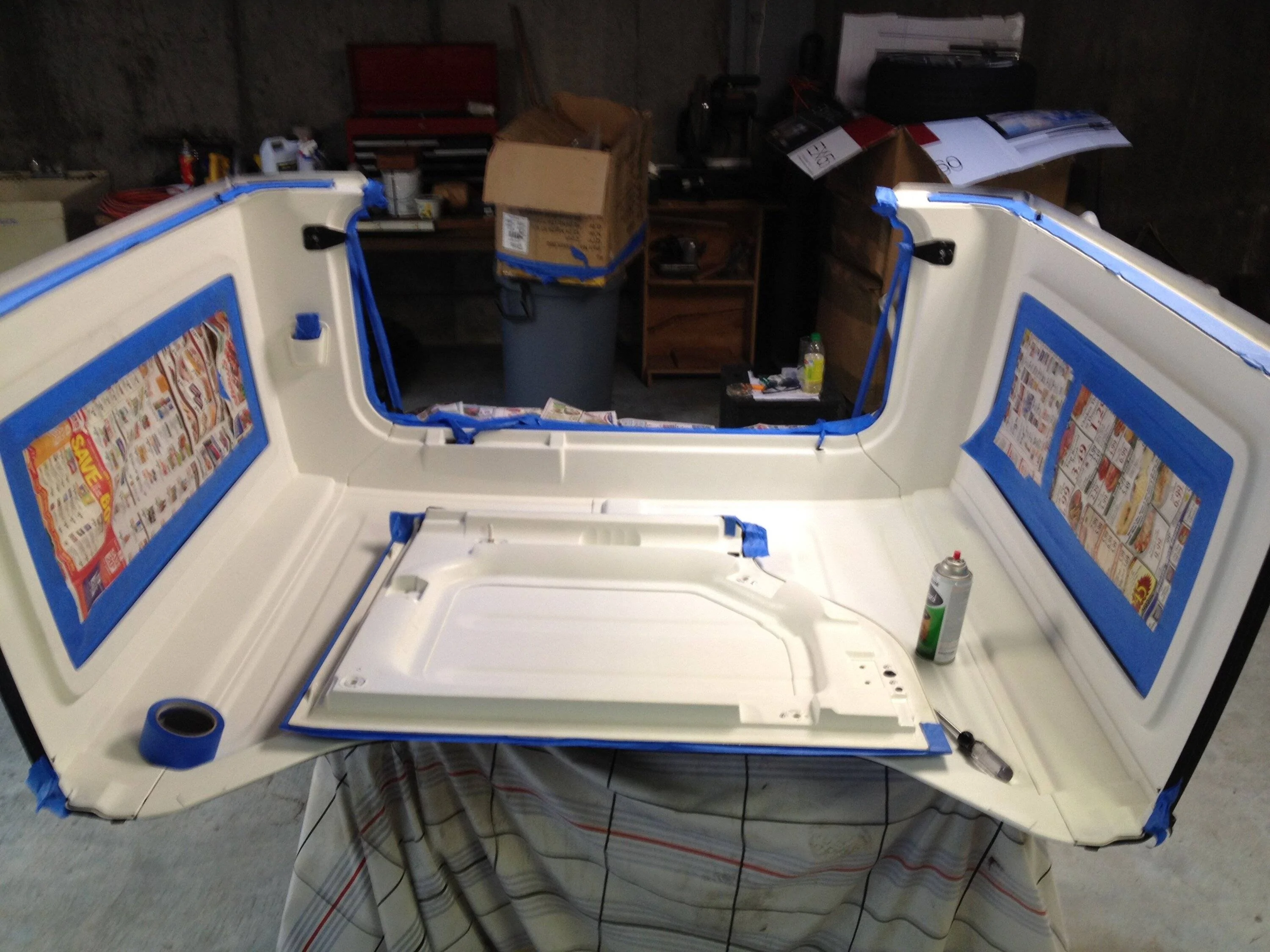

I did my JK and added the hotheads, pretty easy. Tape off and clean with alcohol to get any oils off and dirt then remove the hardware and spray. I used black chalckboard (rustoleum I believe)which gave it a flat look which I loved. Have not done the JL yet but will when I have a minute or two...
