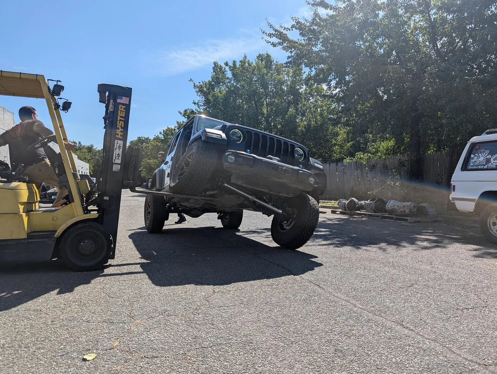

I do plan on an at home flex test/suspension CTI using some ramps, blocks, and jacks. How will I know if the shocks are at their full compression or extention? They are Fox Adventure Series 2.0. I did find this measurements online, like 15.xx" compressed and 28.xx" extended.
What was your terrible CTI score?
when it’s on the ramp you should ask their pro what is limiting your flex. My RC diff armor was hitting my skid plates, my sway bar links were too short..
It was 680. I had a line of people behind me and didn't want to bother holding anyone up. I suppose I should have.

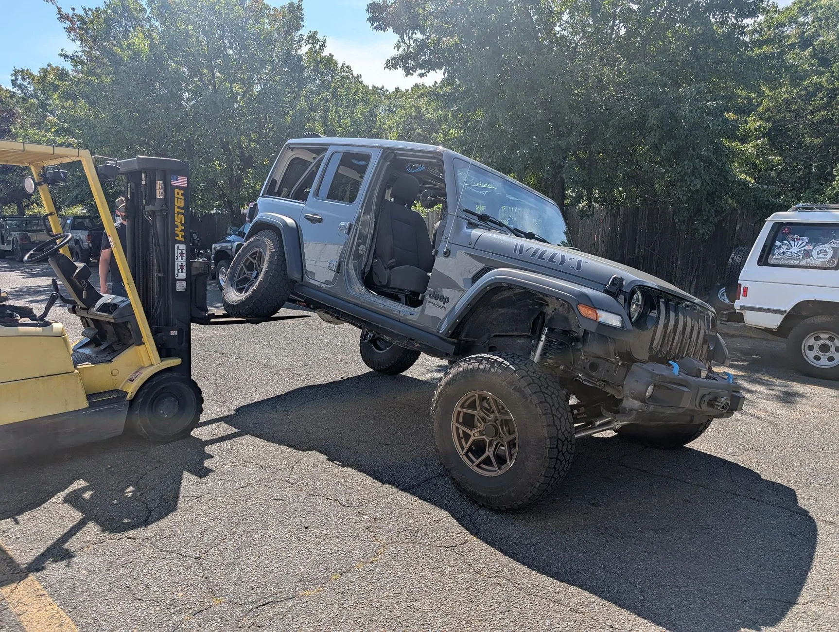

Afterwards I did have a local 4x4 shop put it on a forklift. He said 'honestly I would leave it as is. It's extremely capable now and Toyota guys would kill for this flex. You could spend a ton more money and get to the point of diminishing returns. Is it doing what you want it to?'
When you flex it out next time measure the shocks eye to eye and see if you’re at the measurement they call out… if you’re not getting to 28.xx and 15.xx then there’s something else limiting your flex, and it could be the oem control arms, or a few other things. But if you are at or really close to the numbers then that’s all you’ll get unless you run longer shocks. If the shock says it’s 28.xx ext and you’re at 28 measured then adding control arms isn’t going to help you….….
From looking at your pics, you look like it’s flexing pretty good, it really depends on how deep into it you want to go, and how you want to spend your money on it….
