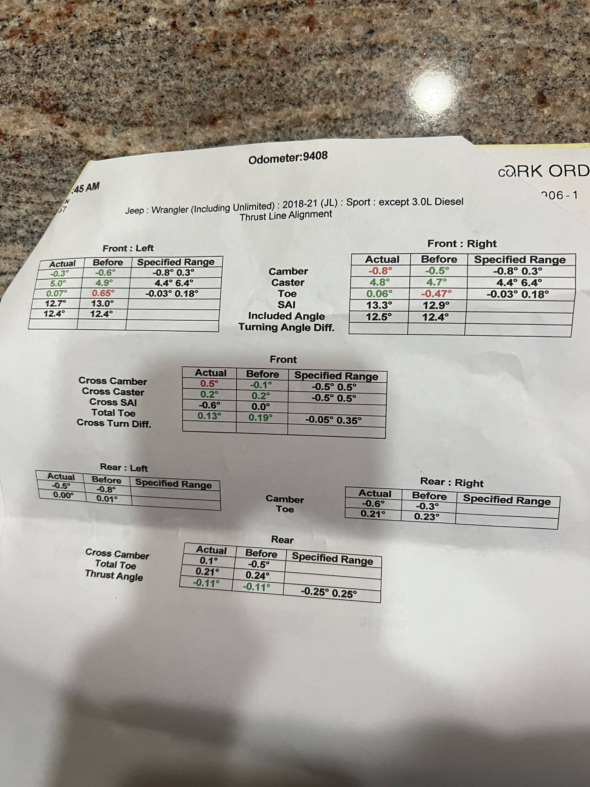

Help .. I got adjustable control arms install with Johnny joints . The ride a little loose on the steering … what should I do ?? Can someone look at my data and see if something can be improved on??
When I go over 70 mph on the freeway the steering feel loose . Not as tight as it was .. everything still bearable .. but just want to see what I should do next .. if it can improve .

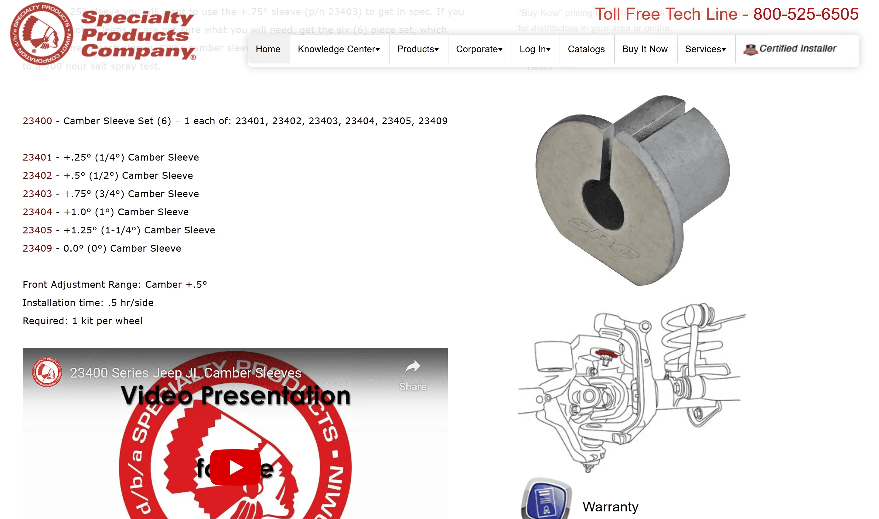

Install +.5 degree camber sleeve on Right Front and increase caster both sides.
Thanks for the info .. that does look interesting .. if I get the sleeves installed .. mind as well upgrade the ball joints at the same time too… kill 2 birds with one stone .

Yup caster is to low. Get it to around 6ish. Should feel way better.
