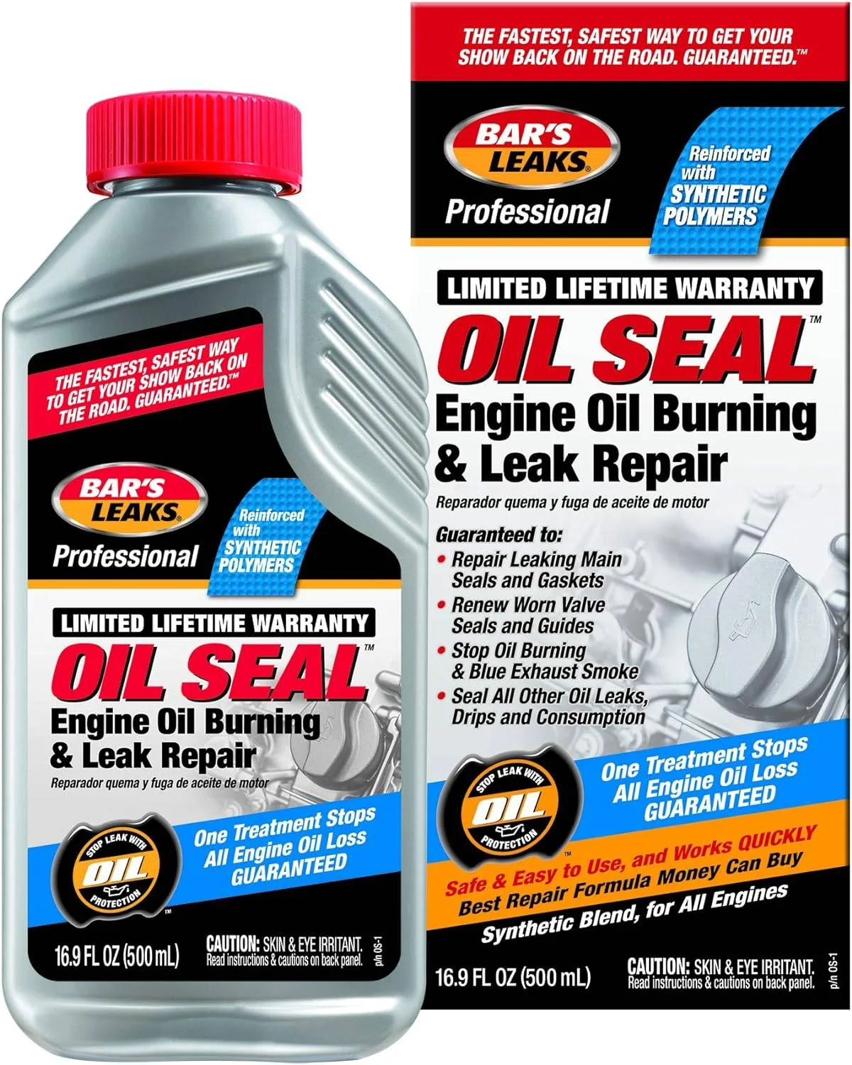

Linda, you may want to try this if this is not a good time for you to otherwise get it fixed.
I have been using this since the 1960s on our ranch truck, Tractors and it does work.
One of our ranch trucks was a 59 Chevy. V 8 and it blew a head gasket. I put this in and it fixed it and when we sold the ranch truck about 8 years later it still working and it never failed.
Bar's Leaks has been around since 1947...
https://www.amazon.com/Bars-Leaks-O...28a194305187c2c94e77a99c41&tag=hyprod-20&th=1
Jeep Wrangler JL Help! Coolant bottle empty again! 81wHGFYridL._AC_SL1500_
