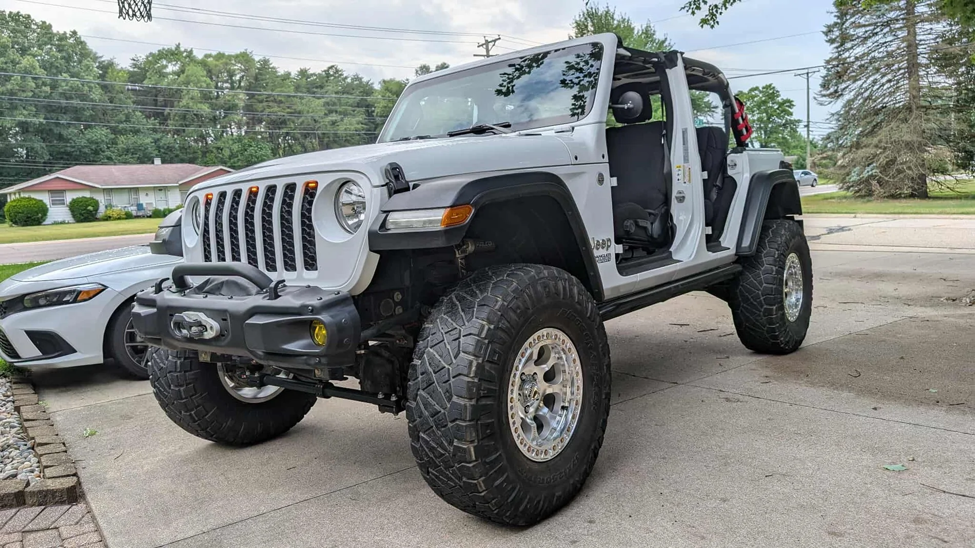

I have wanted to try Nitto Trail Grapplers since they came out. In 2023 we bought a Gladiator Mojave that the dealership had put a Mopar lift and 285/75R17 Trail Grapplers on. At 23,000 miles I just replaced them. My set of Trail Grappler tires were the shit, and not in a good way. Here is what they looked like at 23,000 miles. Alignment was verified and was correct. They were rebalanced and ran smooth with no bounce.
These tires were much louder on road than others we have recently used (Toyo MT, Cooper STT Pro), and they wore out a lot faster. I read a lot of reviews on Nitto's website because it seemed like my experience with these tires was not the norm. It turns out that about 4 reviews were positive and then one horrible review, and so on, over hundreds of reviews. When ordering new tires I talked to one of the managers at the local Les Schwab dealer I buy tires from. He is very much into off-roading, as are many of the other employees there. He has a Toyota Land Cruiser with 38s, and even the super cute female receptionist has a 2-door JK with a Metalcloak long arm suspension with 37s. The manager had noticed the same inconsistencies with Nitto tires, so he started keeping track of the plant they were manufactured in. Apparently, there are two plants in the USA and one plant in Mexico that make Nitto tires for North America. He noted the bad tires came from the Mexico plant, which is where mine were made. I have absolutely no way of verifying this, it is just what he told me.
I've always had good luck with Toyo MT tires, and just six months ago put a set of 40s on my JLUR. But for our Gladiator Mojave that needed new tires I went with Toyo Open Country RT Trail tires. Check them out, they got my vote.

Mine 37" RGs have had over 40,000 miles and still have around 13/32 left (I do 5 tire rotation). This past weekend I mounted them on some beadlock wheels and they are still smooth without any balance weights.
This is my second set of Nitto RG. First was 285/75R17. I have been please with them and my next set will be 38x12.50.. Only complaint is that the cost of gaining one extra inch is way too high.
