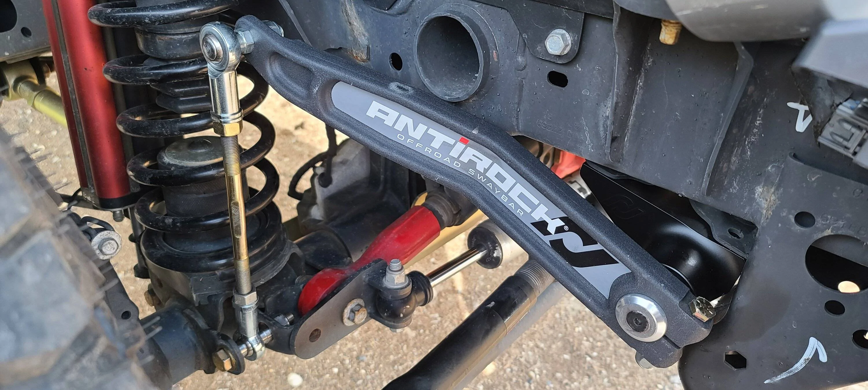

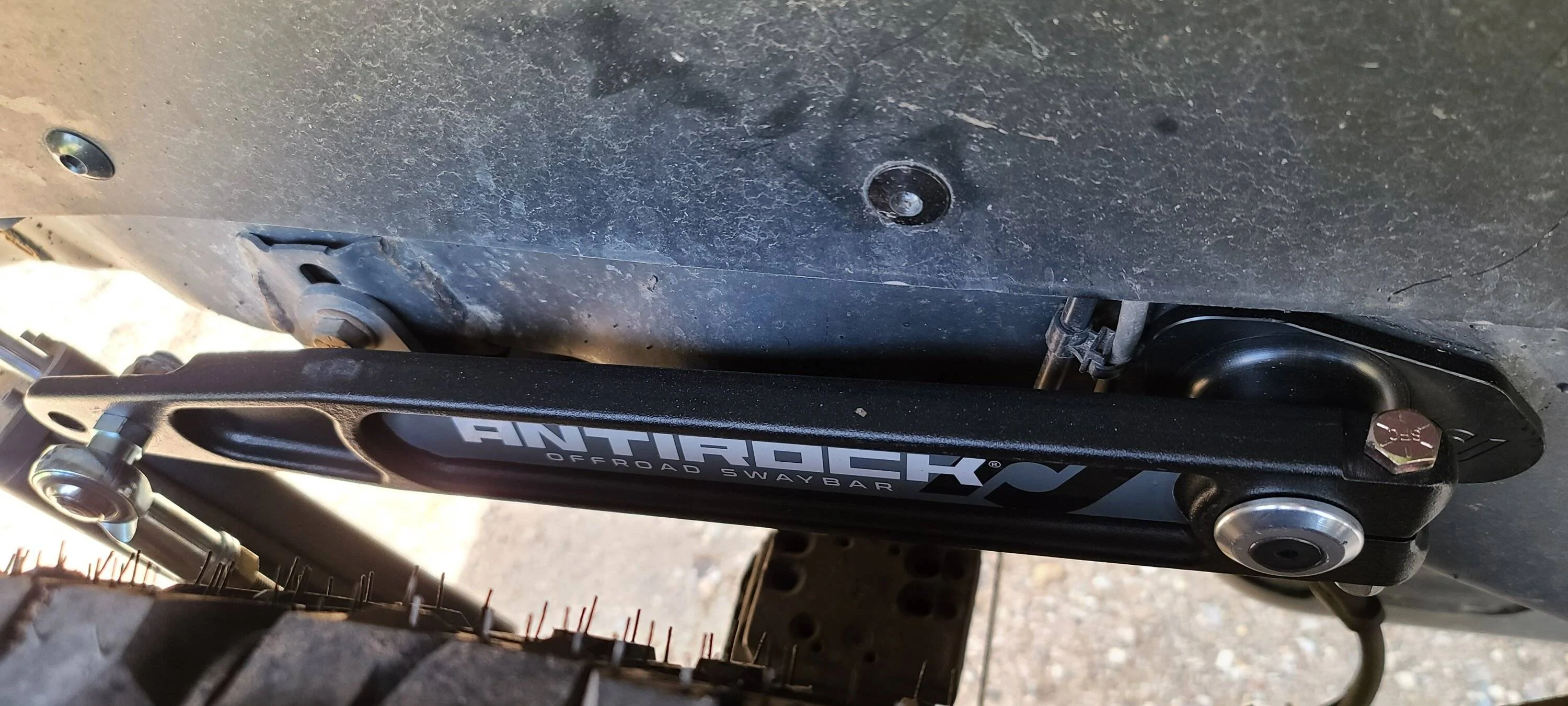

Same here. I started with the SteerSmarts ones back before I knew what I was doing. Once I got my knowledge built up and realized that they were countering my goals, I swapped them out for the No Limits links. Now I'm using the front and rear Antirocks, which also utilize heim joints because they always remain connected regardless of on or off road.

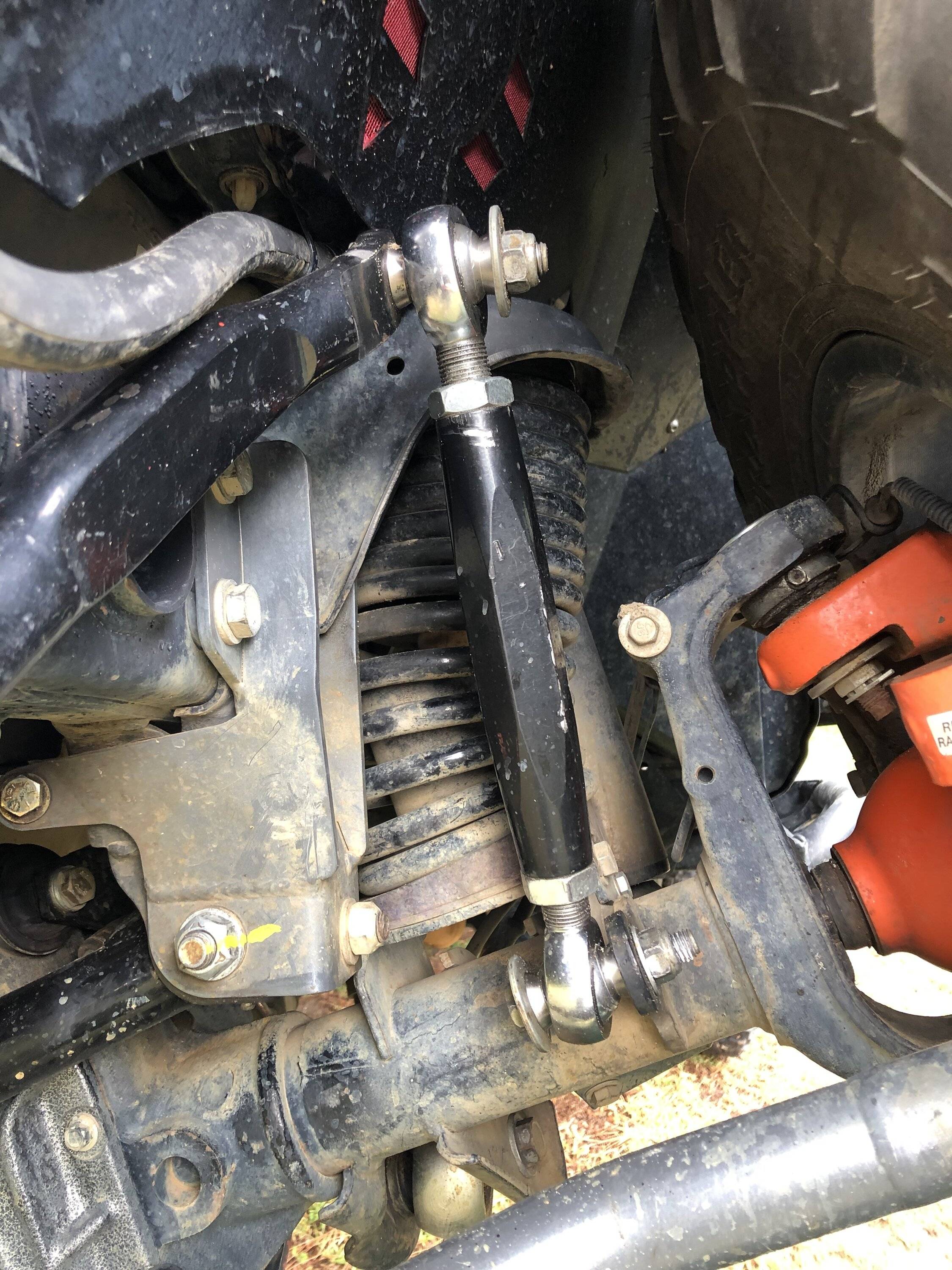

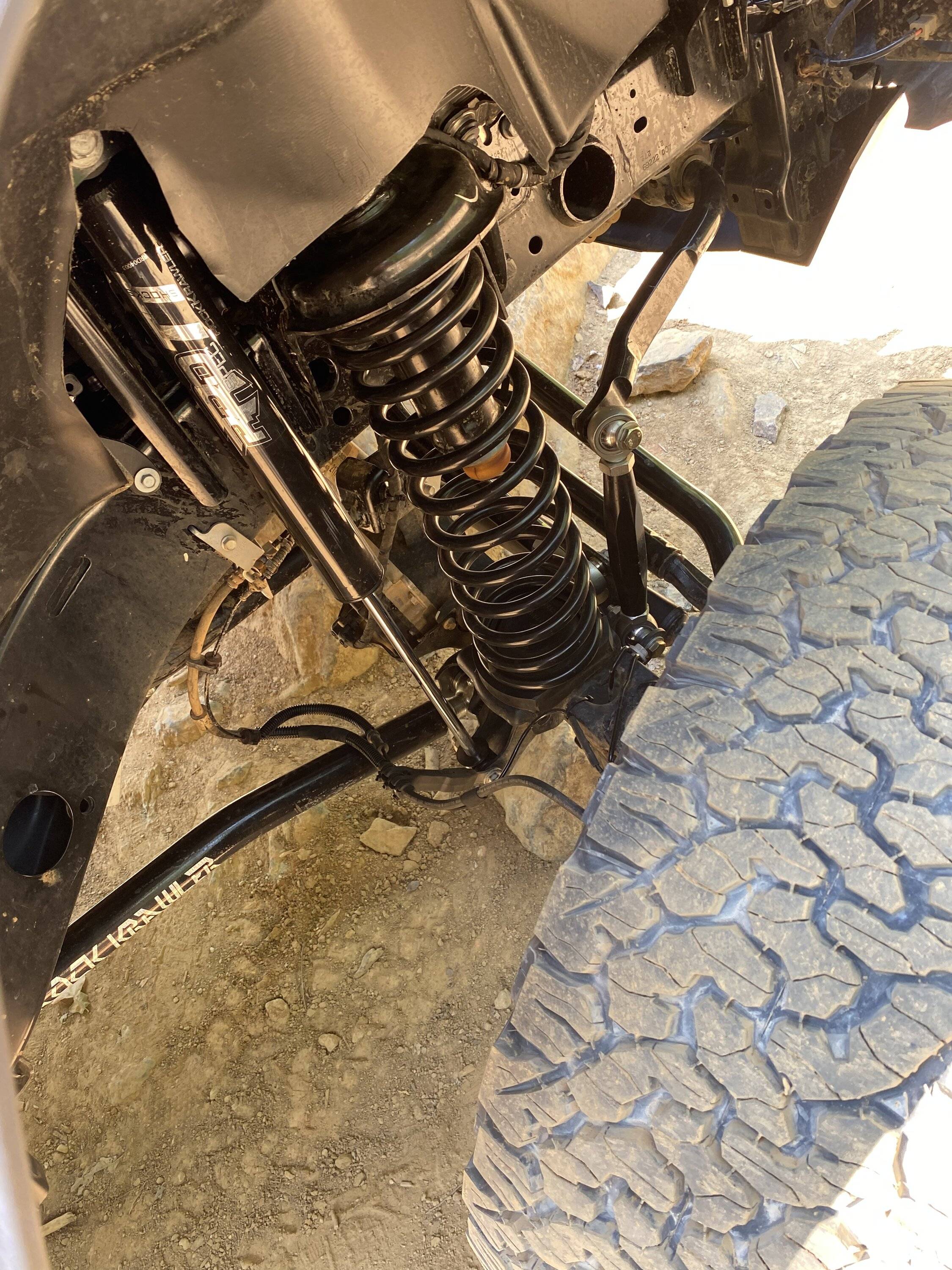

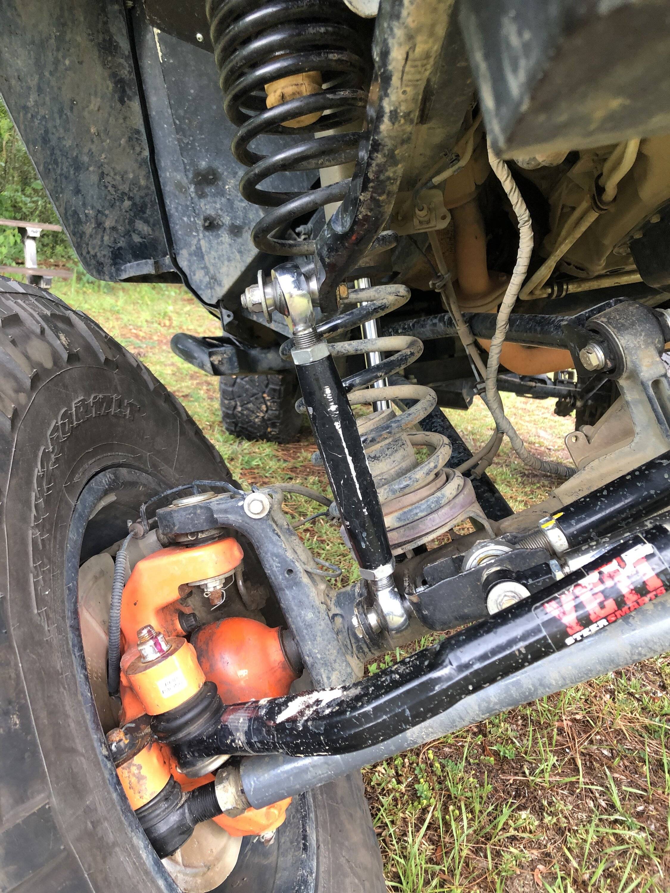

When a Jeep is built up to have more articulation than stock or mopar, and the front sway bar links are not being physically disconnected, heim joints are a necessity. They provide the amount of misalignment that won't limit total suspension travel, which a conventional end link can't.
The Rubicons edisconnect was designed with ease and convenience in mind, but it's very design is what limits articulation when paired with flexible lifts like Metalcloak and Rock Krawler. Hence the No Limits links pictured above. They were specifically designed to be used with the Rubicons edisconnect and not impede total suspension travel.
Personally, I wouldn't be so quick to discount the No Limits links. They serve a great purpose with the more serious setups.

I would love to know at what shock length exactly the claimed bind occurs limiting further droop. In addition how much additional "droop" these allow past that point. Does anyone have any measurements ?
In fairness Rock Krawlers own promotional video calls them ridiculous.
Not all links bind and restrict droop, MC for instance will droop out.. the main problem is the bushings wear out quick if you wheel as often as we do… my buddy has already trashed his MC bushings in less than a year.
He now runs no limits…
The no limits aren’t for everyone, and to be honest, if you’re not drooping 29” and up these won’t be as big of a benefit…….
I just wanted to post pic of how much misalignment goes on at 31” ext length shocks……..

Don't worry, that was last weekend and there's another one coming very soon. What you really want are front and rear Antirocks. Not only would you never have to worry about hitting that pesky button all the time, but think of all the tablespoons of fuel that could be saved by being able to delete the sway bar edisconnect motor and its skid plate.
Plus, zero ridiculousness...

Yeah, I had an AR on my TJ. It worked well. I would consider a set for the JL but I am REALLY pleased with the on and off road performance / handling now so Im not super motivated to make that upgrade.
