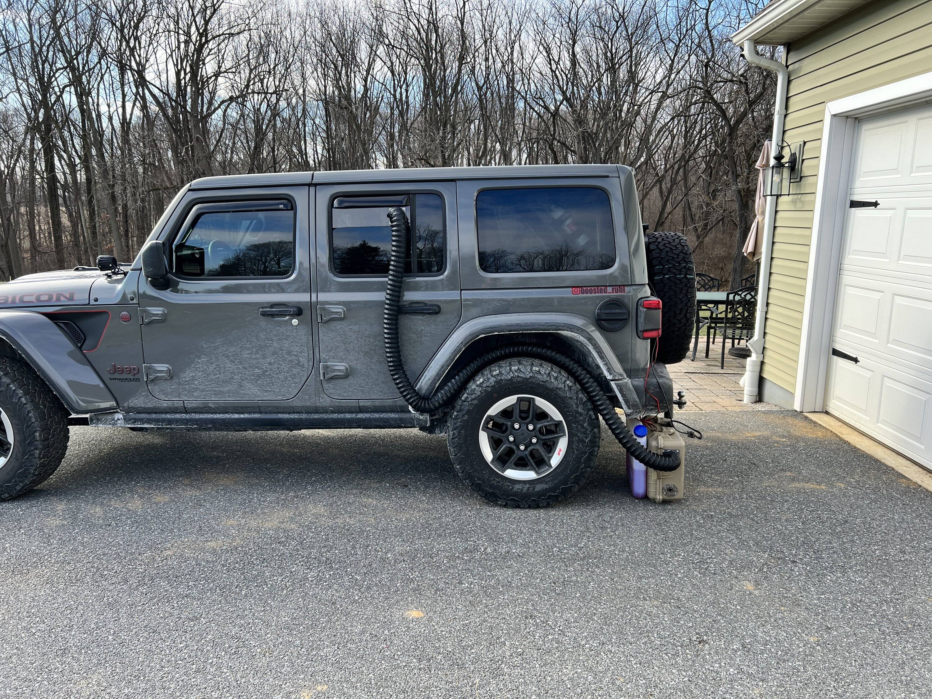

What’s your budget?
A battery/solar generator and a heated blanket work pretty well.
More complicated but maybe cheaper is diesel heater?
