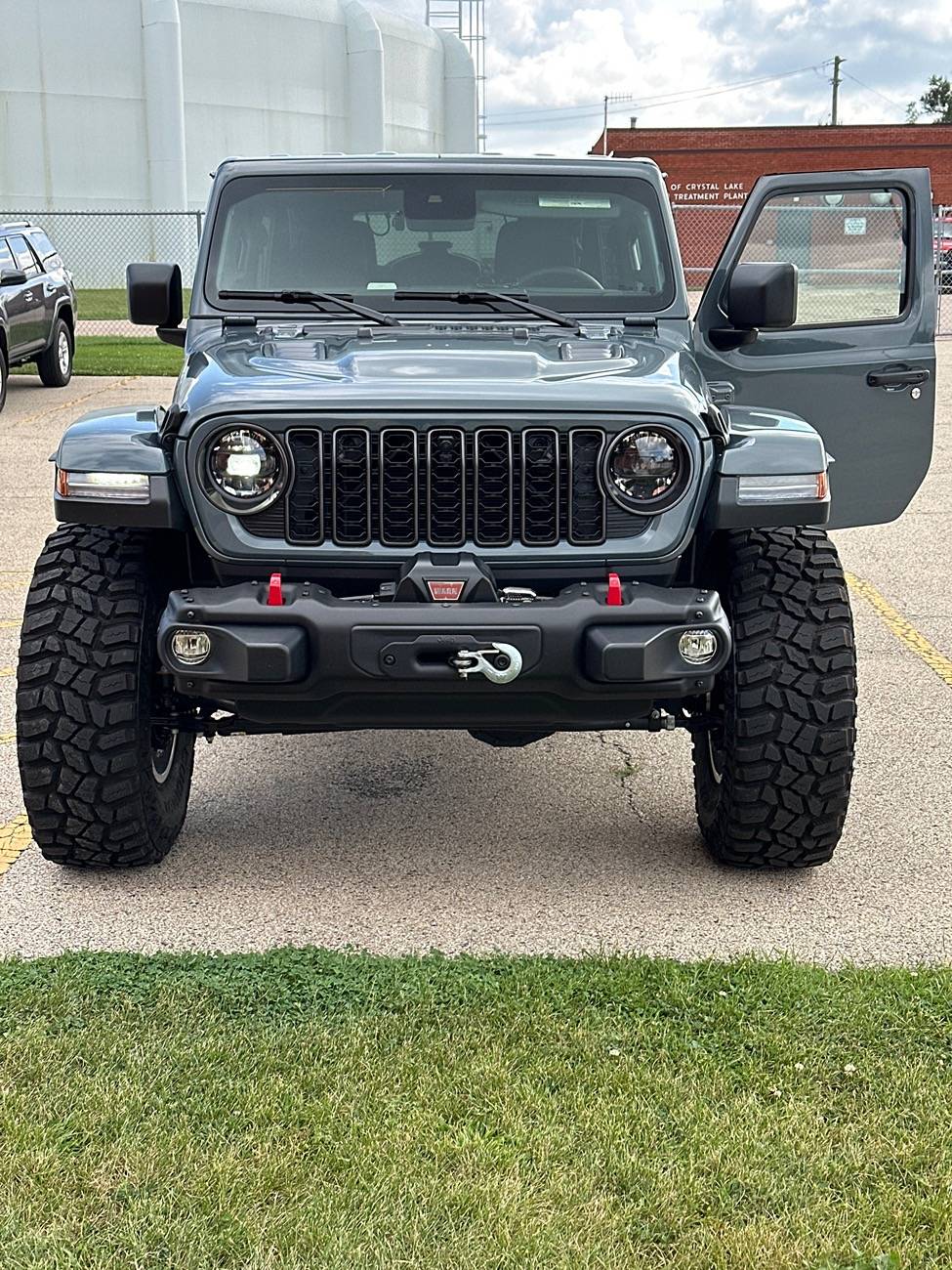

Same thing just happened to me. 2024. Will try to get in tomorrow as it is my daily.
Jeep Wrangler JL Headlight failure issue IMG_6505
