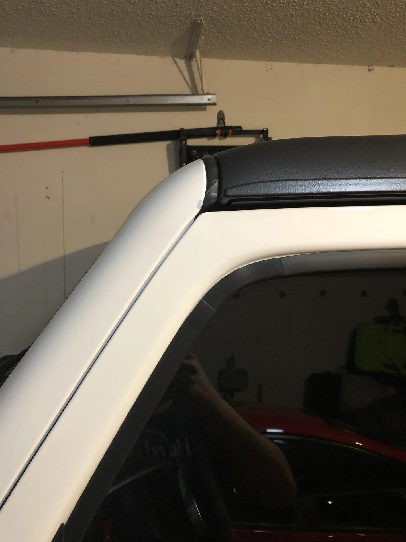

Here are two pics I just snapped. Similar to yours and I have no wind noise, whistling, whirring, open window sounds.
MoM, would you mind taking a pic of the windshield gap (the seal on the side) on your JL ? If you are reporting no wind noise, I am interested in seeing if your gap is even top to bottom or not. thx
This?

It is the frame of the windshield and it has a gap from the body frame where the grab handle is. The gap continues up towards the top of the removable tops. I assure you that yours is the same. Look closer at @NYJEEPGIRL pic, hers is the same, mine is at a slightly inward angle with more light penetrating through.

yes thanks. perhaps the whole seam ? it appears that yours is even top to bottom. that supports the theory that adjusting the windshield so the gap is even helps with the noise. mine is smooshed at the top and wide at the bottom and I have noticeable wind noise.
Hopefully, there's your problem. Question is, can it be adjusted?
