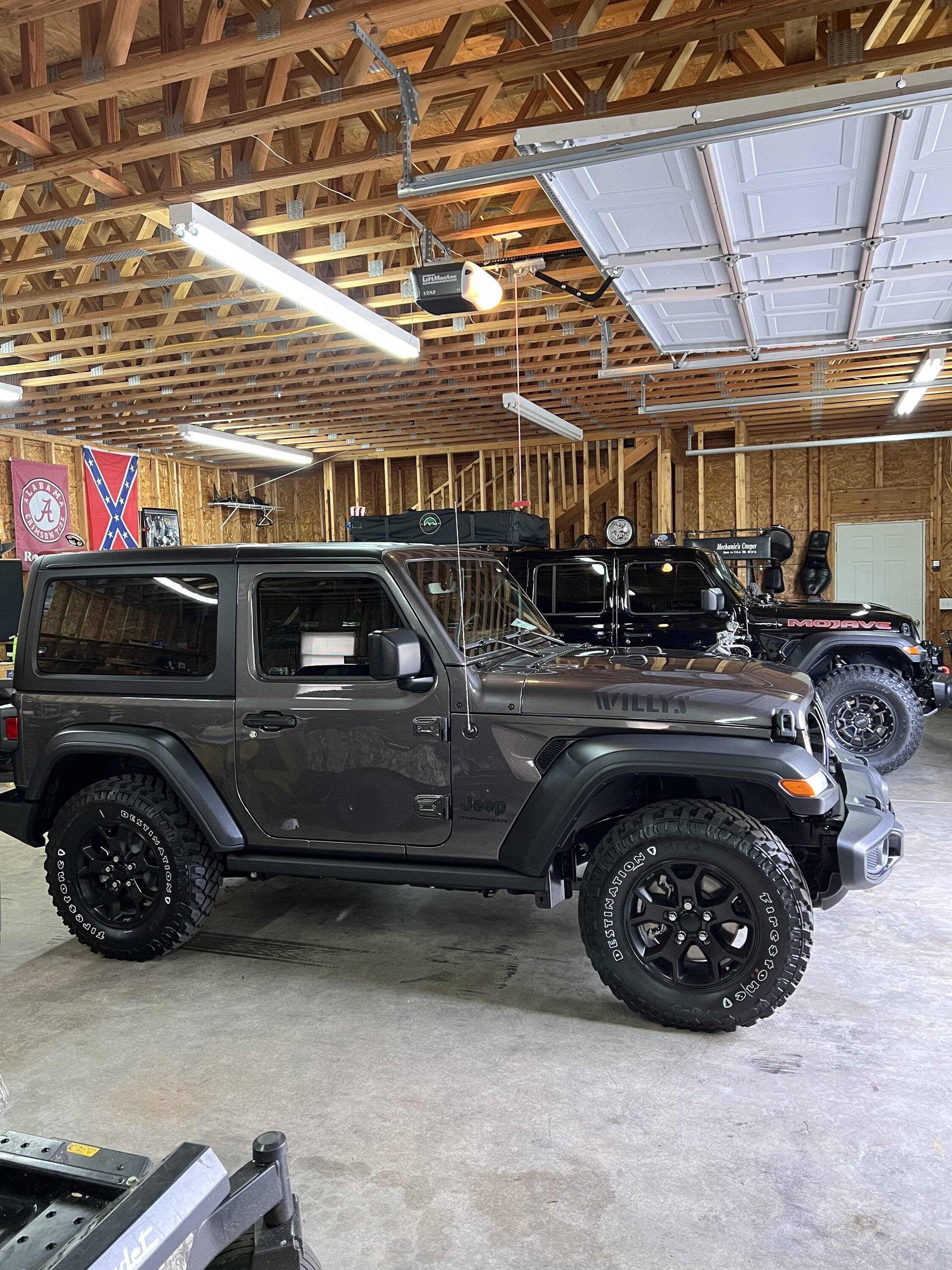

Just got my wife a 2023 2door Willys, i have a gladiator and when im using handsfree calling , it sounds good on the persons end Im talking to. . My wifes Willys sounds like the top is off . Horrible noise . Its a hard top too.. is this an issue for the dealer or just something she will have to deal with. Oh and both our jeeps are 8.4 uconnect. Thanks This is her Willys
