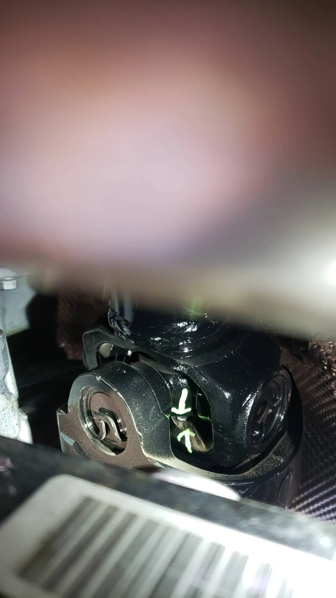

Had to remove my Next Venture Motorsports transfer case skid plate. Then the only way I was able to get to the flat grease zerk was to disconnect the driveshaft at the front differential and lift it up as high as possible and tie it to the motor mount. This allows enough space between the u-joints to get to the flat grease zerk fitting. I sure wish Teraflex made a Rzeppa driveshaft for the JL.
