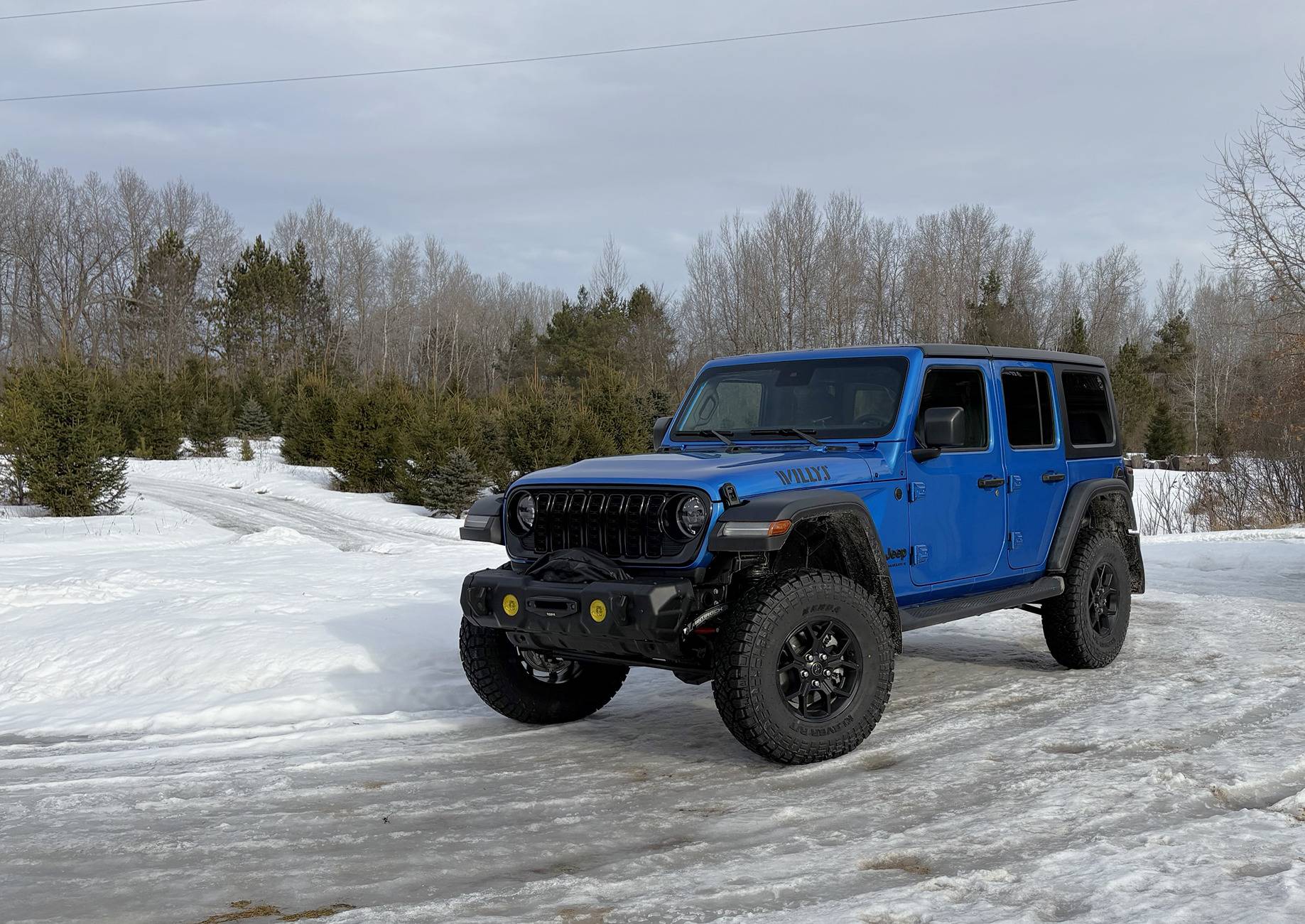

The advice given by @JLUR Farout makes good sense. The 35x10.5 tires on the Willy seen in the photo below do pretty good with the psi set to 28, it will warm and top out at 32 running down the highway. The 2.5" coil lift is about equal to your XR for access height. I am geriatric in age and easily get in and out at current stature of 5-9", used to be 5-11" lol. We are on a dirt road so I add splash guards to my Jeeps. Splash guards and side steps for the win!
