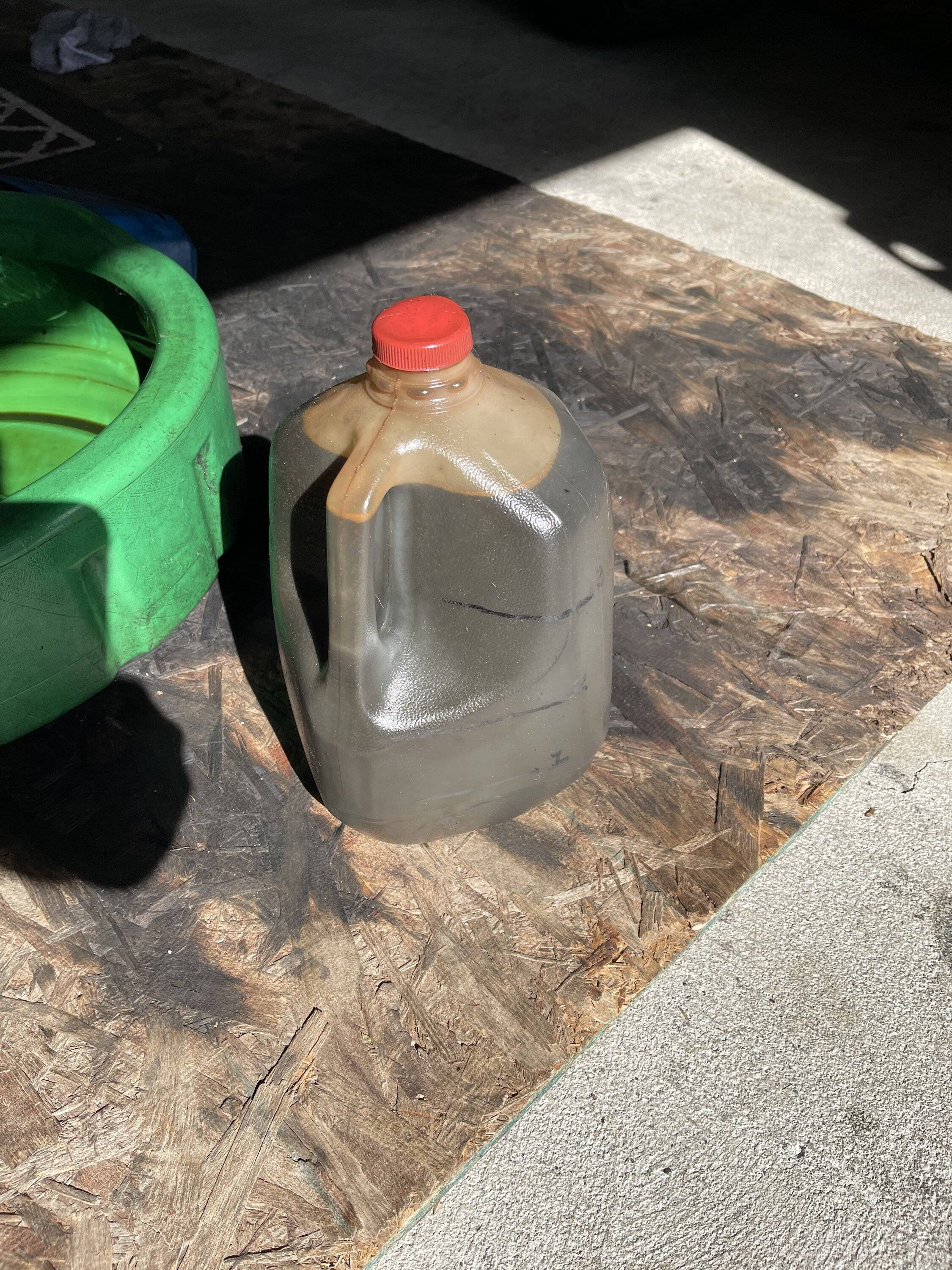

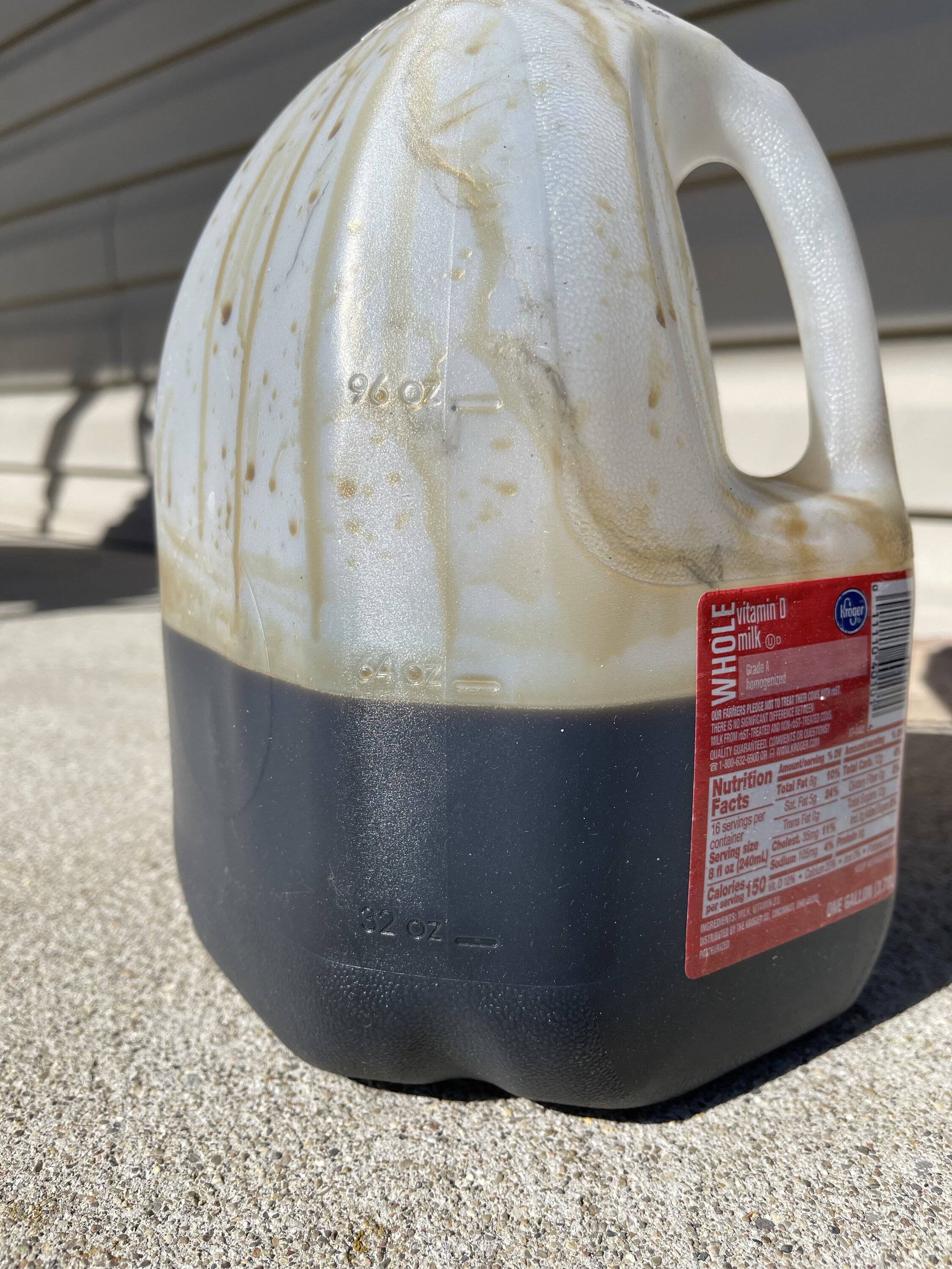

That’s exactly what Willys had in it when I bought it used from a FoMoCo dealership in Circleville, OH.....
Jeep Wrangler JL Go by dipstick or manual? 4CCCE711-F601-4BF4-AE78-5E2D5320D864
Jeep Wrangler JL Go by dipstick or manual? 563EBD58-D4A4-4B8A-8124-066C7E50258B
Oil changes on a 3.6L Wrangler are so easy that even a FoMoCo dealership can screw the pooch on’em........
Thats the tech not the dealership per sea....
