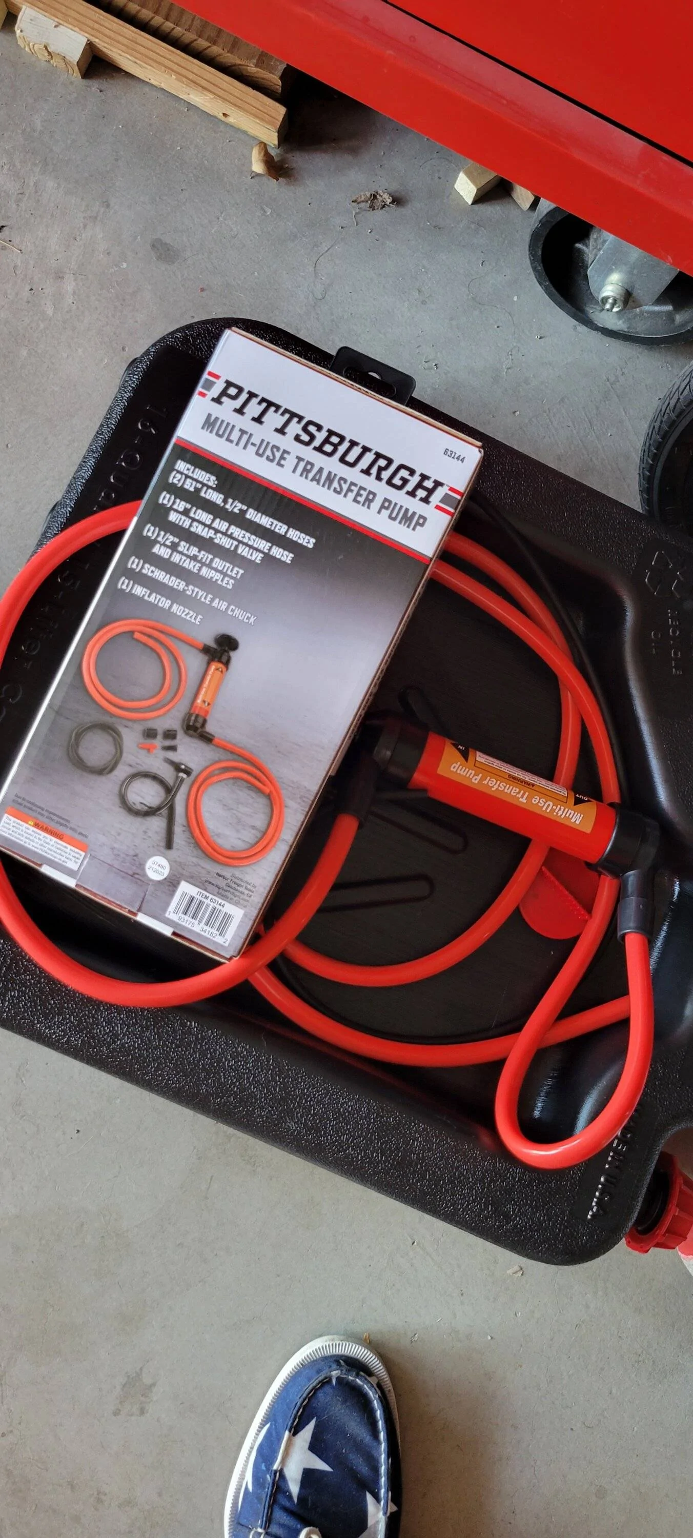

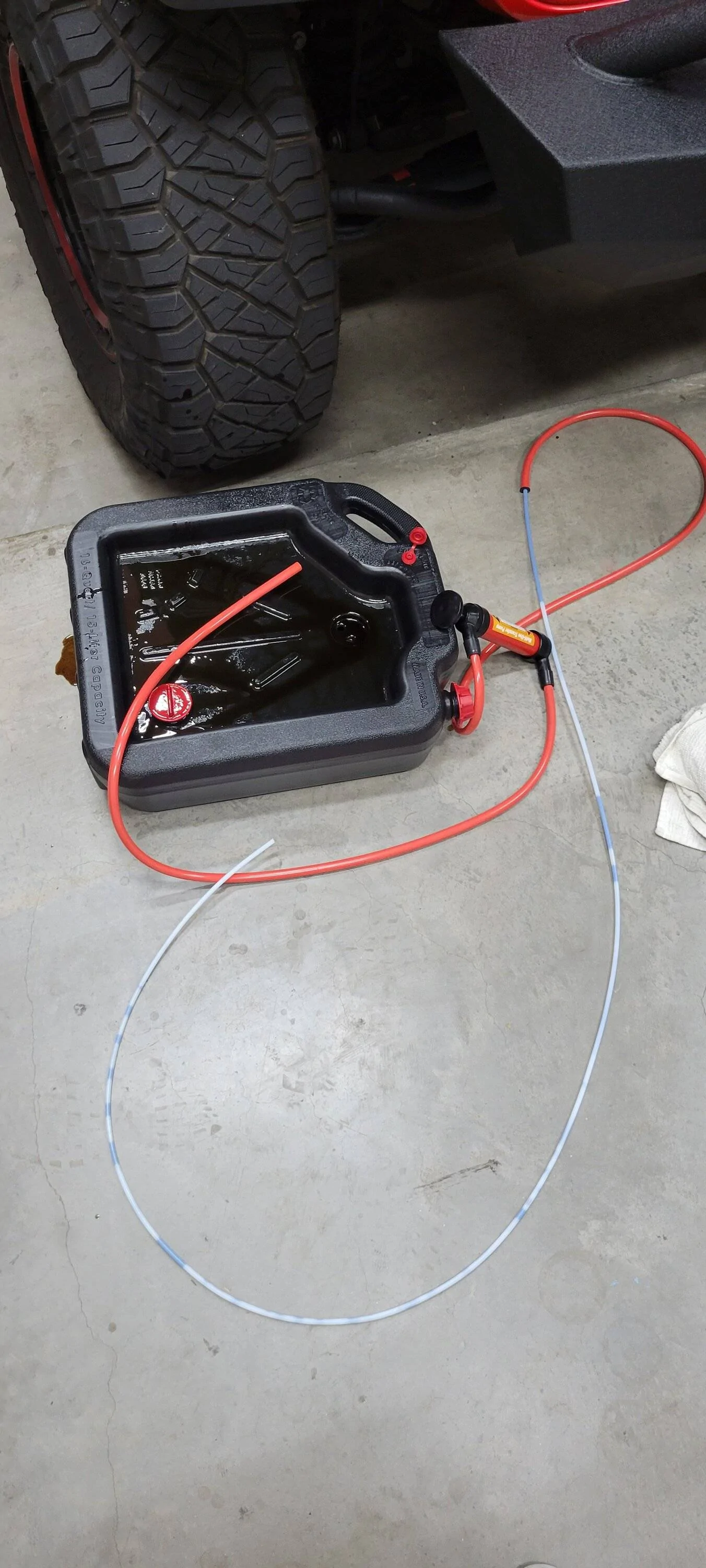

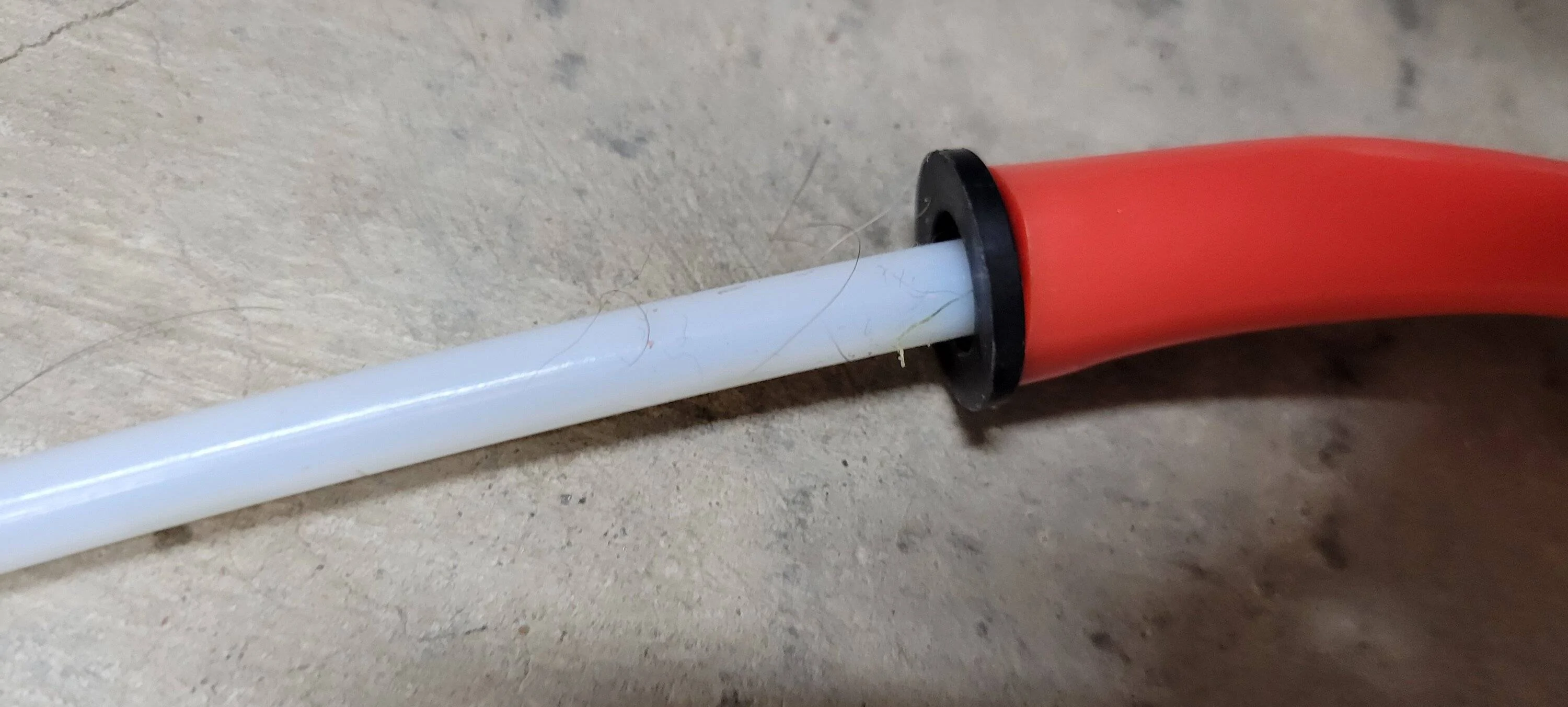

Dealership overfilled my wife's last week and I got this 5 dollar hamd pump from Harbor Frieght to take a quart out. It was all the way up to the bend in the stick 2inches ish above top hole,max line. Warning that this pump won't work with supplied dipstick tube...it's too flimsy like a tube of heat shrink so I got this 1/4 thick walled poly tubing to shove down the dipstick hole deep enough into the sump to pump out.
