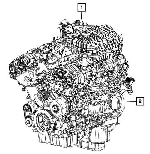

2018 JLUR 3.6L ESS without e-torque. 82k miles, mostly highway. Extended warranty just approved replacing my entire engine due to a warping issue - Part # 68423711AA. I know there are some carryover parts (valve covers, oil pan, etc.), so my question is should I have them install anything new instead of carrying it over? I understand it's not necessary for everything to be brand new, but figured while they already have it apart, should I just have them install other new parts as preventative maintenance?
I know any new swaps will be out of my pocket, but with the vast majority of the engine swap cost being covered by the warranty company, I don't mind spending some of my own coin to get the best start possible with a brand new engine.
Also, I'm open to any new break-in tips/advice. Thanks!

More than likely the dealer will get a fully assembled engine with everything on it already.

I'm guessing you'll be getting an entire engine assembly with everything including the serpentine belt driven accessories. It'll be a drop in a plug up install aside from a few minor pieces.

Thanks for the replies. It's not clear what all is included with the new engine. I did ask my service advisor for a copy of the parts order as well as what will need to be carried over. Will see what he says. If you look at the parts picture it appears all belt driven accessories and covers are included, but then there's a description note that says some of the covers and other parts are not included...
