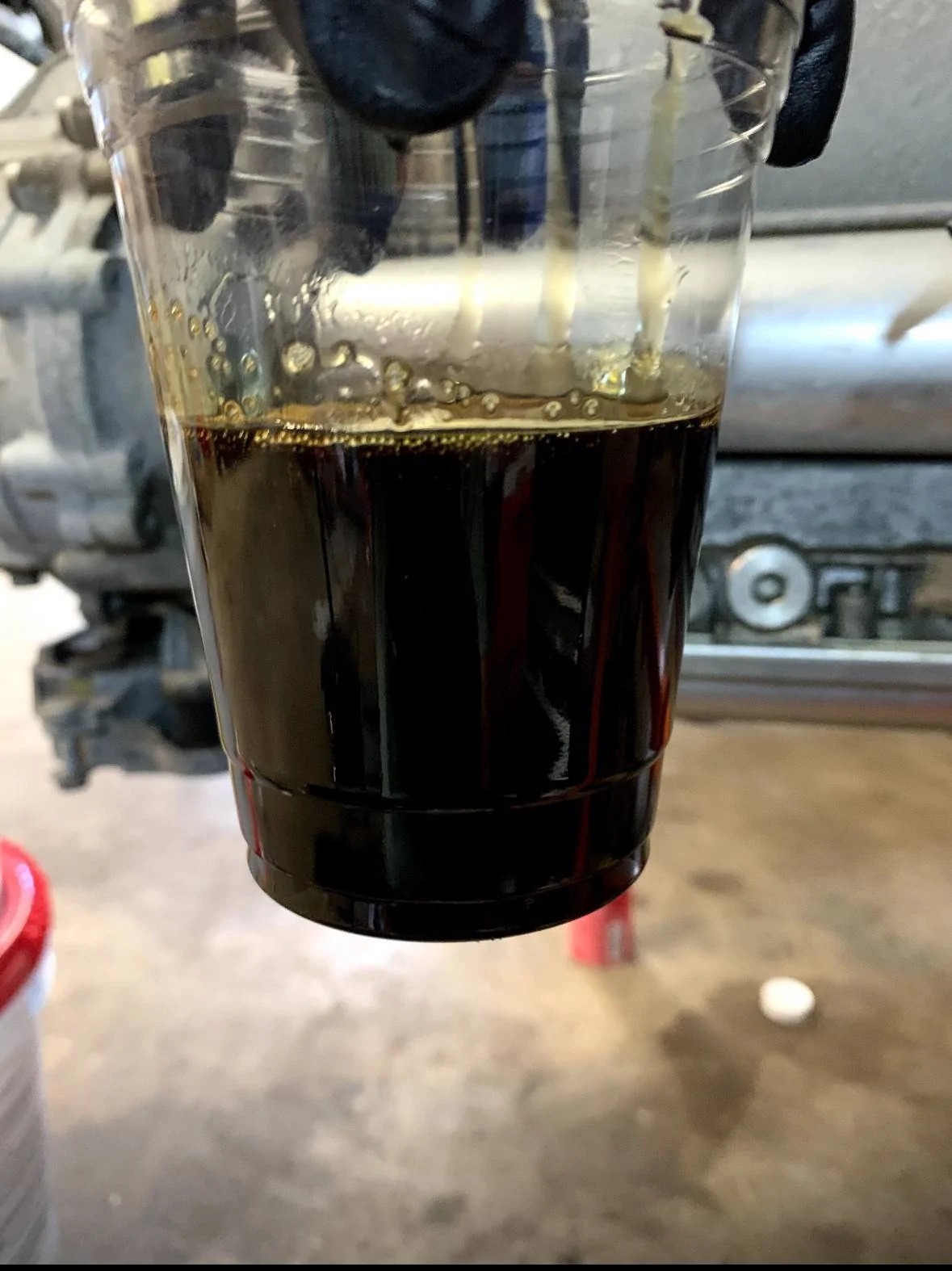

2 summers ago I changed the differential oil in our Audi at 204,000 miles, see pic below. It was dark but flowed and smelled like new oil. Differential oil lasts a very long time provided you can keep water out of it.
Jeep Wrangler JL Gear oil change now, or wait? IMG_9245

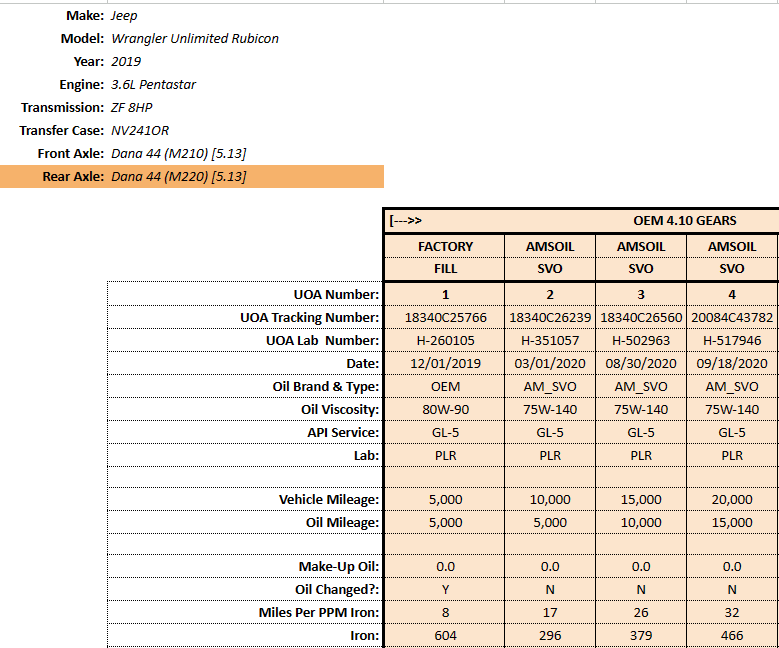

I would wait--the axles will not be broken in at that point and will still be producing plenty of wear metals. While it will not hurt to change it now, just know that it will require another oil change (if you want to remove all of the break-in metals).
To my point above, until you see the wear metals "crossover" and an established trend of the axle starting to add more miles for each part per million of iron, it is not fully broken in. At 5K miles, my OEM axle was still producing a large amount of iron, but between 10K and 15K miles, it had reversed that trend was running more miles between PPM of iron.
Most other axles I have experience with complete the cycle sooner (typically broken in before 10K miles), but not always. Of course, this is minutiae for most people but wanted to share anyway.
Jeep Wrangler JL Gear oil change now, or wait? JL OEM Rear Axle

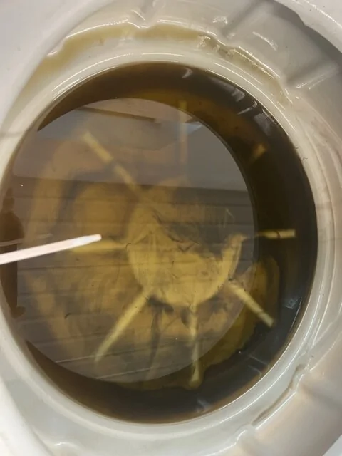

Rear (drain pan was completely clean prior to drain):
Jeep Wrangler JL Gear oil change now, or wait? IMG_1235

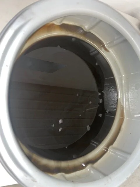

Front: It actually came out pretty clean with just a little bit of darkness as the bottom of the diff flushed out. The pan was not completely clean after dumping the oil from the rear. Maybe this isn't a great photo, but it does show the front mostly amber/clear, as it should be.
Jeep Wrangler JL Gear oil change now, or wait? IMG_1240
Anyhow, I'm posting this as a reference for if anyone asks if they should change their diff oil in their Rubicon early. Maybe, maybe not...I don't think I would have wanted much longer on the rear. The front would have been fine for many more miles.
