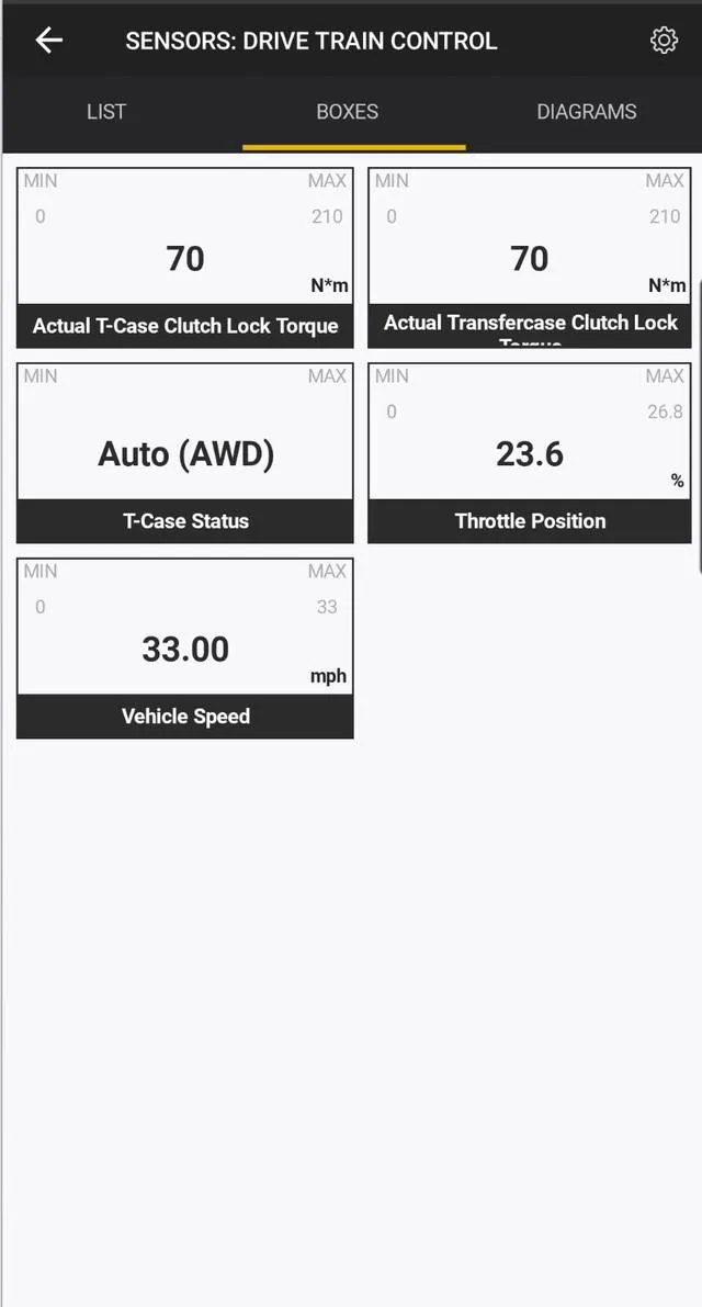

jellis4148 So this amount of clutch activation is bad?
Most of the issues with Full Time 4WD transfer cases is people not rotating tires or replacing them promptly when they are worn out, even the slightest difference in overall diamter can wreak havoc on the clutches in the T-Case
That doesn’t look like very much at all. I said with around 100,000 and being in auto its whole life is bad. 70 activations can be in one day of driving in snow. A lot of people don’t understand what it’s designed for. They engage it and leave for the life of ownership. That’s bad.

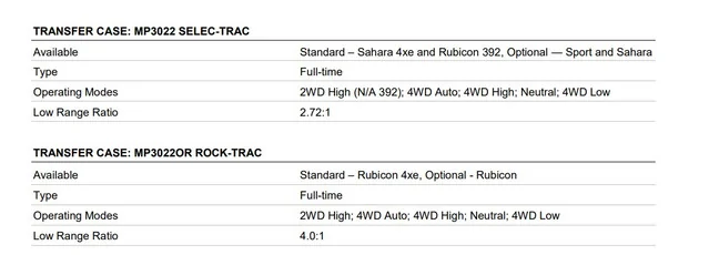

So again you are saying the owners manual is bad then? Why is it then that the 392 wrangler doesn't have a 2H option and only 4H-Auto and 4H-Part Time and 4L then?
Those are two different systems.
No it is not. You like being wrong don't you?
Jeep Wrangler JL Full time 4WD on a Rubicon - thoughts /experience? MP3022-applications
The difference in the 392 is that they simply left out the ability to run in 2H, the more you know....
