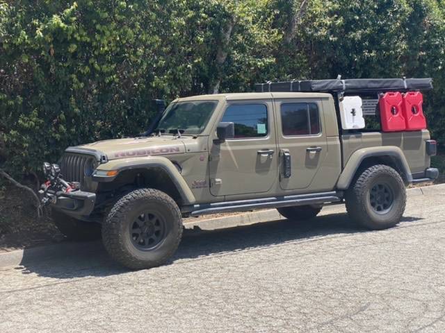

So. I have a 2020!gladiator rubicon with metal cloak 3.5 inch lift 37s gator green. Loaded. Love this truck. But. I miss the ease of driving a smaller vehicle so I started. Browsing dun dun dun! And came across a 2022 rubicon sarge green with. Full time 4 whl drive and the extreme 35” wheel packages. It reminded me of my. First jeep a 77 cj7 golden eagle package with. Full time 4wheel drive that Jeep was like magic to drive the feeling was indescribable
so my questions are
Do any of you have one and what do you think of it Should I sell my gladiator and get that Jeep. Or do something else like a a Cherokee trail hawk to run around town. The gladiator is my work truck.
I have owned 2 other rubicons in the past a 2008 jk and a 2018 jl I love the packages
I had planned to add an at habitat to my truck an. Sell the bed rack and gfc ultra light rtt
This will probably be my last new jeepnas I am almost 70?

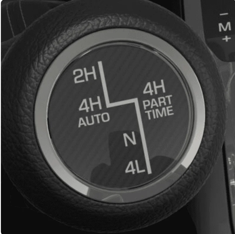

I have the auto 4wd in my Rubicon wouldn’t even consider another Jeep without it.
The system works flawlessly, roads today are a mix of dry, packed snow and occasional ice. Shift into 4 high auto and forget about it. One of the best features is no “pushing” through the tight corners on slippery surfaces like traditional 4 high does.

I have it in my JLR. Was concerned about the CV boots at first, but quickly got over it. I only use 4Auto (full time), when I’m really going to jump on the gas, in heavy rain, or when the roads just start to freeze.
In heavy snow or off road, I still use part time 4WD so that I don’t over heat the transfer case.
It really is a fantastic system, and I wouldn’t let it hold you back from buying a Jeep. Whether or not I would order it again is up in the air, as I don’t think it’s a necessity, it was kind of just a nice to have and I thought I would give it a shot while ordering.
I will add, that I do enjoy the CV’s on the front axle over a traditional U-joint, now that I’ve put some miles on them (~16k). And when you do start to get some bind while turning tightly in the rocks, in 4low, the power delivery feels much smoother. Standard U-joints feel like they’re hopping to me in similar scenarios.
Lastly, Jeep markets that transfer case as “heavy duty.” Although, I’m not sure that it’s any beefier than the standard Rubicon transfer case, maybe someone else here knows for sure?

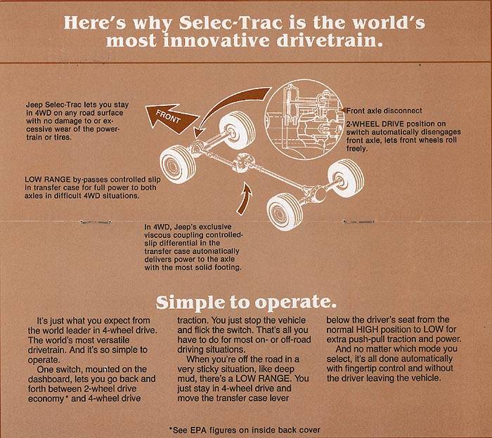

Selec-Trac has been in continuous production in various forms for 40+ years.
Selec-Trac first appeared on 1980 SJ Wagoneer and Cherokee Chief. It was then widely used on XJ Cherokee, ZJ and WJ Grand Cherokees, and KK and KJ Libertys. No one can accuse owners of any of those Jeeps to have treated them with silk gloves.
Jeep Wrangler JL Full time 4WD on a Rubicon - thoughts /experience? 1670113740867
Jeep Wrangler JL Full time 4WD on a Rubicon - thoughts /experience? 1670113876444
I had Selec-Trac on my 1995 and 2001 Grand Cherokees: it was a phenomenal 4WD system.
The original Selec-Trac used a viscous coupling. About twenty years ago Jeep then switched to the clutch pack setup being used today. Selec-Trac has been serving Jeep owners flawlessly all this time; clutch wear not being an issue.
Jeep Wrangler JL Full time 4WD on a Rubicon - thoughts /experience? 1670113905891
Jeep Wrangler JL Full time 4WD on a Rubicon - thoughts /experience? 1670113932759
Jeep finally introduced Selec-Trac to JL Wrangler in 2018. It was long overdue if you ask me. It truly is an excellent 4WD system.
