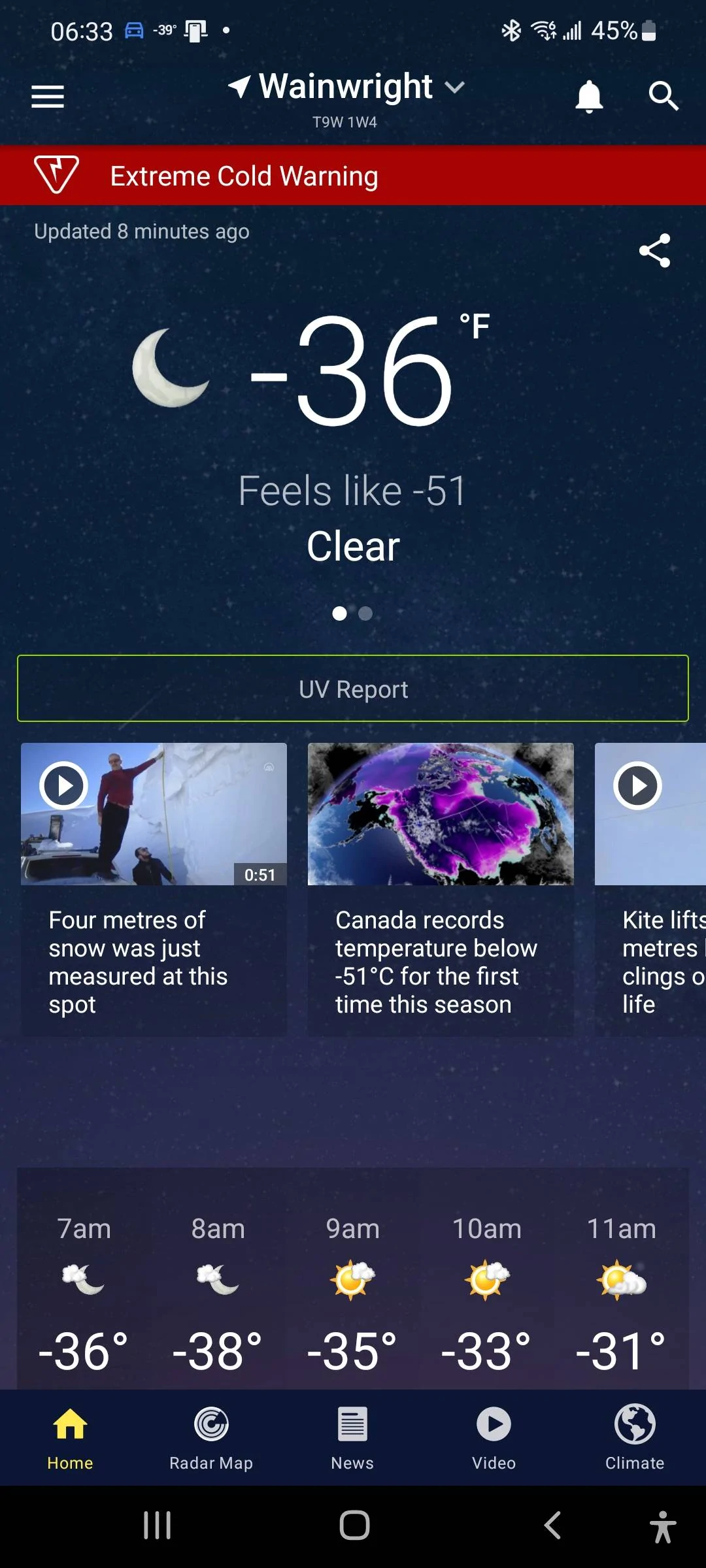

For all the jeep 4xe fan, I was stuck in FORM always on for 2 month. Was able to clear it by driving 3 hrs on the hiway for a trips. But now it's so cold here that the ICE always run no matter what. No error, no message, just too cold for the electric only. I accept the fact that it is too cold and don't blame the car lol. Still love my jeep, use to have a regular 2018 jeep JL so to me. I have same fuel millage in the winter, but more power and torque. ?

At those temperatures you must keep it plugged in , ALL the time when your not driving it . I believe someone posted on another thread once the main battery is below -21 f . The jeep will not start at all until the main battery that powers the jeep is above that temp .

Correct, basicly always plugin.

No idea I won't try haha. But basicly of the inside of your cabin is warm the battery is warm for a bit. Won't go to supper cold right away so you should be good for a few hours. Same of you put a bottle of water in your car will not instand freeze will take a while. Manual say not to leave over night with those temperature. I wish there was a notification via uconnect that say battery is almost at that level for a warning. That way if you are visiting friend or at the mall you could remote start the car to warm up the car.
