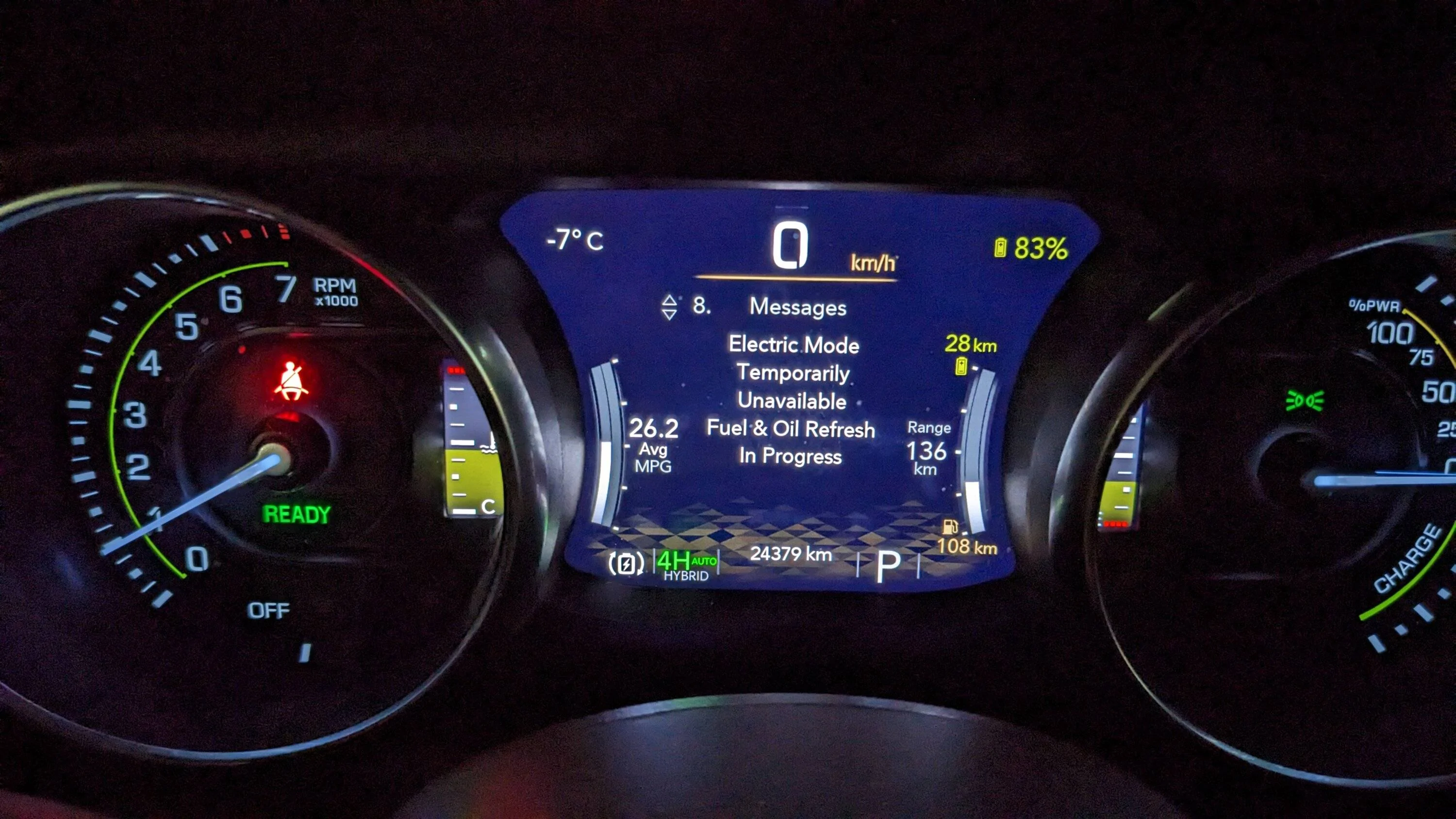

If you are using the HVAC and it's cold out you may get that message, this happened to me a couple of times already, there are ways to balance the HVAC and drive in electric, however once I'm using the HVAC it's on high, the defroster is going etc, so I don't care, I'm running on gas, because the battery deplete fairly quickly with that HVAC on.
Note the temp on the dash when this happened, -7c shown is like your 20f.
I think once you are getting around that 25f -20f and the HVAC is going, you might probably see that message.
For me it came on, the next day warmed up, the message didn't come on again.
Jeep Wrangler JL Fuel and oil refresh PXL_20221226_003641129
