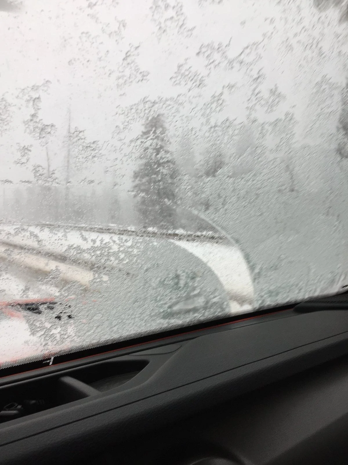

If you look at the second picture you can see the middle of the windshield is clear where all the air is blowing. If you're going to have a vent all the way across, it should at least have air going through the most important part, the driver side, not the middle.
but that does nothing for the wipers. His problem is that the wipers are icing up. They are constantly moving, so their is no way warm air on the inside can help defrost them.

Mine struggles at the outer edges. I bought some square plugs as suggested by someone here on the forum to block air in the center and force it to the outer edges. We'll see if it works. My JK does the same thing.

i've asked about this in one of my post and found out that others on here was using plugs to divert the defroster vent to blow warm air to the side of the windshield. i havent done this since i'm not having any issues in defrosting the ice and snow off the windshield. i had bosch icon wipers on my 07 grand cherokee and they work great. they are pricey $60 but they have been the best one i've found that works. i plan on getting them when the time comes.

I just went through a few days of crazy snow and ice and because i had taken heed of the warnings on this issue...I purchased 3 in 1 prestone de-icer for the windshield wiper solution, new blades and as others have stated the blocks from ebay also purchased the sliding block tool organizer. The sliding block was great... just space em out and lay it in to get the air to each side of wind shield.

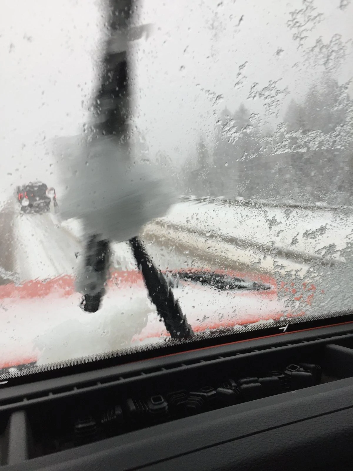

I know this has been discussed at length but what happened to me yesterday was completely unacceptable. I was driving in white out conditions in the mountains with a fist sized ball of snow under my windshield wiper because of the poor design of the vent. I had almost zero visibility, and no place to pull over and fix it. I'm very troubled that my "go anywhere, badass" Rubicon requires me to take my life in my hands if I'm driving in snow. It's only a matter of time before someone is injured due to this.
If you buy some silicone spray and coat the wiper arms and blades with it, it should help, and prolong the life of the blades. And while you're at it, spray all your weatherstripping and your doors won't freeze to the weatherstripping and again will last longer.

What in the h-e-double hockey sticks does that have to do with the defroster??
Get new wipers lol....its clearly slush lol.

In the first picture it's clear that ice piece was on there prior to starting the vehicle. Why didn't you clear the vent/wiper blade area before driving in white out conditions?

I drive in those conditions frequently and I use a washer fluid heater like a Alphatherm AT-38OD with Recochem Turbo Power Premium Washer Fluid and De-icer fluid. Cleans and melts ice very quickly.

Not at all. I’ve driven Wranglers in white out conditions a bunch of times. A piece that size doesn’t just develop randomly especially with the wipers in constant motion. It was already on the wiper blade. Ironically there’s even a piece below you didn’t take the time to remove.
Another complaint that boils down to user error :no:
