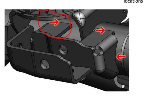

Barnes bracket looks like the ticket, I may have to do that too.
Cutting the rear weld under the spring bucket looks like a bitch though:
Jeep Wrangler JL Front Track Bar Play at Axle 1724697222195-0n
EDIT: @my_jeep_sucks would be interested in your feedback once you get it installed.

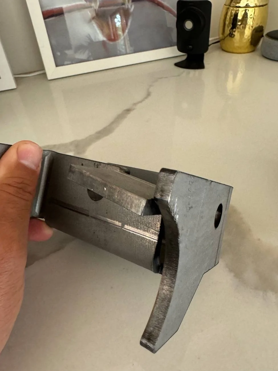

I think cutting off the bracket in pieces will allow you to remove enough material to get better access to that part under the spring bucket. At least that's what I'm hoping 🤞. I just did a terrible job clearancing my skid plate to install the MC DB3 control arm drop brackets I've had sitting around for years. And that was with pretty good access. So, this should be interesting...
Jeep Wrangler JL Front Track Bar Play at Axle IMG_3165
Well, I don’t have anything strong enough to bend this into the correct position. It’s a real shame, because this would have been just perfect.
Going with a washer fix on either side of the bracket for now. I'll see if Barnes will ship me a new bracket without me having to send the old one back, so I have it in my back pocket down the road.
Damn. Take some shots when you do the washers if you don't mind.
