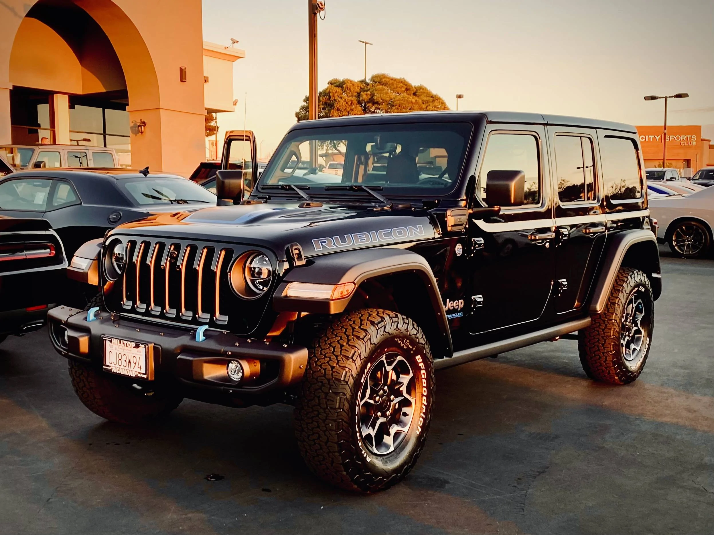

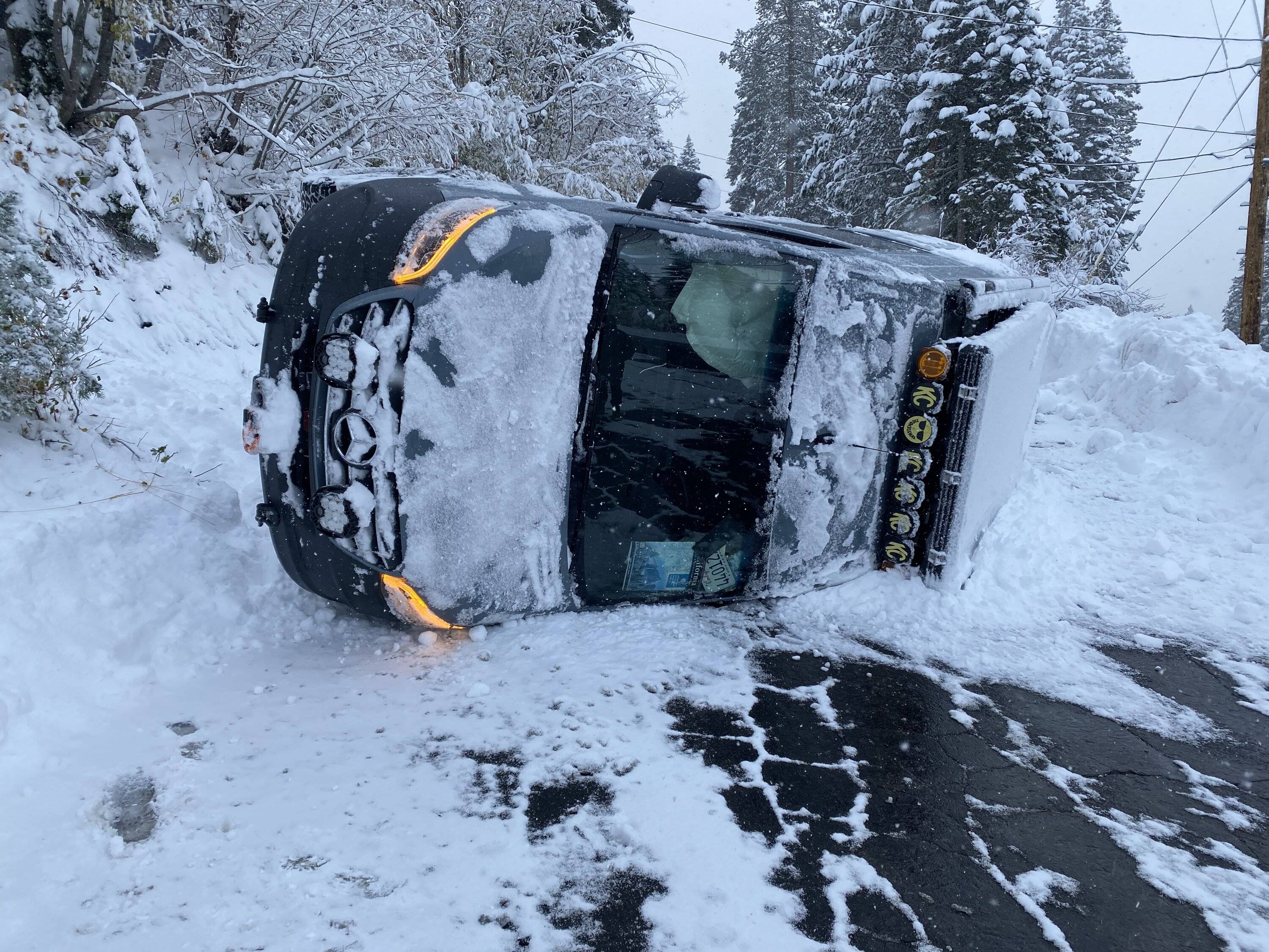

Just saw the what did you get for Xmas thread and figured I might as well document this build. Due to a psychotic driveway in Tahoe I rolled my Sprinter which resulted in a new 4xe Rubicon.
Jeep Wrangler JL Destroyed MBZ Sprinter = JLU Rubicon 4xe build 17CF1843-2B0F-4B86-9C62-246586EC4320
Jeep Wrangler JL Destroyed MBZ Sprinter = JLU Rubicon 4xe build 4355A51F-A797-41D2-AD40-7BE359B6DDAB

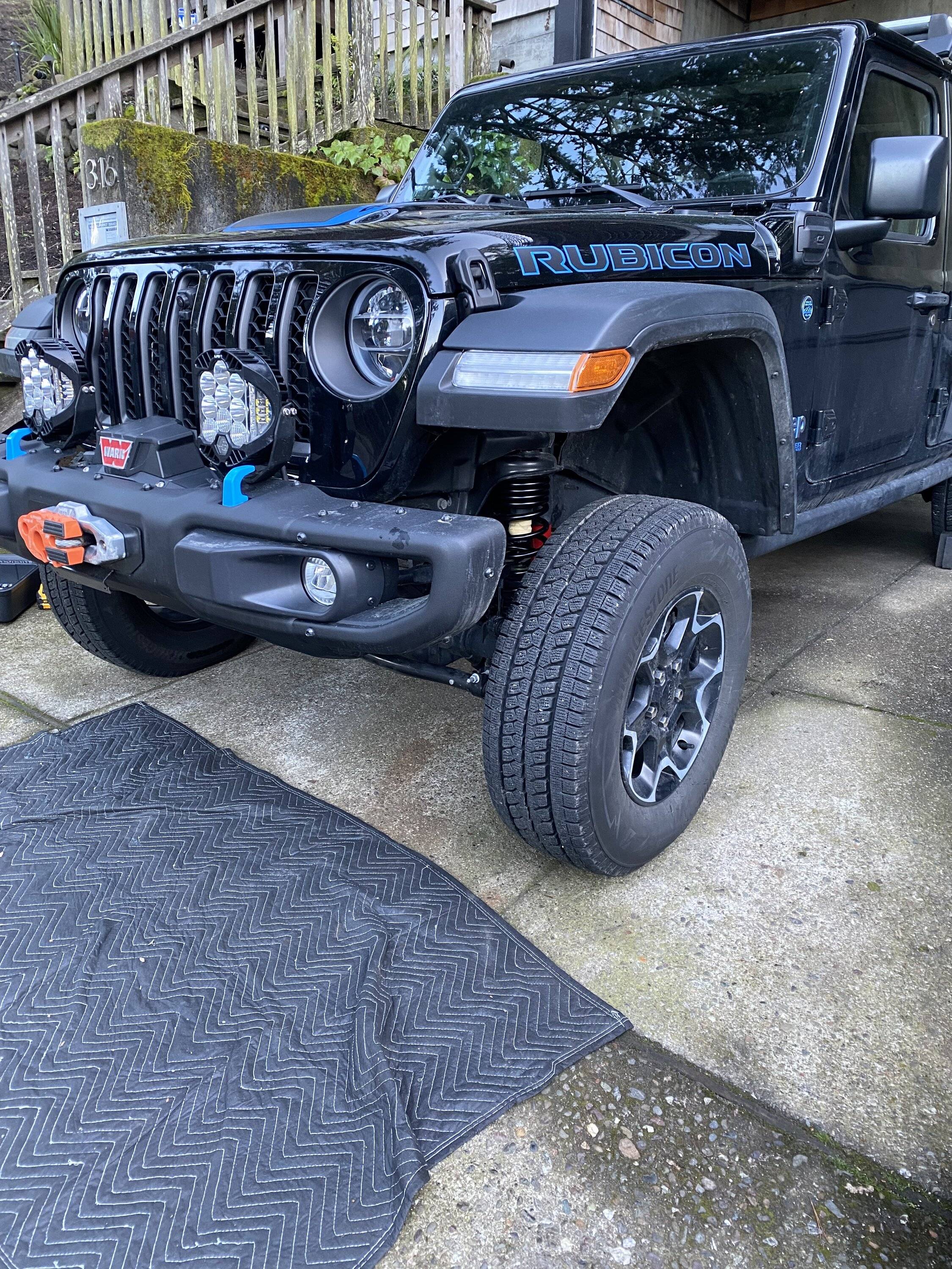

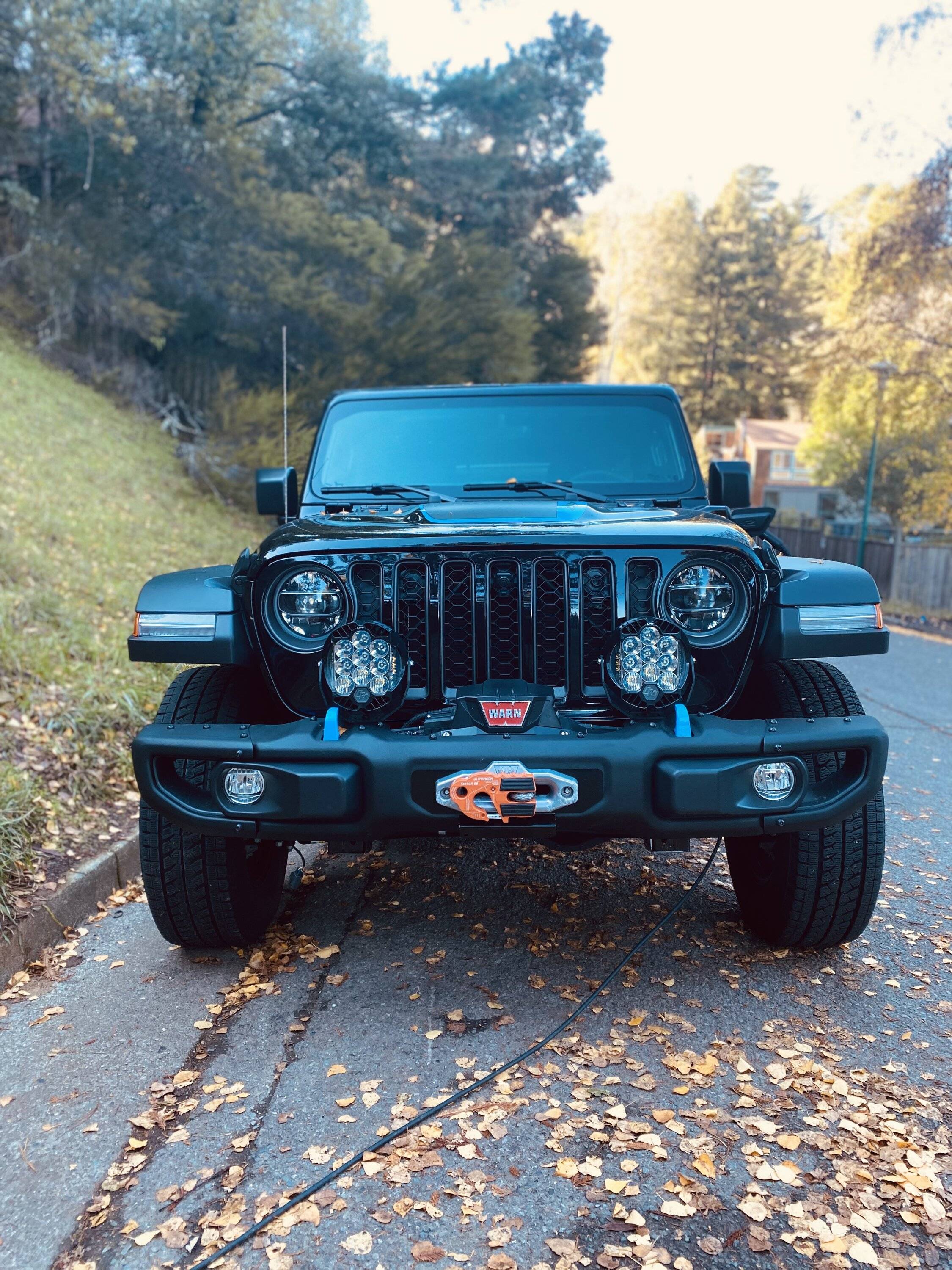

Thankfully my Sprinter was able to donate a few parts; Warn Zeon 12-S Platinum winch, Baja Design LP9Pro lights, KC Gravity Pro 6 lightbar, and an ARB twin compressor.
The day after I got home I installed the BD LP9’s
Jeep Wrangler JL Destroyed MBZ Sprinter = JLU Rubicon 4xe build B120A557-5DD8-45F1-907A-1D98531B5419
I have them set to the aux 1 switch that triggers the low beams. This runs through a relay, so when you trigger the main high beams it also goes to high beam on the lp9’s.
A few days after that I tackled the winch. Getting the winch in there sucked. The 12-S is so damn big it was virtually impossible to get to the inner bumper bolts. I couldn’t get a socket to fit. I had to unbolt the winch from the plate so I could shift it from side to side while tightening up the bumper. Was more than a pain in the ass than I wanted it to be.

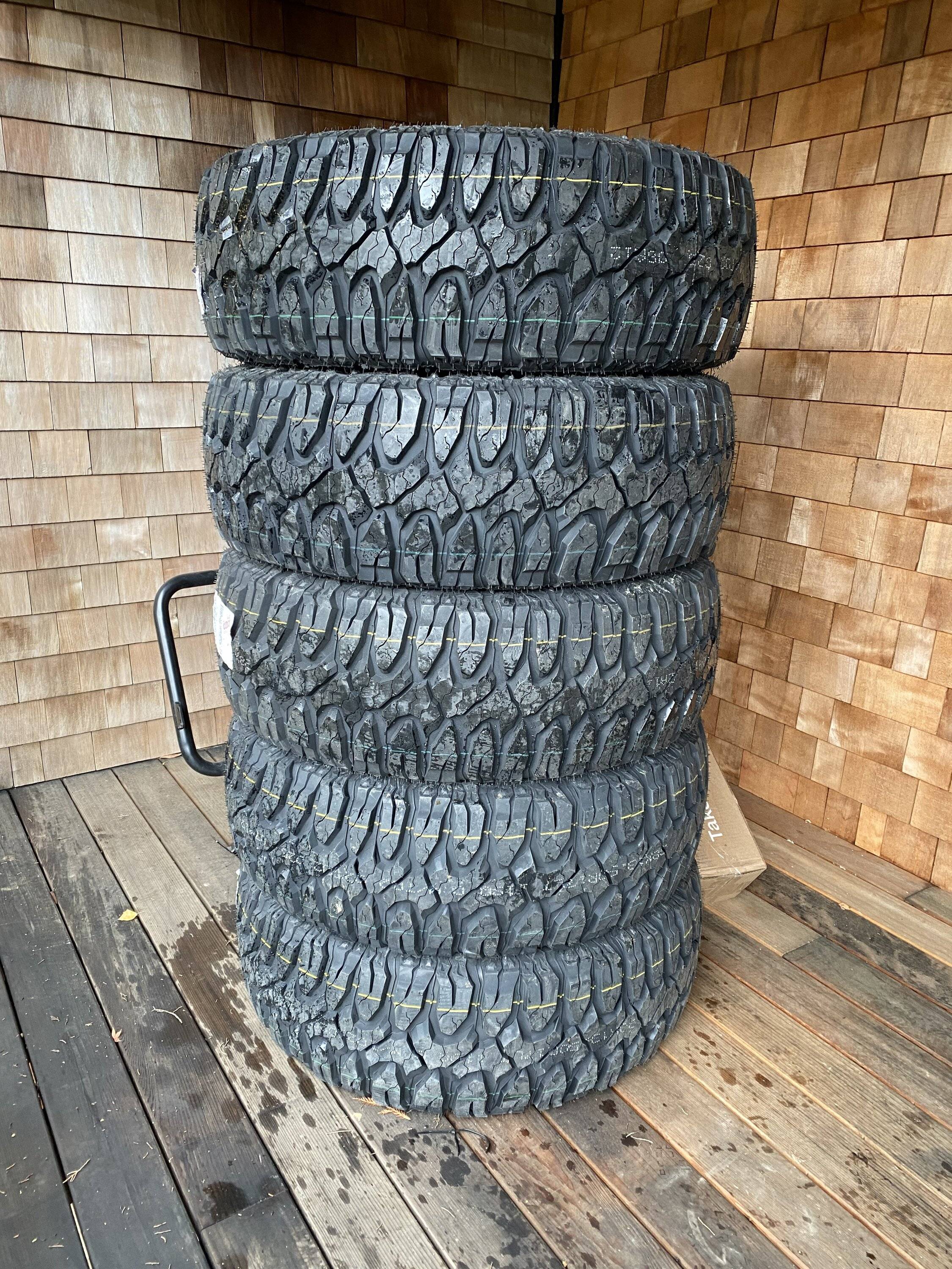

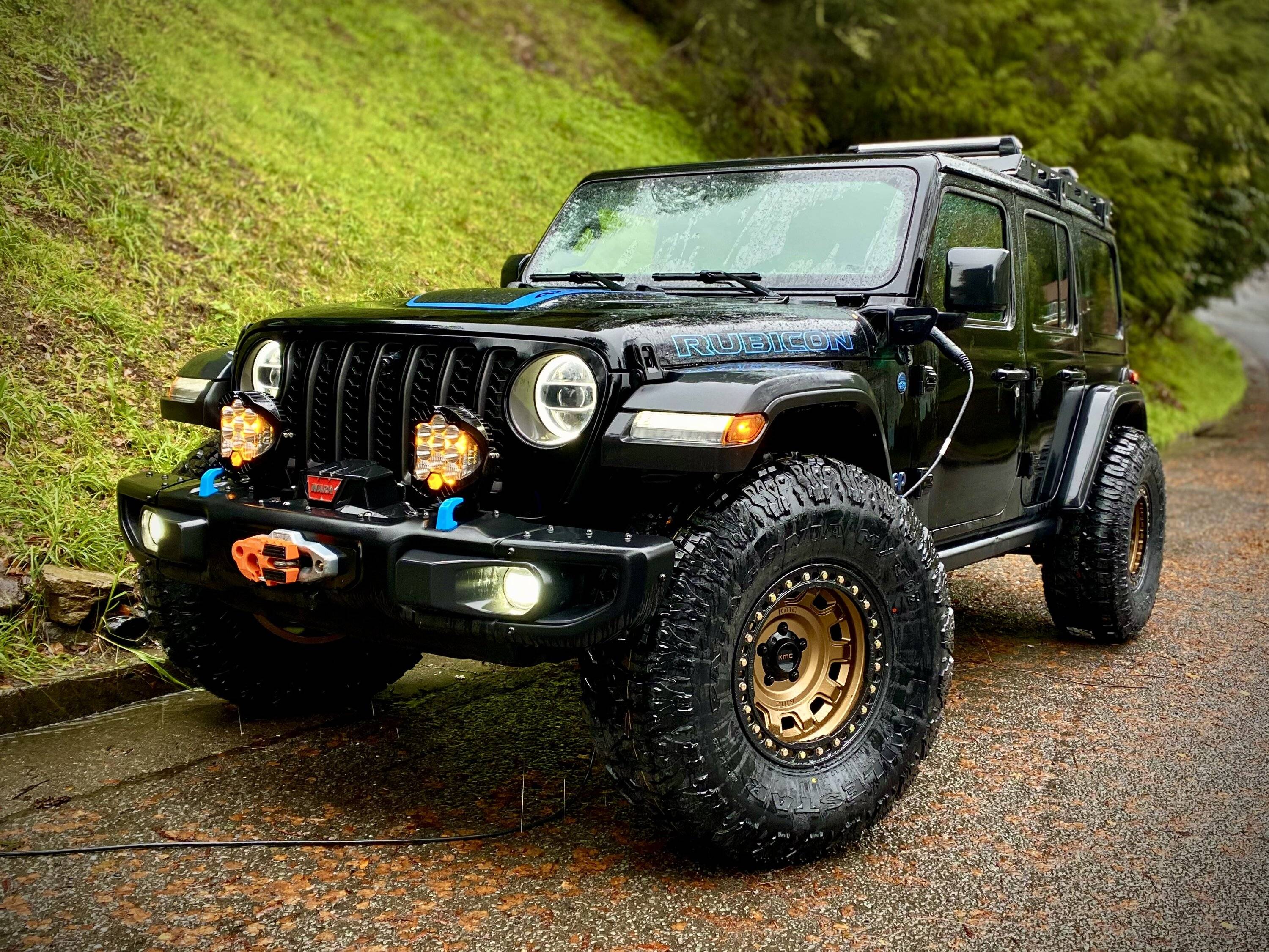

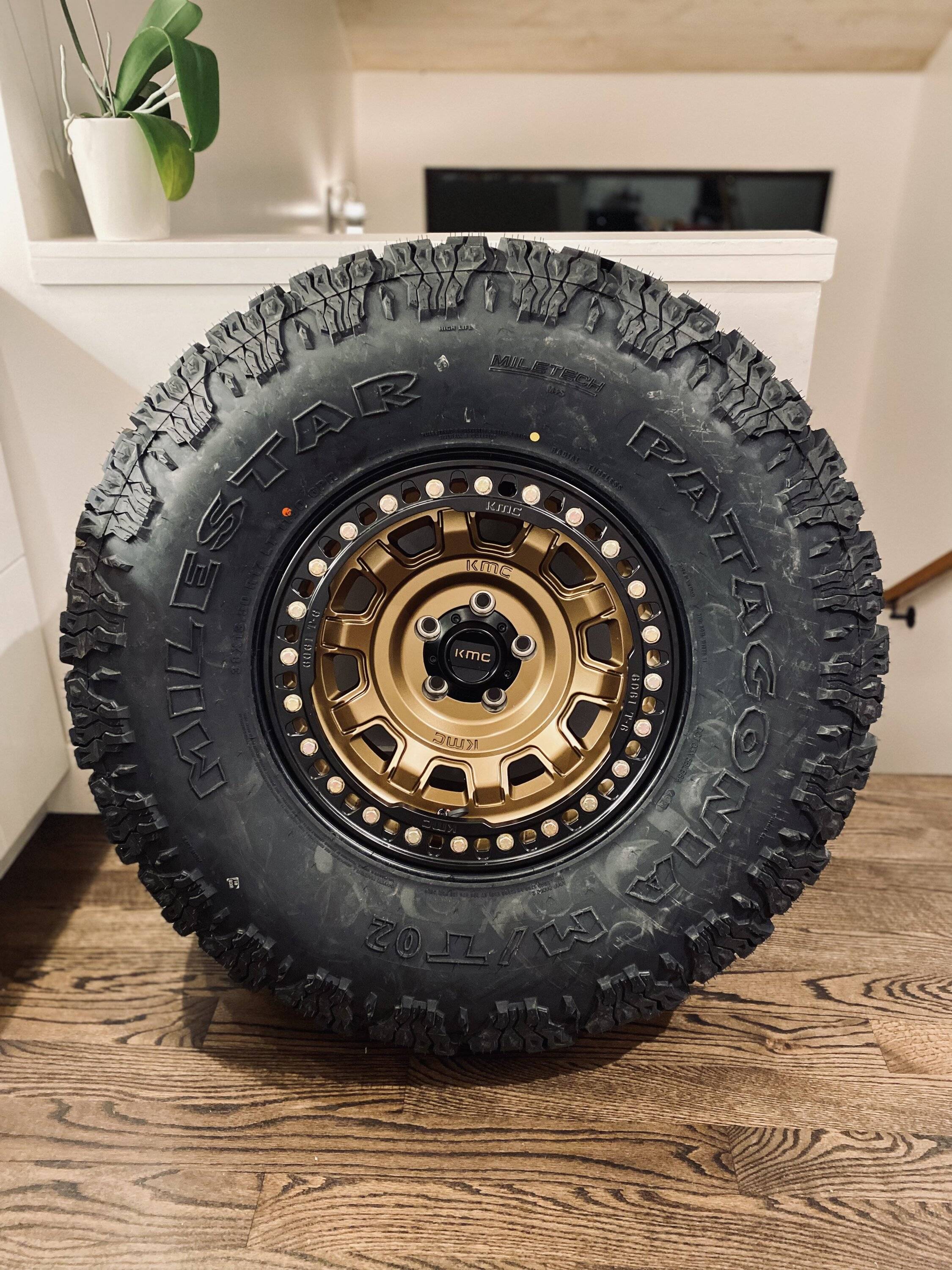

Thinkgs are happening. Patagonia M/T-02 in 38x13.5r17 just showed up. Feelt kinda bad for the tiny Fedex girl who dropped them off. Gonna be hard to wait for the Metalcloak Gamechanger lift kit and Accutune Fox DSC’s. Anyway these will fit under stock suspension?

Damn, didn’t realize mounting beadlocks was such a pain. The internet makes it look so easy. The hardest part was getting the tire bead to sit down into the front groove to accept the lock ring. I’ve done three so far and I’m beat.
Jeep Wrangler JL Destroyed MBZ Sprinter = JLU Rubicon 4xe build FEF23035-D02A-4B79-9200-EB16364C27F0

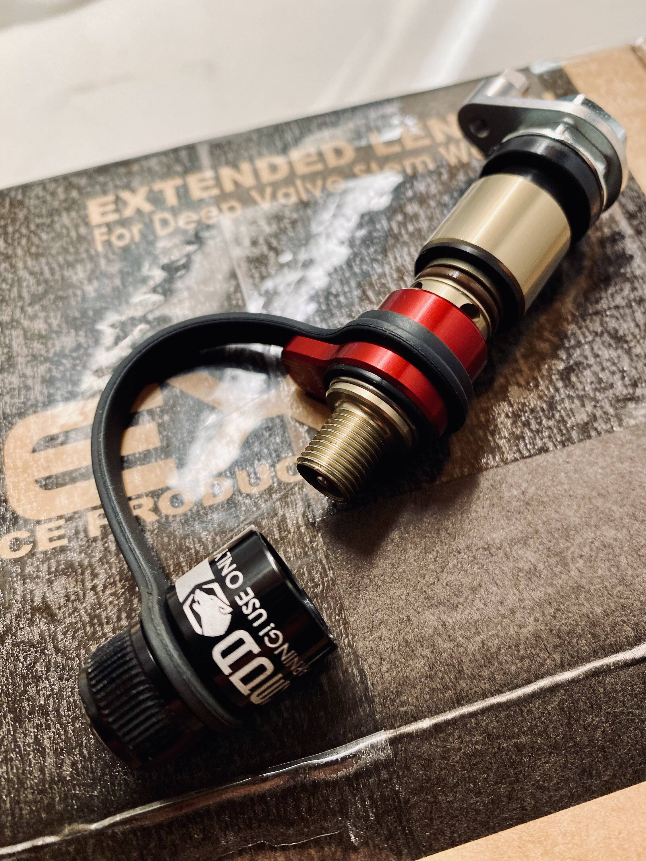

I’m giving these Apex quick deflate valve stems a try. I’ll report back once I have a chance to put them into action.
None the less, I can’t help but wonder if these will fit under stock suspension ? It’s going to be really hard to wait for everything else to show up. Rear shocks are en routebut that’s about it.

Kinda curious to see how those MT02s perform and last compared to the originals.

They look very similar. Has to be a new rubber compound, as the originals would wear exceptionally fast. But the originals were/are great on the rocks, just terrible on the pavement.

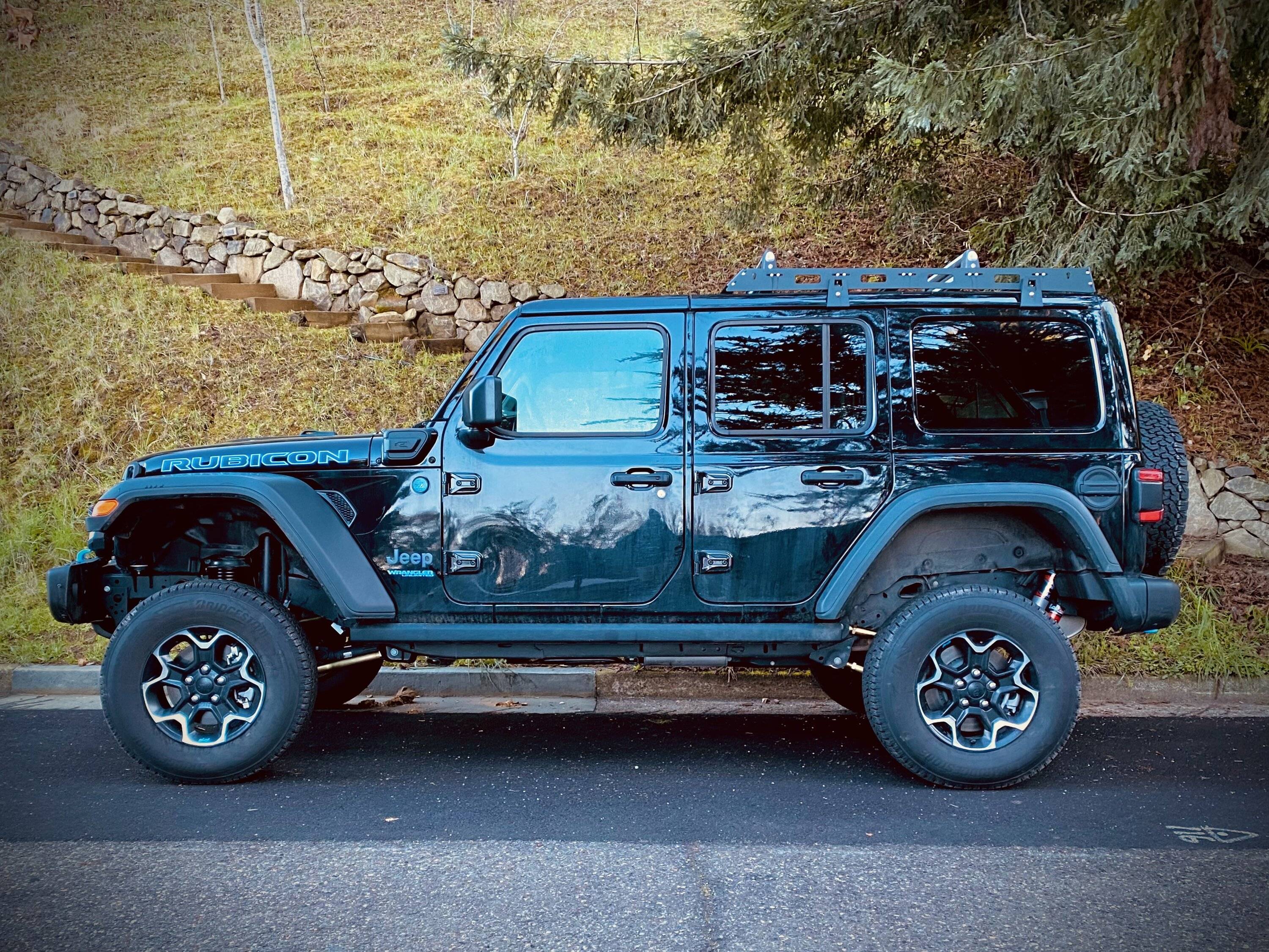

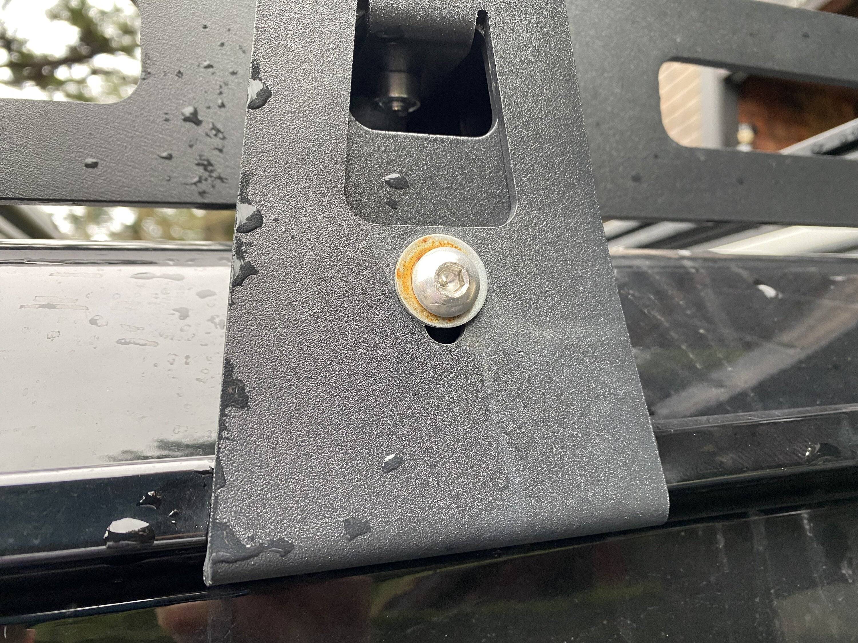

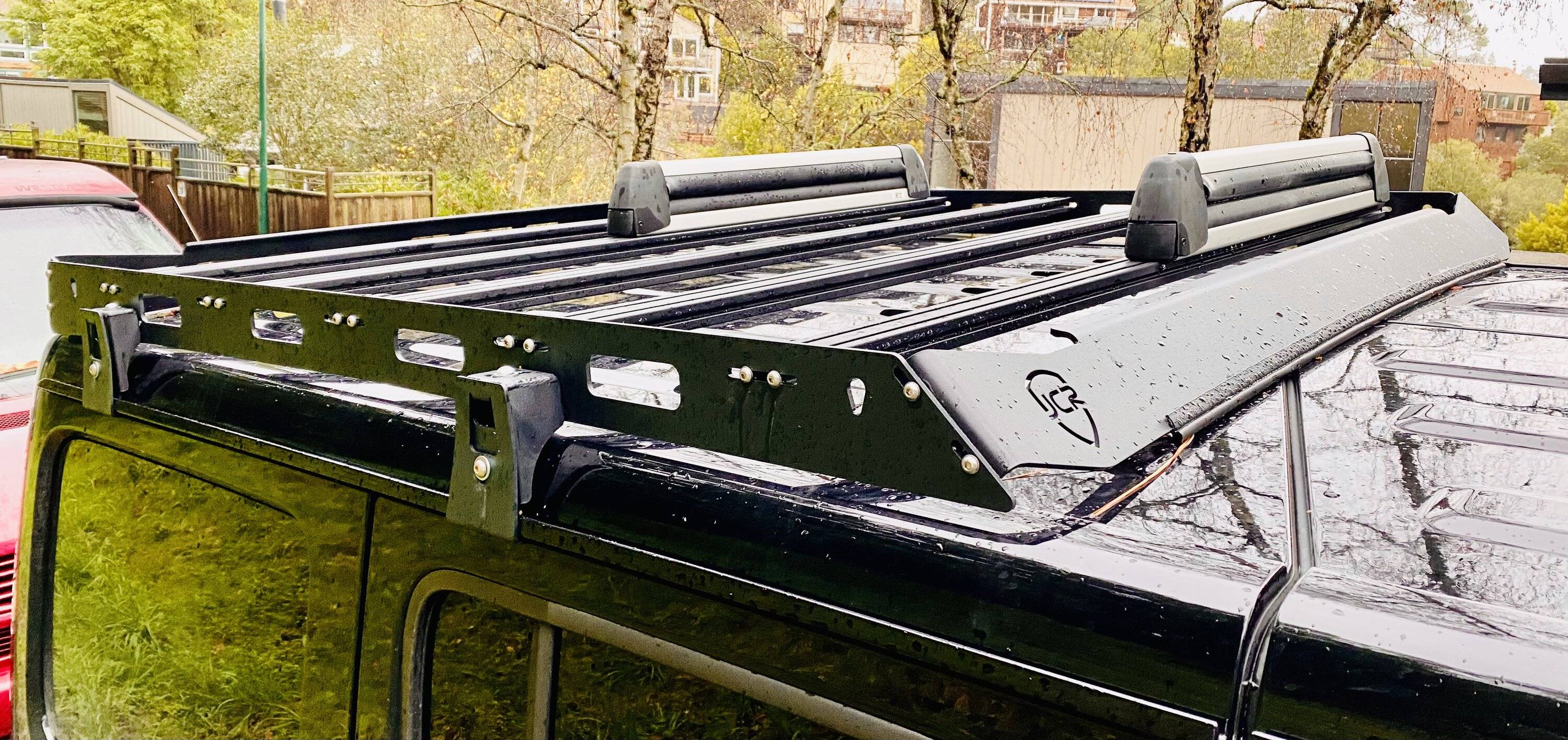

One of the first modifcation I made was the addition of a JCR Off-road short roof rack. Lead time wasn’t too bad, and I got the rack in about 2 weeks. On opening the package I was pretty impressed at how well the rack was packaged. After unpacking things I found no instructions and a massive bag of hardware. I couldn’t really locate instructions online and ended up watching JCR’s install video. Overall it wasn’t rocket science and I didn’t really have any issues. The lack of instructions and the extra hardware on completion did add some confusion.
Here’s the installed rack with ski/snowboard clamshells.
Jeep Wrangler JL Destroyed MBZ Sprinter = JLU Rubicon 4xe build 096C7D2A-1D2E-4B1F-B5F5-018B0BBC758C
The main reason I’m posting this is that I started hearing a clicking sound coming from the roof about a week after the install. Today I went around and tightened all the fasteners. It helped with the sound around town but I’m still hearing it on the freeway. What really surprised me was the hardware for the feet that attaches the rack to the roof rails was starting to rust. However, none of the crossbar fasteners were rusting. I’d think all the hardware would be stainless steel, but that doesn’t seem to be the case. I’ll be reaching out to JCR for a resolution.

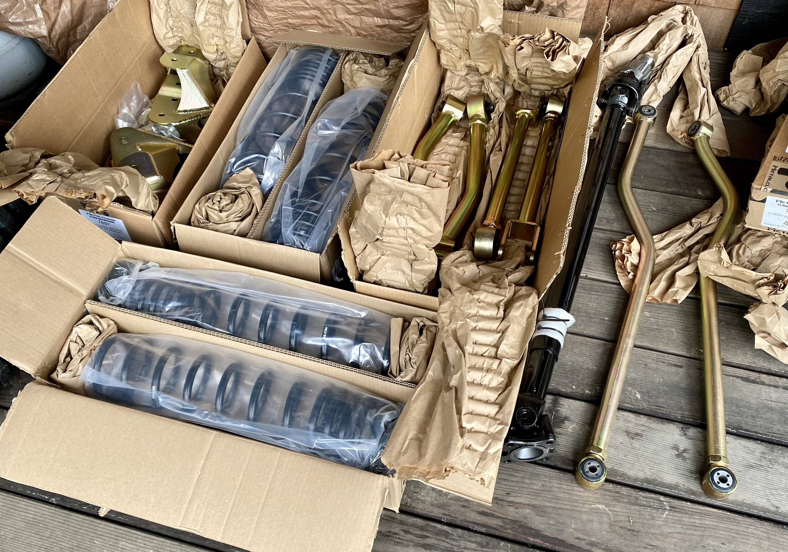

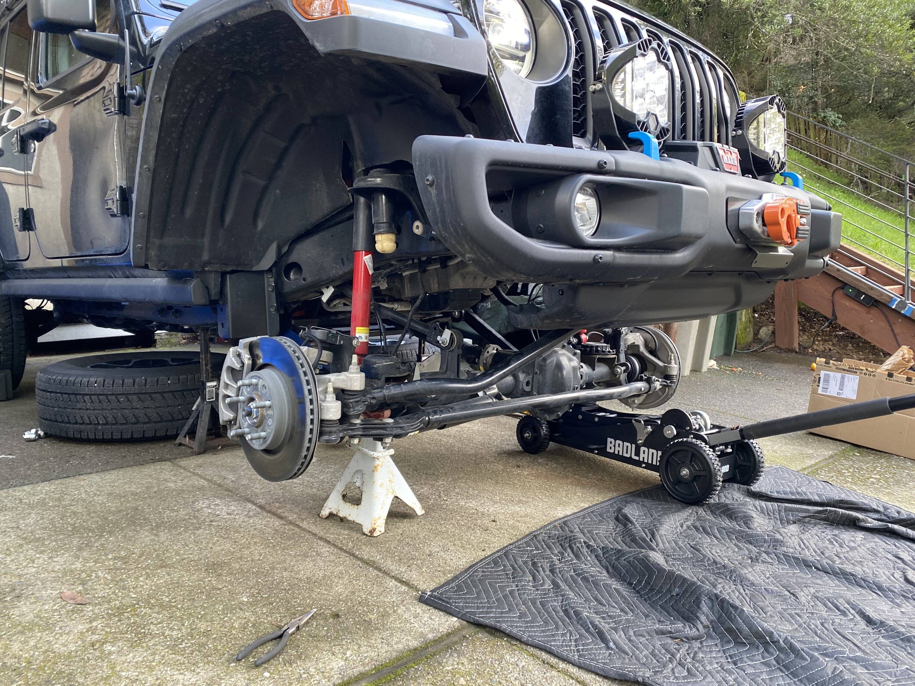

Finally got started on the Metalcloak Game Changer 3.5” suspension install. Had to get a bit creative as my front shocks have not arrived yet, and won’t until May. I’m using a Teraflex extension on the lower shock mount in the interim. I got through most of the front today. I‘m going to have to stop by harbor freight tomorrow to get a grinder to radius the window on the axle side track bar mount.
I was a bit surprised to see some rust on the oe track bar bushings on a car that only has 4k miles. Another thing I couldn’t get over was a fairly strong fuel smell under the Jeep.
Jeep Wrangler JL Destroyed MBZ Sprinter = JLU Rubicon 4xe build FC22F4BE-C158-4118-9A82-A684D689C733
Jeep Wrangler JL Destroyed MBZ Sprinter = JLU Rubicon 4xe build 07A361E6-86A6-4E3D-A650-79C0CDB6E023
Jeep Wrangler JL Destroyed MBZ Sprinter = JLU Rubicon 4xe build A30F33CF-5660-4AB1-90B8-DAEC20619356
Just a wee bit of a fender gap. I wish I had taken some before measurements. Also, I’m going to stick with the Blizzaks until ski season is over and then move over to the MTs.

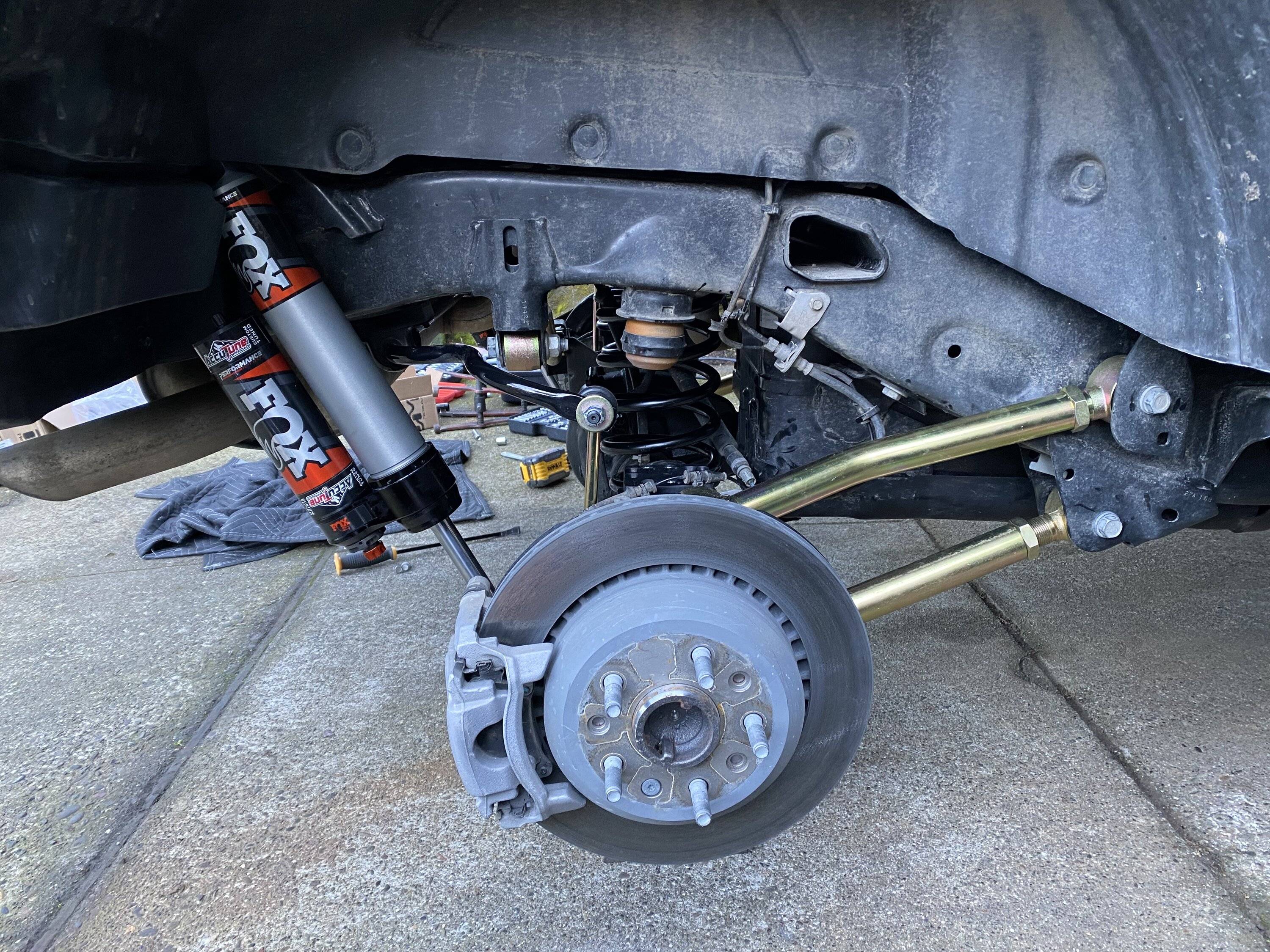

Installed a Fox ATS steering stabilizer and wrapped up the rear. Looks super funny on the snow tires. Also, need to straighten the steering wheel.
Only hicup was trying to get the MC DB3 drop links installed. The instructions showed a bolt going through an existing hole that wasn’t there. Will have to give them a call in the am.
Jeep Wrangler JL Destroyed MBZ Sprinter = JLU Rubicon 4xe build F1C7DA82-0A96-48E7-A930-7D92FBE6F0E3
Jeep Wrangler JL Destroyed MBZ Sprinter = JLU Rubicon 4xe build 9077D00E-2DD1-4134-8E48-0A767B5E69BE
