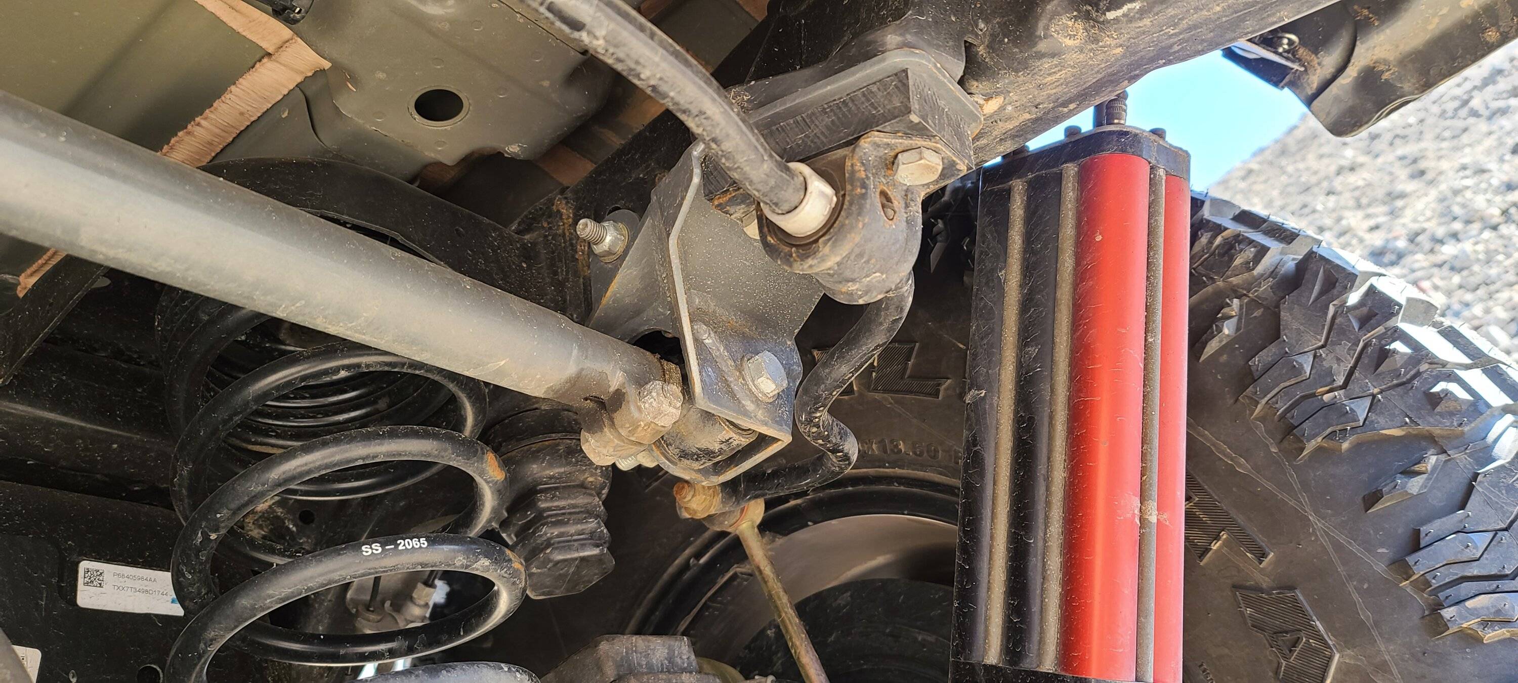

Is this for the rear only?.... it seems you used a Synergy relocation bracket on the axle side in the rear... what did you use on the frame side? Thanks!
I used synergy for both ends of the rear track bar. Only reason I chose that brand was because it's the only one that didn't have a gusset/ubolt that extends further inboard on the axle tube. I planned on also adding the Metalcloak rear diff skid and knew that there would be ubolt interference between the two pieces. In hindsight, I would use a more cost efficient bracket and the nicer Next Venture diff skid.

I already have the rear axle side bracket in the cart (Teraflex not Synergy). That’s something I decided to do a while back and just waited for a sale. Incidentally, @Northridge4x4 has a great sale going that ends today. I thought doing the same in the front would yield even more benefit but seems I’m wrong and it’s unnecessary with my 2.5” of lift. I can’t foresee ever going any higher than 3.5” in the future, so no drag link flip is in the cards. What frame side rear bracket do you have? I did install the SS front frame side reinforcement bracket but that doesn’t lower the bar, only strengthen the attachment.
Thanks.
I used synergy for both rear brackets. Their axle side one is the only choice that doesn't extend to the same spot on the axle tube that Metalcloak uses to attach their diff skid. Also, I used to have Synergys rear track bar and control arms, so was trying to be as uniform as possible.
And yeah, strengthening the track bar frame attachment is very important in my opinion. After all, it's the sole anchoring point for keeping the axle assembly centered and holding dimension in relation to the frame/body.

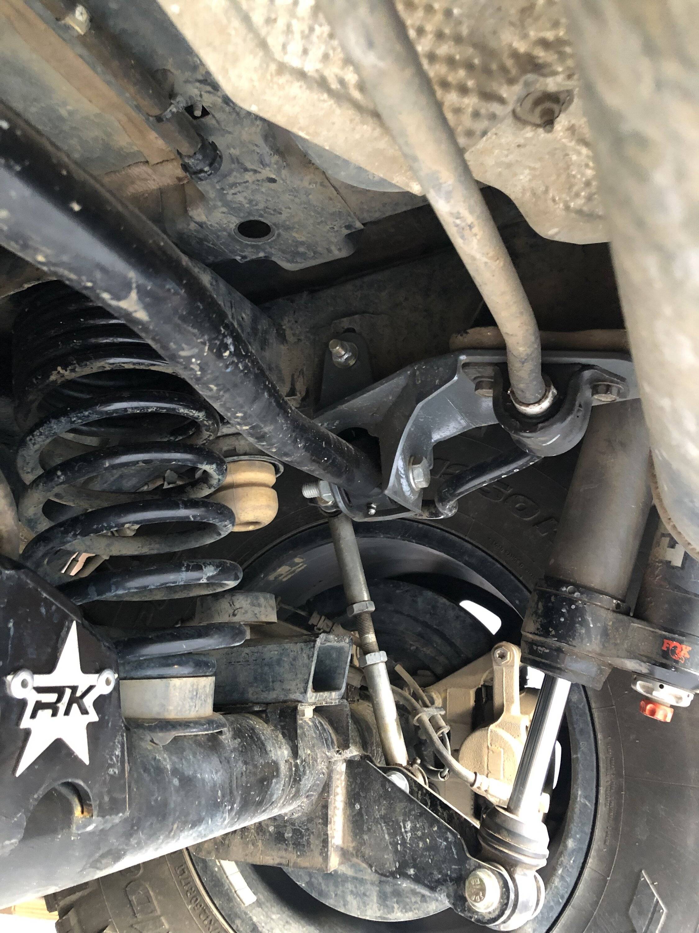

I installed it for the piece of mind, the oem bracket is thin and weak. The pain train that Shawn is building is a buy back from insurance co from being in a wreck. The track bar bracket ripped open like a piece of paper…… I didn’t feel any added stability from it personally…… but I feel better that it’s on……
