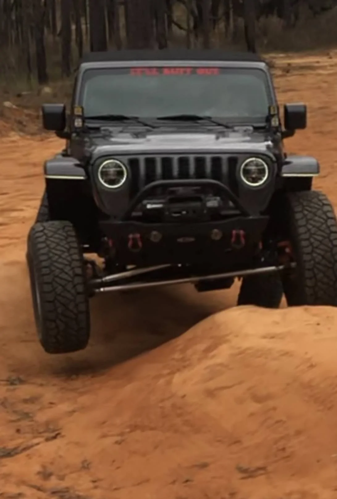

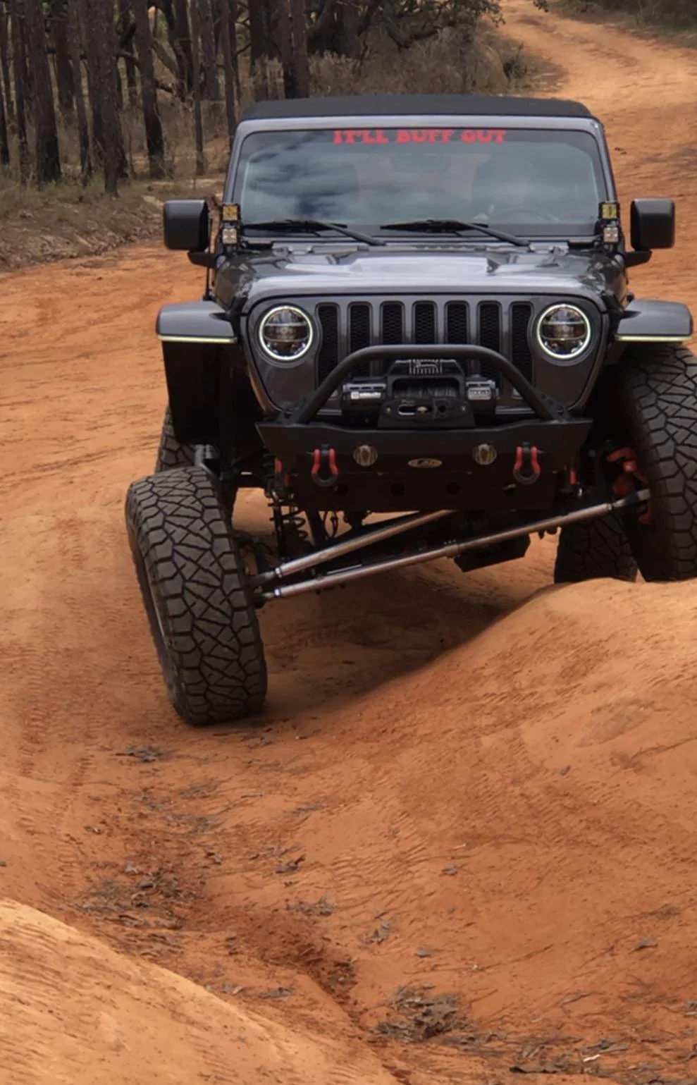

Normally you wouldn’t unhook if you have the electro disco unless the links are impeding flex. With the heim style there’s no restrictions, and the elect disco works better. As far as when you would disconnect, that’s personal preference, but for reference, I disconnect before getting on the trail, and don’t reconnect until I hit the pavement. Makes for nicer ride on the trails.
Here’s a small example of connected and disconnected I did so the wife could see the feel the difference.…..the Jeep stays level both passes, but the wheel comes off the ground when connected……..
connected…..

disconnected
