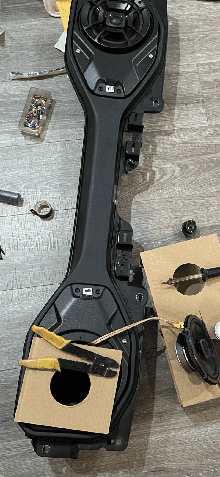

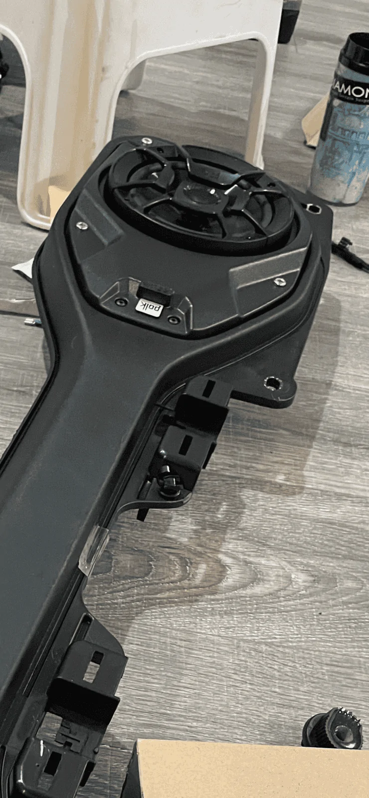

Well, if you are going to all the trouble in doing the adapters, upgrading the speakers and eventually adding the amp, may as well do it right. I ended up drilling through and modifying the clip that goes into the soundbar to run the better wire. I don’t remember snapping any pics of that, but here is what I ended up with. Not the greatest pictures.
