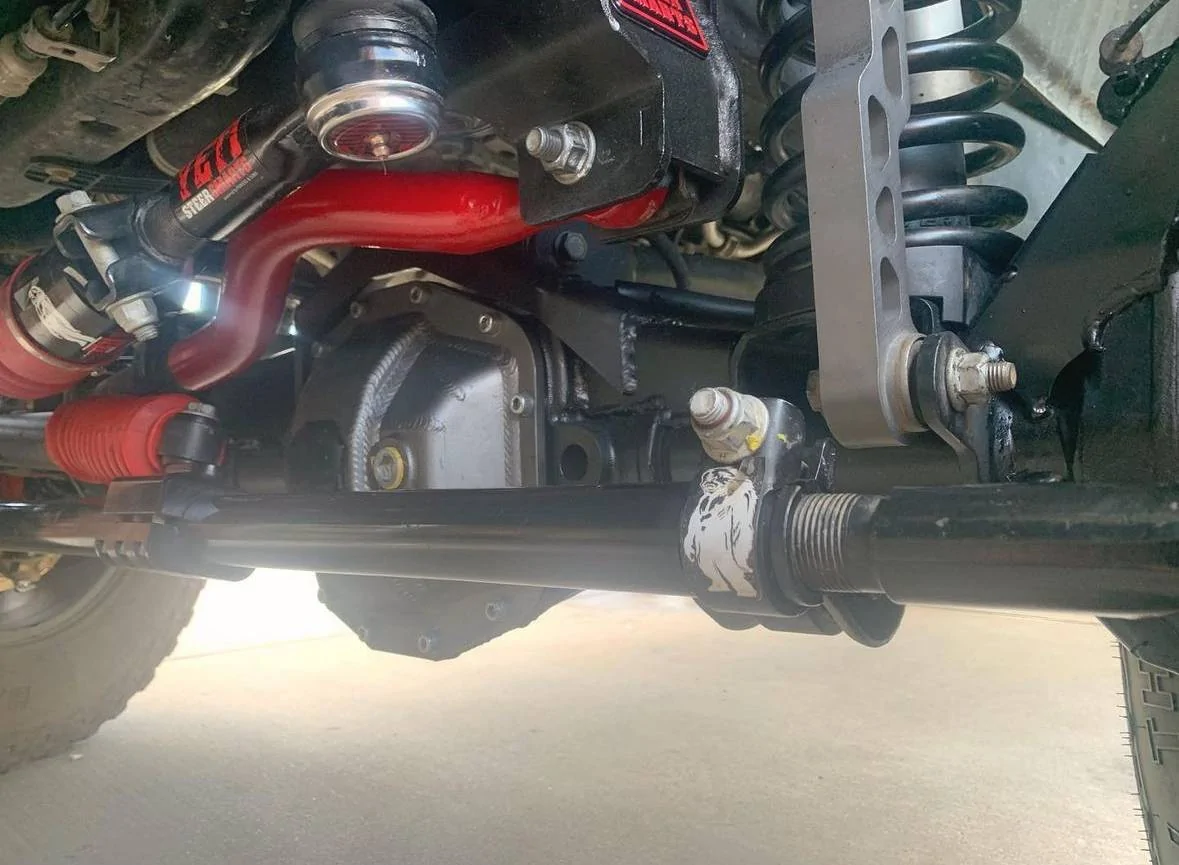

On my 2019 Rubicon I just installed the SteerSmart dragline, TieRod, Track Bar and stabilizer relocate.
I would like to change the diff cover but am reading that you can have clearance problems.
Who has this set up and what diff covers work with out modifying them?

This my photo from a few years ago. I’ve had zero issues with clearance on the diff cover. I’m using a Ballistic Fabrication diff cover but I’m on a 2.5” lift
Jeep Wrangler JL Front Diff Cover with SteerSmart IMG_1710
