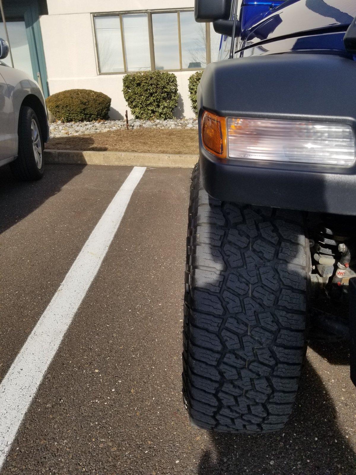

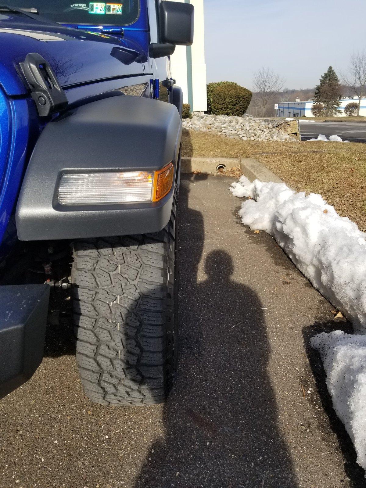

I have no lift and my front axle looks to be 3/4" off center to passenger side.....too ocd?

No idea about what their spec limits are but offsets are a problem under certain driving conditions on pavement. Not an issue when off road. Off road, you slip and slide already just part of the fun. Under wet heavy braking conditions the offset "can" cause a significant pull or make heavy braking feel like the front end is tugging in a different direction than the back end. Uneven pavement, free way joints, that are along the direction of travel will also produce stronger than expected "tracking" or "pulling". Depending on your tires / tread these symptoms can be minimized or exaggerated.
The offset also provides uneven effort to making turns and causes premature wear when cornering.
NONE of the above symptoms are dramatic or may not even be noticed. For me the issue was when I had slam the brakes to avoid a collision and it was near impossible to keep the JL in the lane I was in. My offsets were closer to 3/4 of an inch front and rear.
After that I became obsessive over my own safety and just got the adjustable track bars. Went out and tested the brakes and its supper easy to control. Not to mention my OCD about the fact I just bought a vehicle that was visually out of whack was solved.
