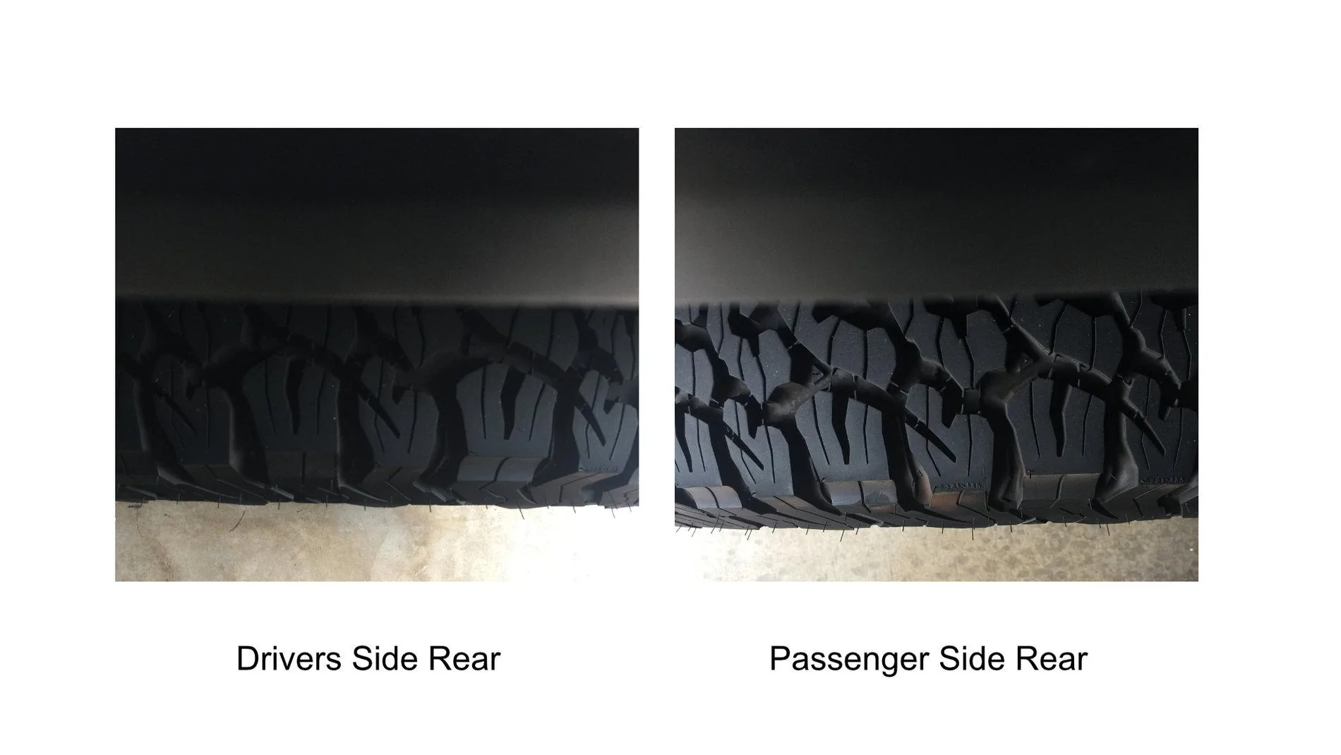

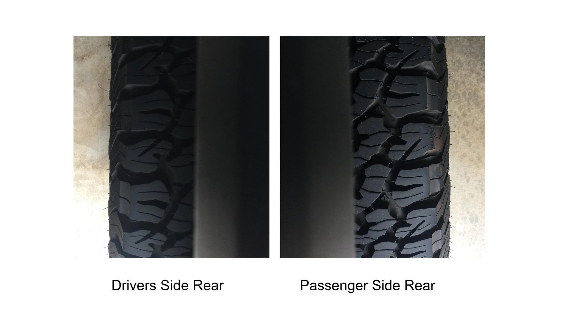

Right. This kit accommodates such changes up front, but not in the rear. I've got 35" KO2s on my JL and there's a lot more tire coming out from under the passenger fender rear than on the driver's side.
Correct. You probably have more than I do as far as a shifted axle. I am running the RC lift and in the rear it’s only 2”. At 2-3” of lift there’s really no need for adjustable trackbars. Really not any need for control arms either at such small lift, which is the really awesome part of these JLUR’s. You don’t need much, and no severe geometry changes like past models.

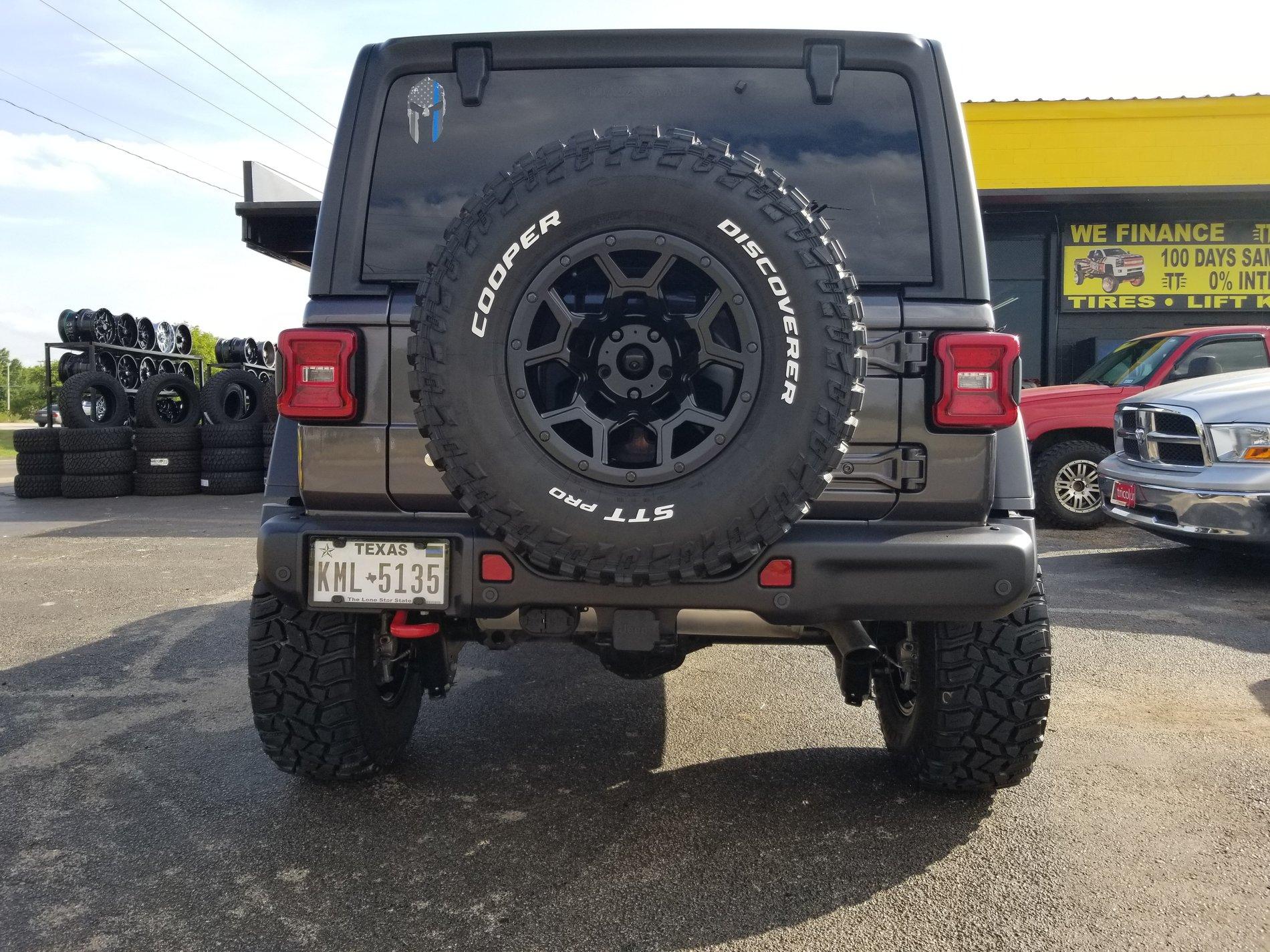

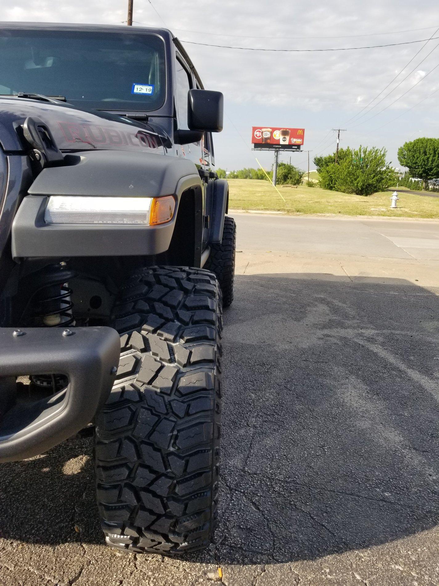

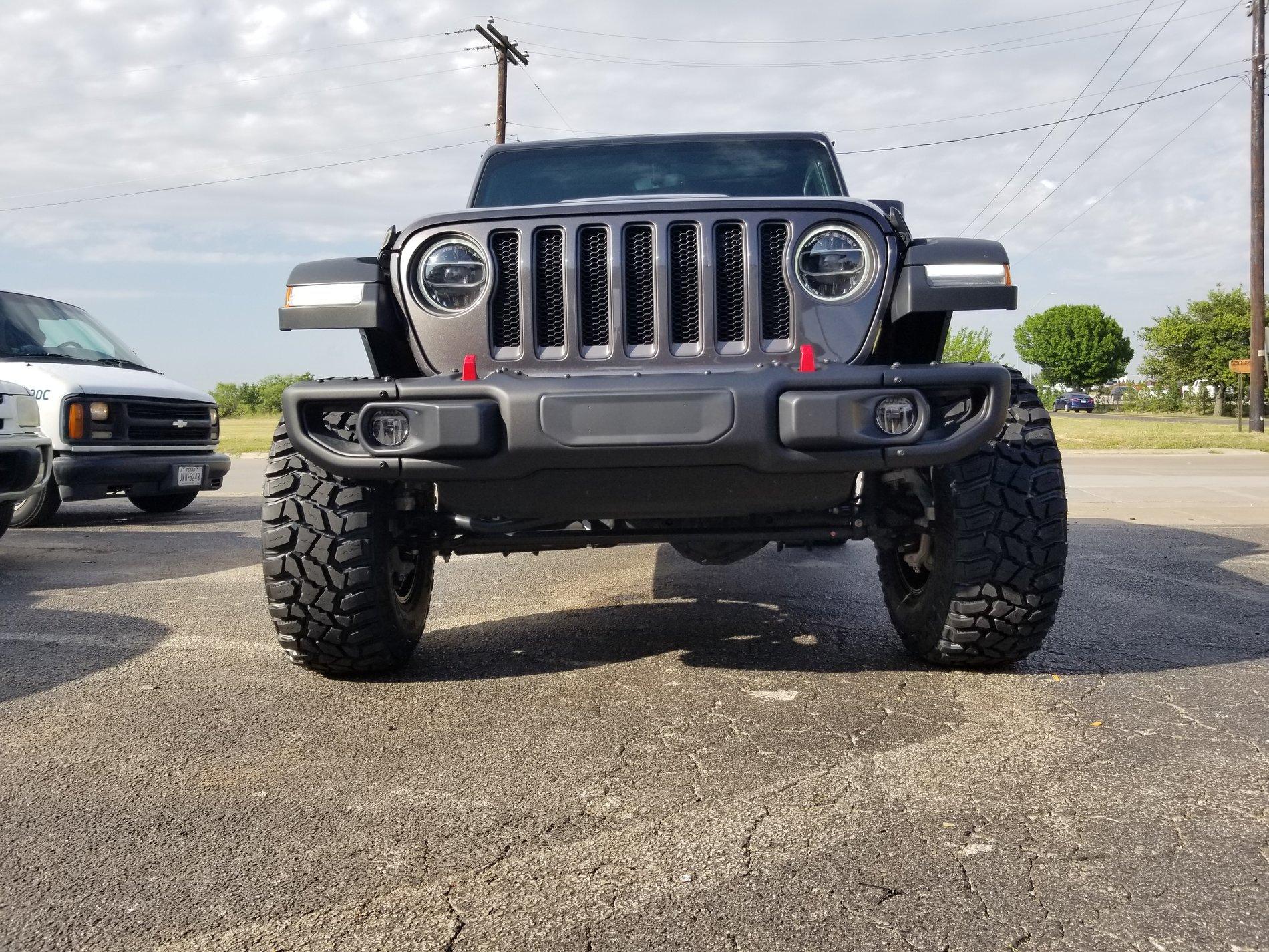

I did Rusty's Adj Track Bars front and rear with the Mopar Lift.. I'm OCD... wanted it perfectly centered.
Jeep looks great! How's the size and strength of the new trackbars compared to the OEM ones?
Didn't take pics but my opinion is they are more robust and very high quality. Zero worries of failure or premature wear.
