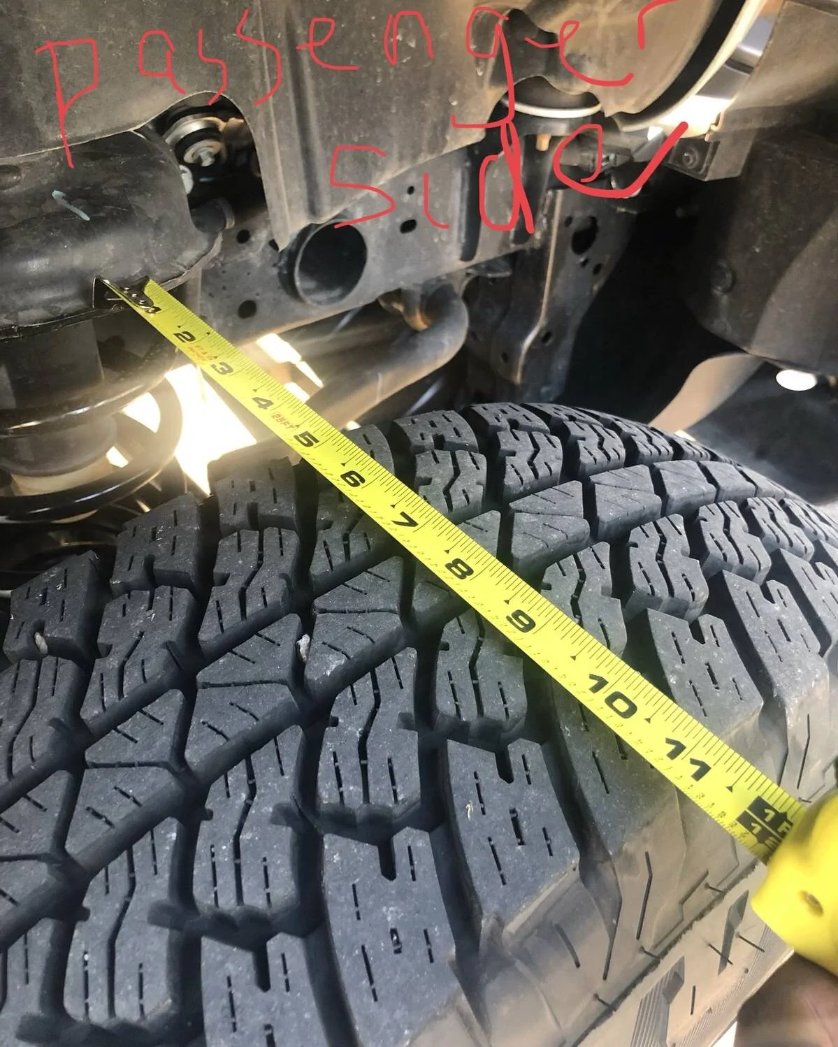

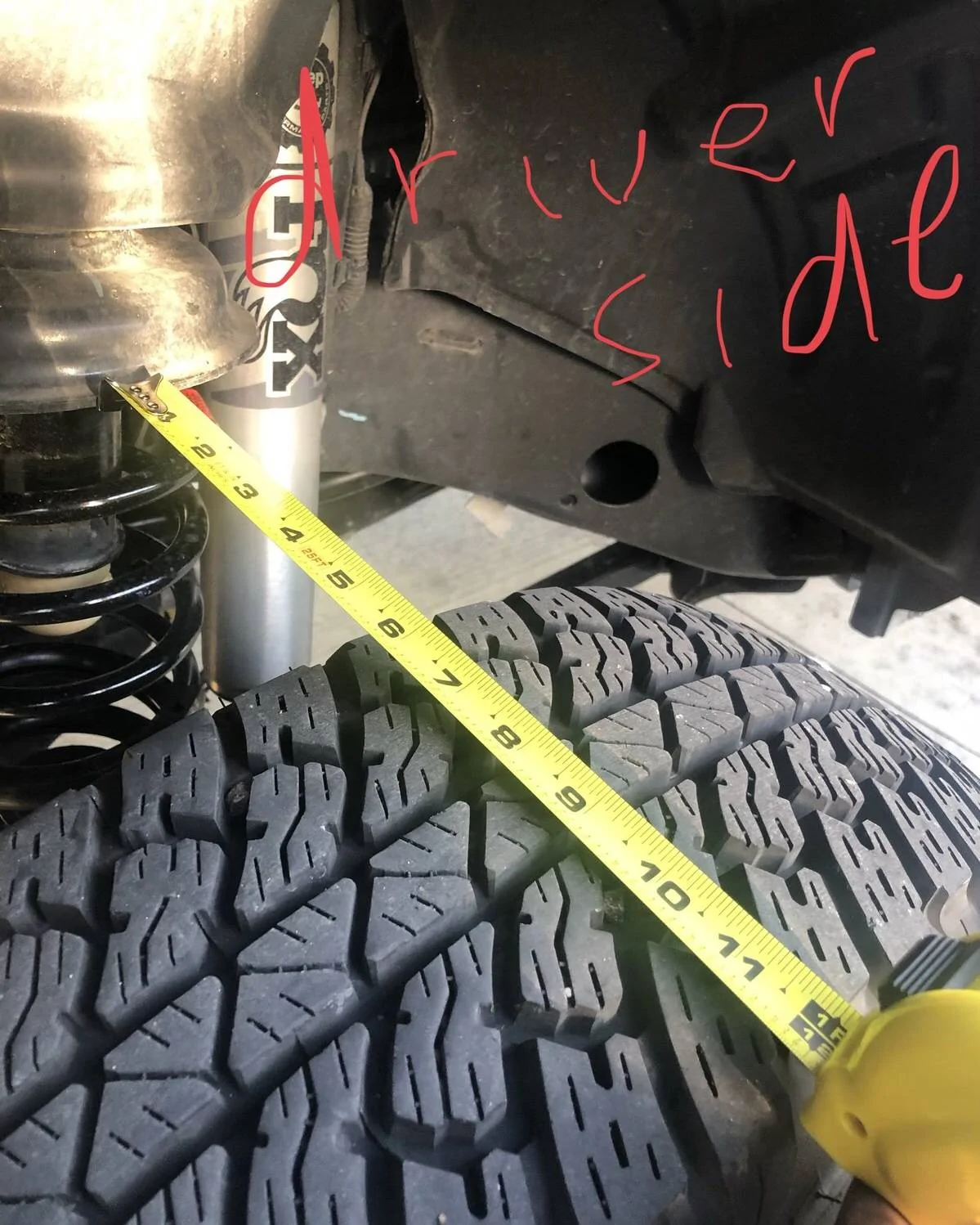

I’ve been reading instructions for adjustable track bars that simply say “center the front axle”
is there a tried and true way to do this from some known points or are we on our own to select some places to measure from?

Coil spring housing to outside of tire.
Jeep Wrangler JL Center front axle 2D2D3E91-61AA-4561-8E1D-5C123931EB9F
Jeep Wrangler JL Center front axle FDE3DA25-26AB-43BF-ACF5-ECBB3DFD99DF

Thank you, I was wondering if it was that simple. I tend to overcomplicate things.
