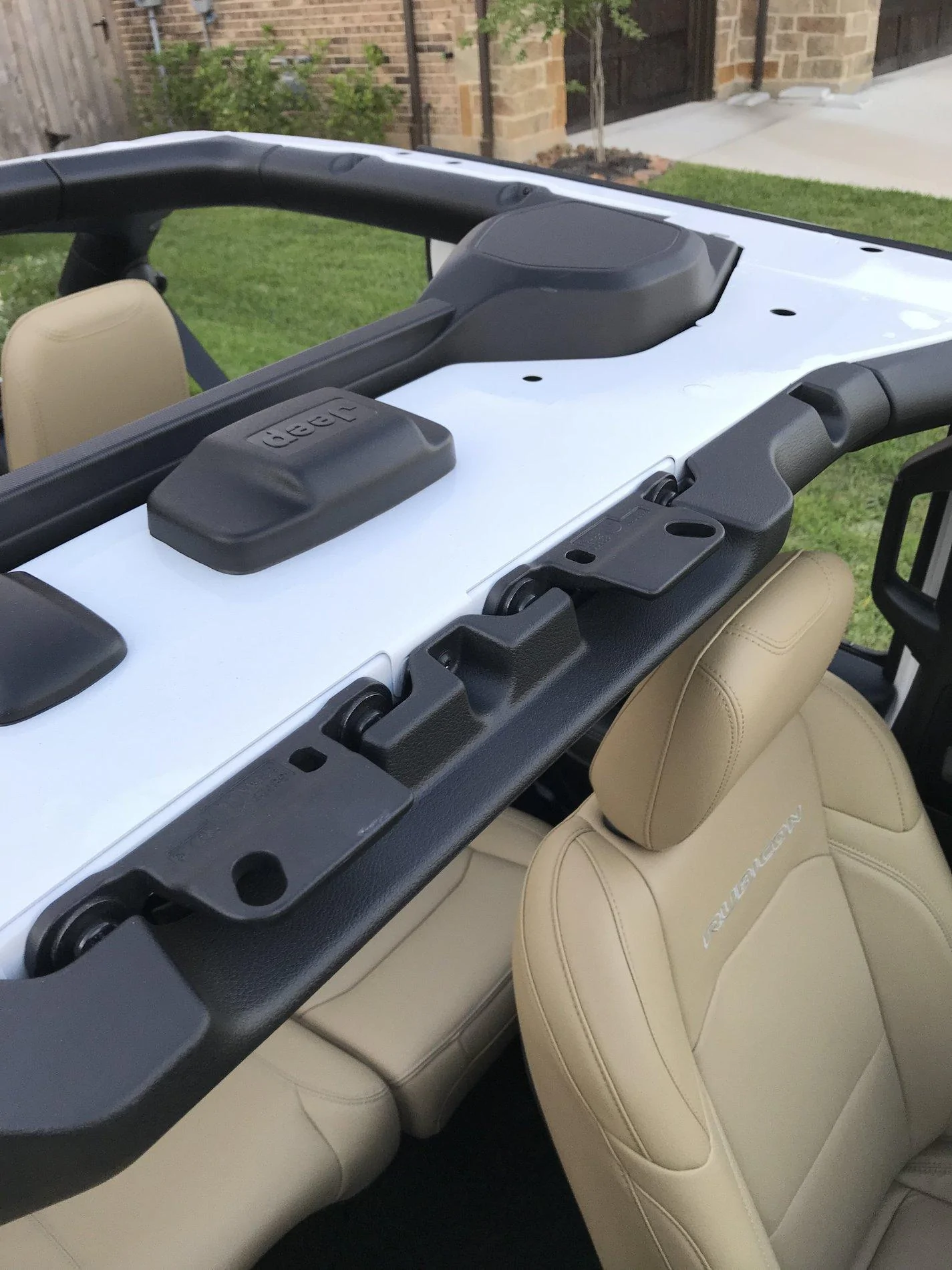

Idk, it looks like the indents in the sound bar look like they're there to allow the latches to reach the back portion of the hard top. I don't think the freedom panels would be very secure without it.
@BeeLDub
Yes, after that still pic you posted, I agree that it probably is not doable to use the freedom panels with the hardtop off.
Indeed, it looks like those indents in the sound bar are there to allow the latches/locks to get to the hardtop and lock.

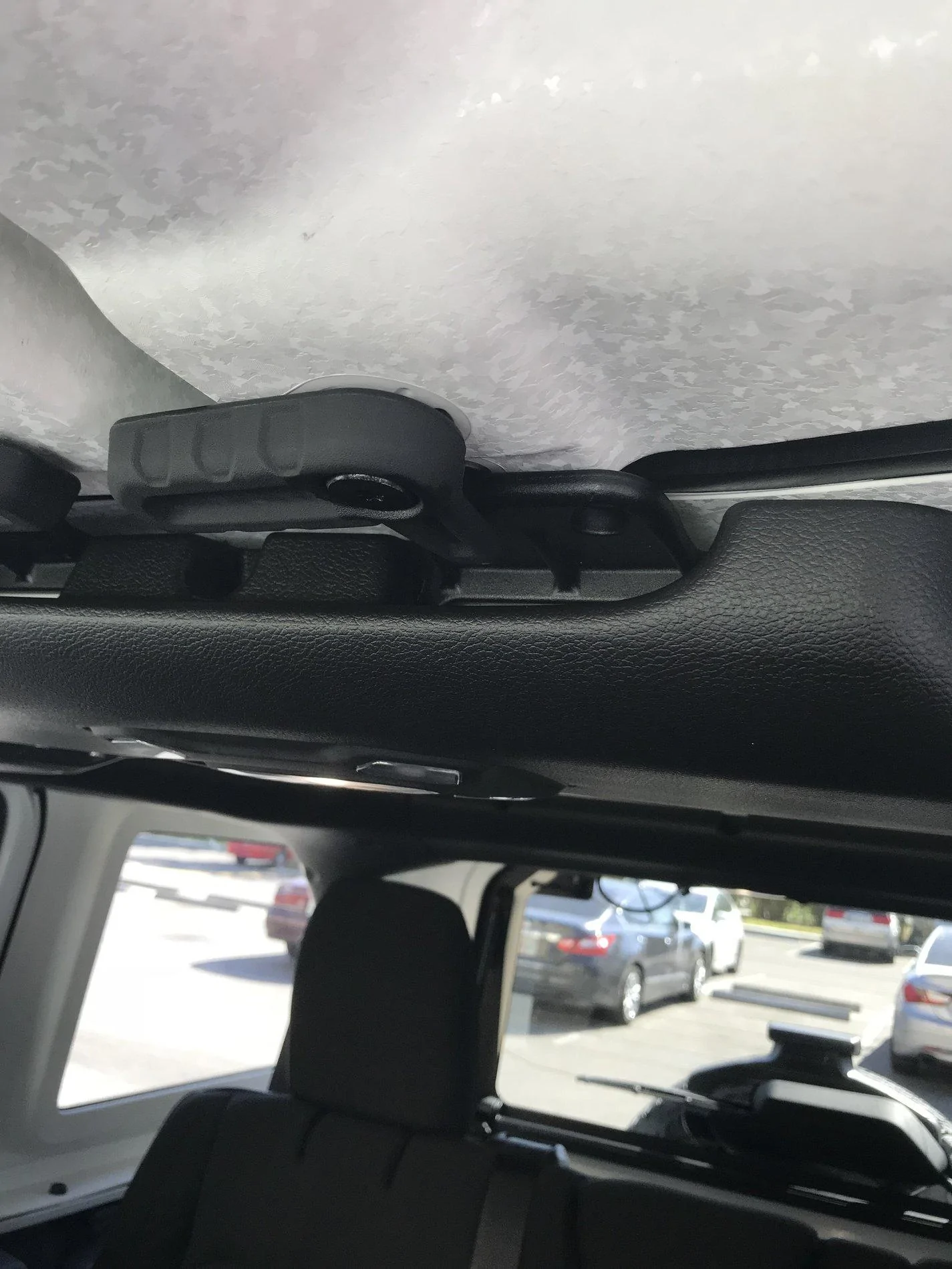

I just went out to my JLU and took this photo. The black tab that the freedom panel latch swivels under is attached to the sound bar, NOT the rear hard top. With the rear piece of the hard top gone all 3 latches + the front clip of the freedom panels still have their anchor points, so I see no issue with running the freedom panels without the rest of the top.
Well, with this important tidbit of info, I'd say yes, you can ride with the hard top off and the Freedom Panels in place. Or even just one Freedom Panel in place at that matter.

Sorry to revive such an old thread. I drove on I-80 today with no hardtop but the freedom panels on. They attach in 3 out of 4 spots (the latch closest to the door doesn't attach without the hardtop as far as I can tell). Anyway I drove 70-75phm for over 40 miles without issue. There were also 30mph winds and everything was secure and didn't budge.
Just thought I'd share.

I have used the freedom panels without the hardtop on my 2dr and it was fine. You just wont have the rear outside tabs that are on the top but you still have the inside tabs that are on the soundbar and even without doors on they are secure. I recently picked up a rugged ridge sunshade and im very happy with it and for around $50 the price was nice too.
