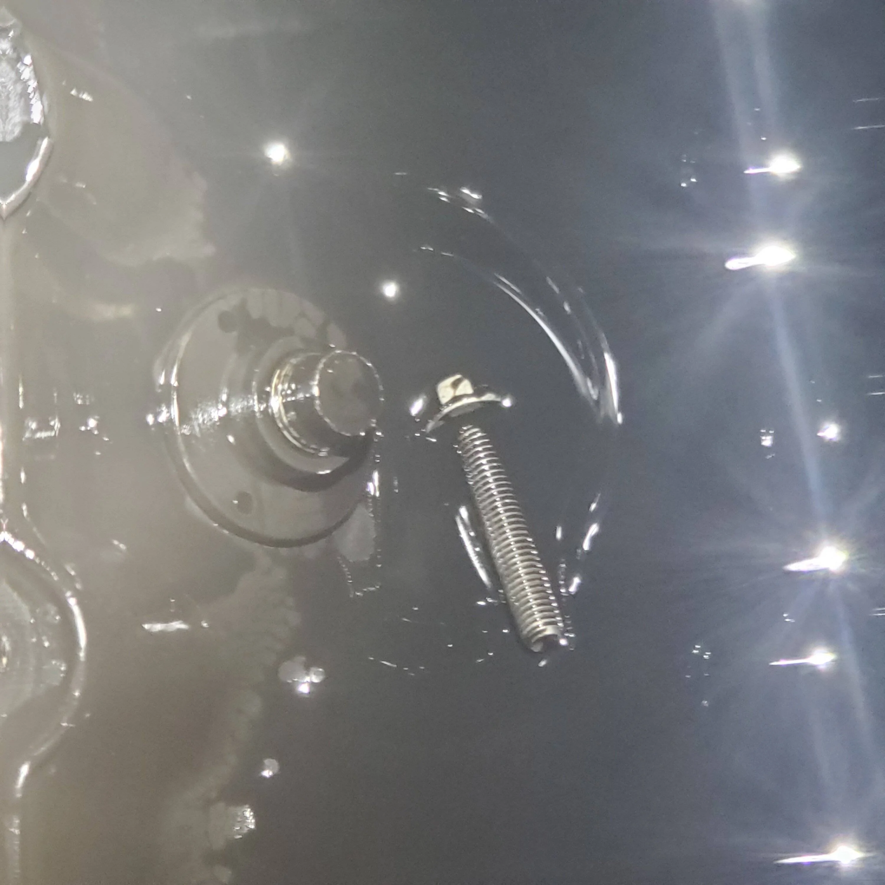

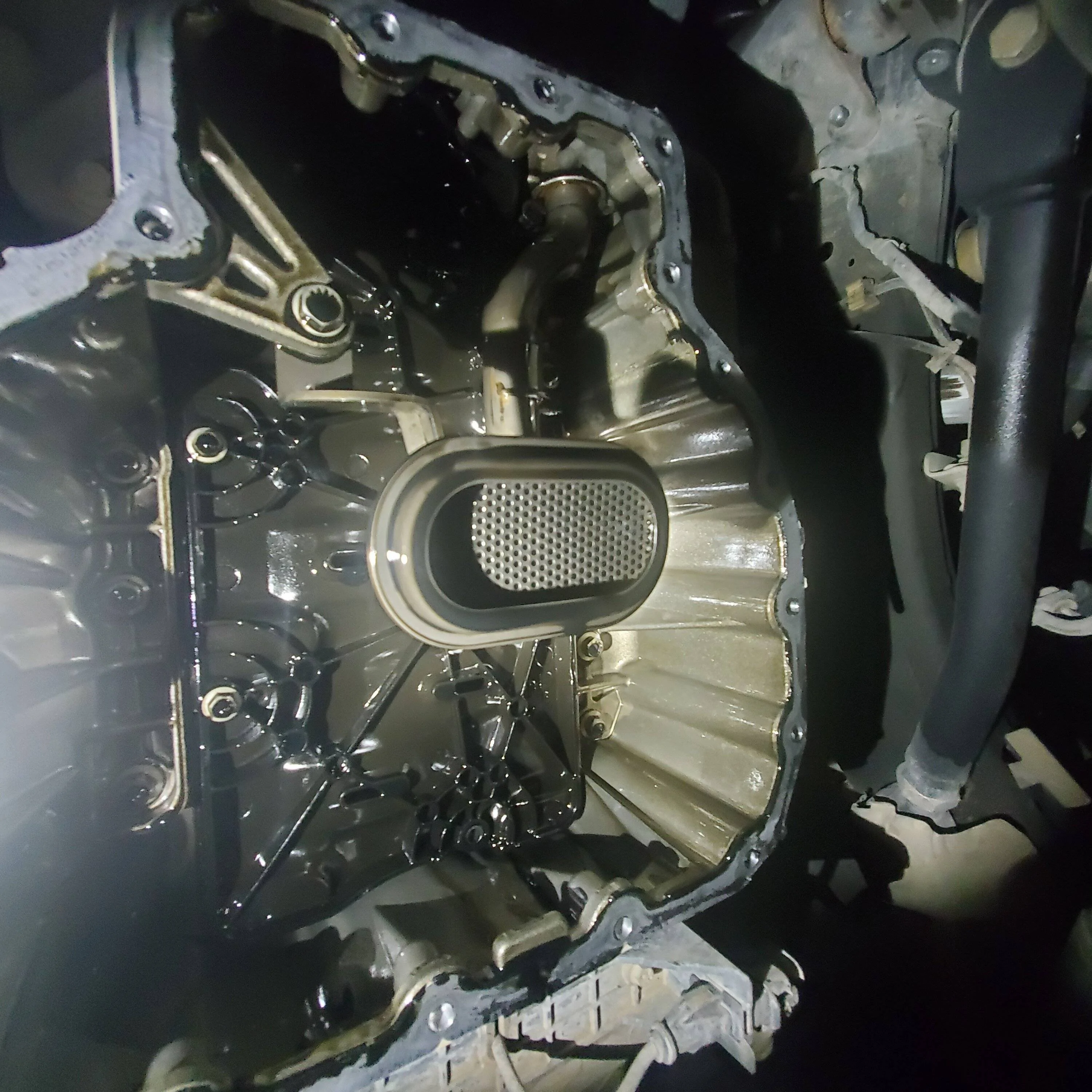

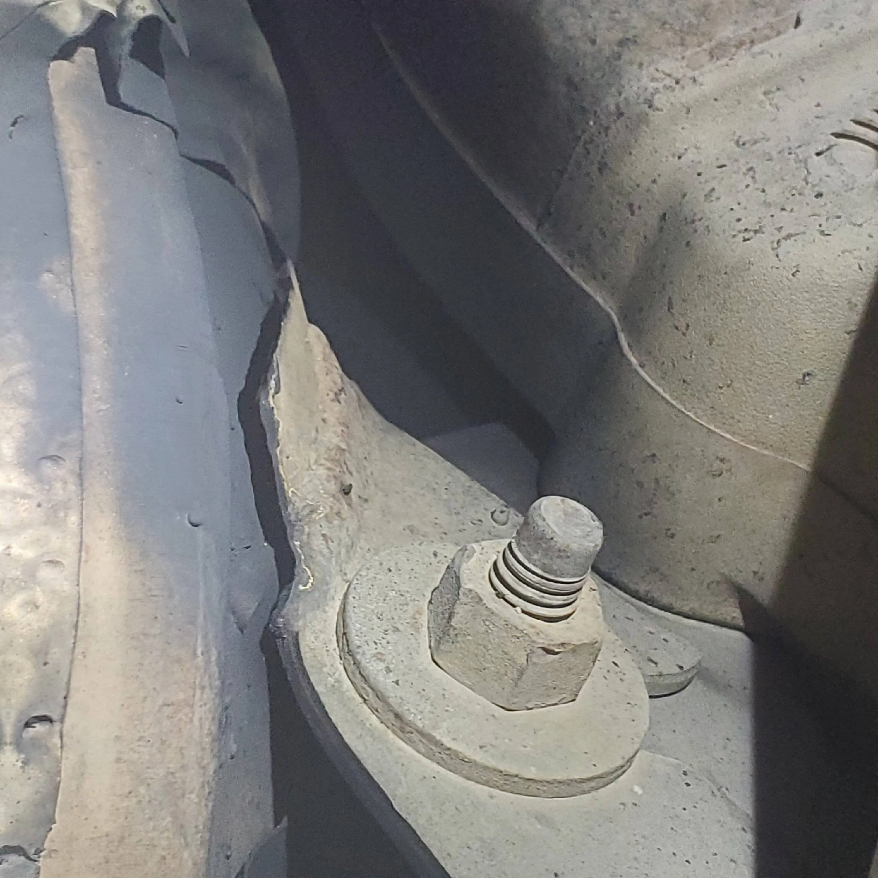

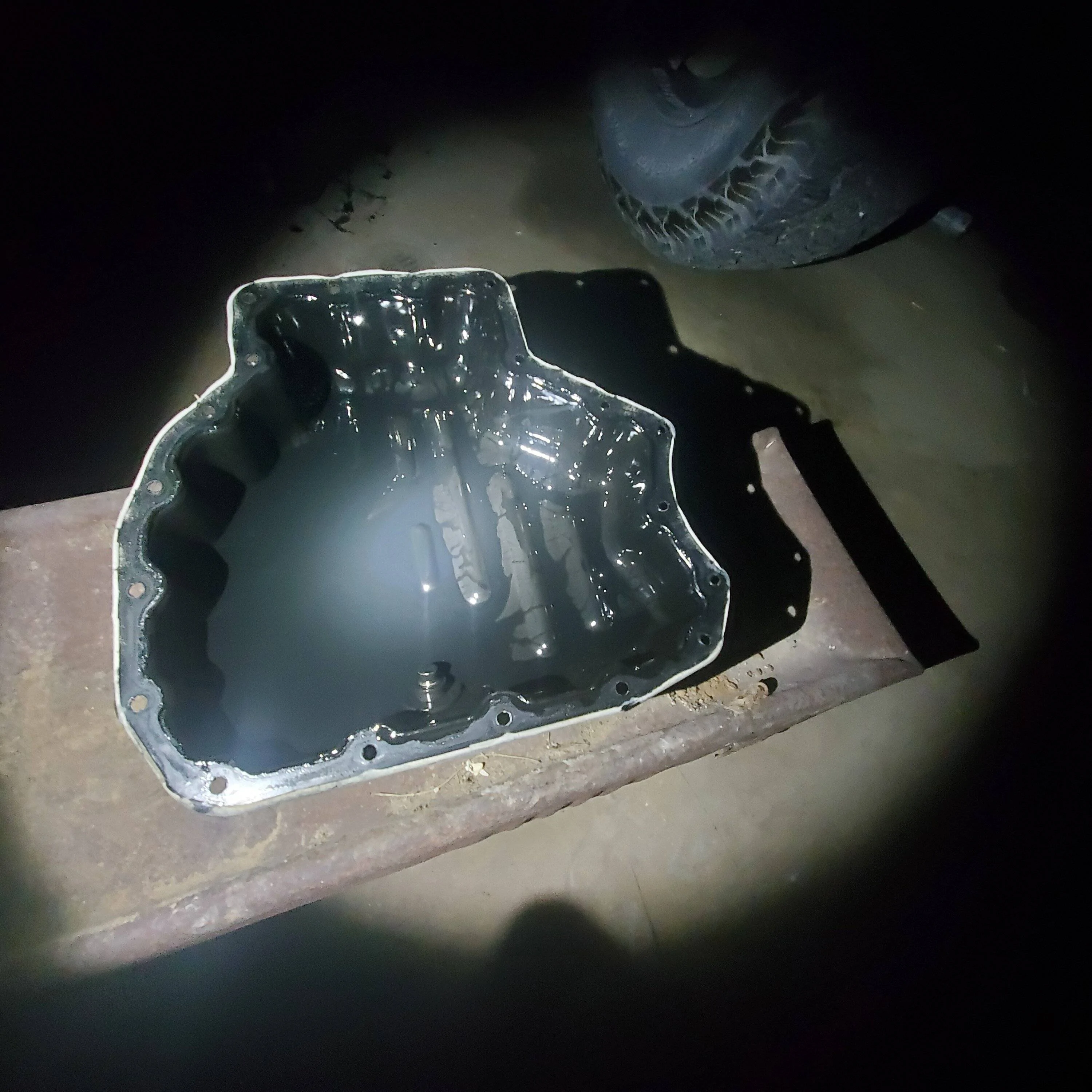

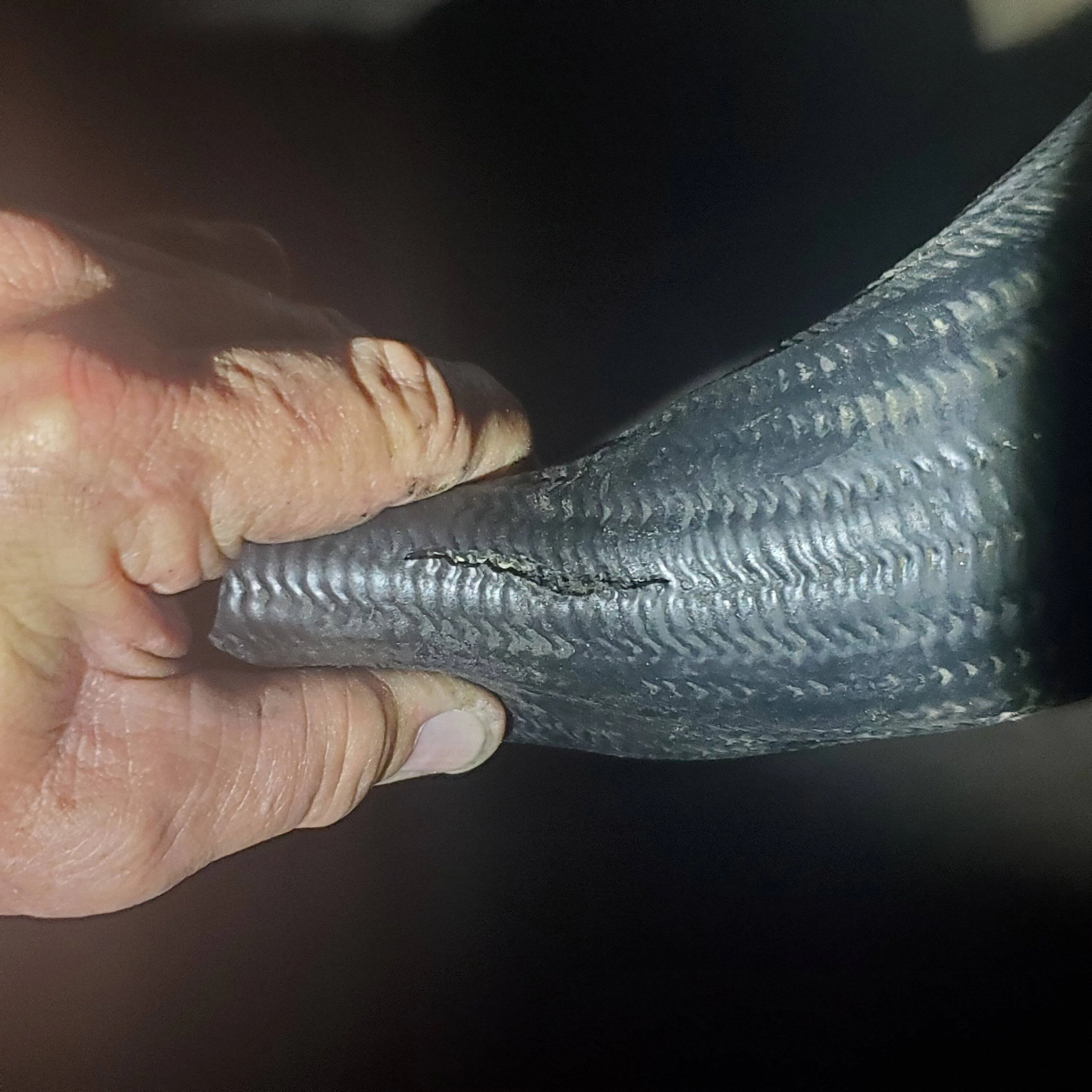

Good Evening everyone! I have a 2021 wrangler with the ecodiesel with 86k on it. A couple of weeks ago I started to see smoke coming from the right front wheel well along with a burning oil smell. My stealership here is so backed up! It would be several weeks to get it looked at. But if I wanted to leave it until then would be ok! What a joke! A week or so after that I got a CEL with a P026D code I do believe. A different stealership said they could get to it the next day (Thursday). I heard nothing until Tuesday. Obviously, nothing was covered under my 5yr/100k powertrain warranty. According to them I needed a new upper CAC duct (hose) and a new catalytic converter. The hose was causing the CEL . And the converter mounting bracket had broke and caused a crack in the converter where the smoke and smell was coming from. I'll attach some photos! But the interesting thing is! With this being a Gen 3 ecodiesel, I was concerned about if the new design of the EGR system was still leaving garbage in the pan clogging up the oil pump screen. So, doing my oil change tonight, I couldn't help my self! I pulled the lower oil pan off. Looking up at the screen, it was like new, Clean. I thought ! Amazing! I glanced into pan. Again, looked clean for 86k! I crawled from under jeep and took a closer look into the pan! This is what was interesting! See photos! Good Night All!

What’s up with the random bolt in the pan

Maybe the person that assembled the engine tossed it in there just to give you a scare. Or he was looking to get fired.

You might consider checking your emissions warranty. “Catalytic Converters” are covered for 8 years or 80,000 miles. The cracked bracket has been showing up quite a bit recently.
A good dealer will go to bat for you when you’re that close to the mileage limit.

I don't think we have any of those dealers in Texas! If we do! I haven't found one!
