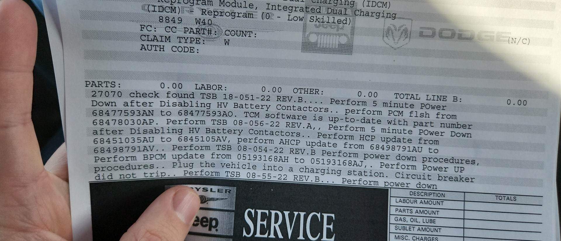

Anyone know if this bulletin would apply to a 2023 made on December 14, 2022? I see it says model year 2022 on the bulletin but my vehicle was built a few days before the TSB date. I had to go to ridiculous lengths and burn a quarter tank of gas to finally get out of FORM is why I ask.

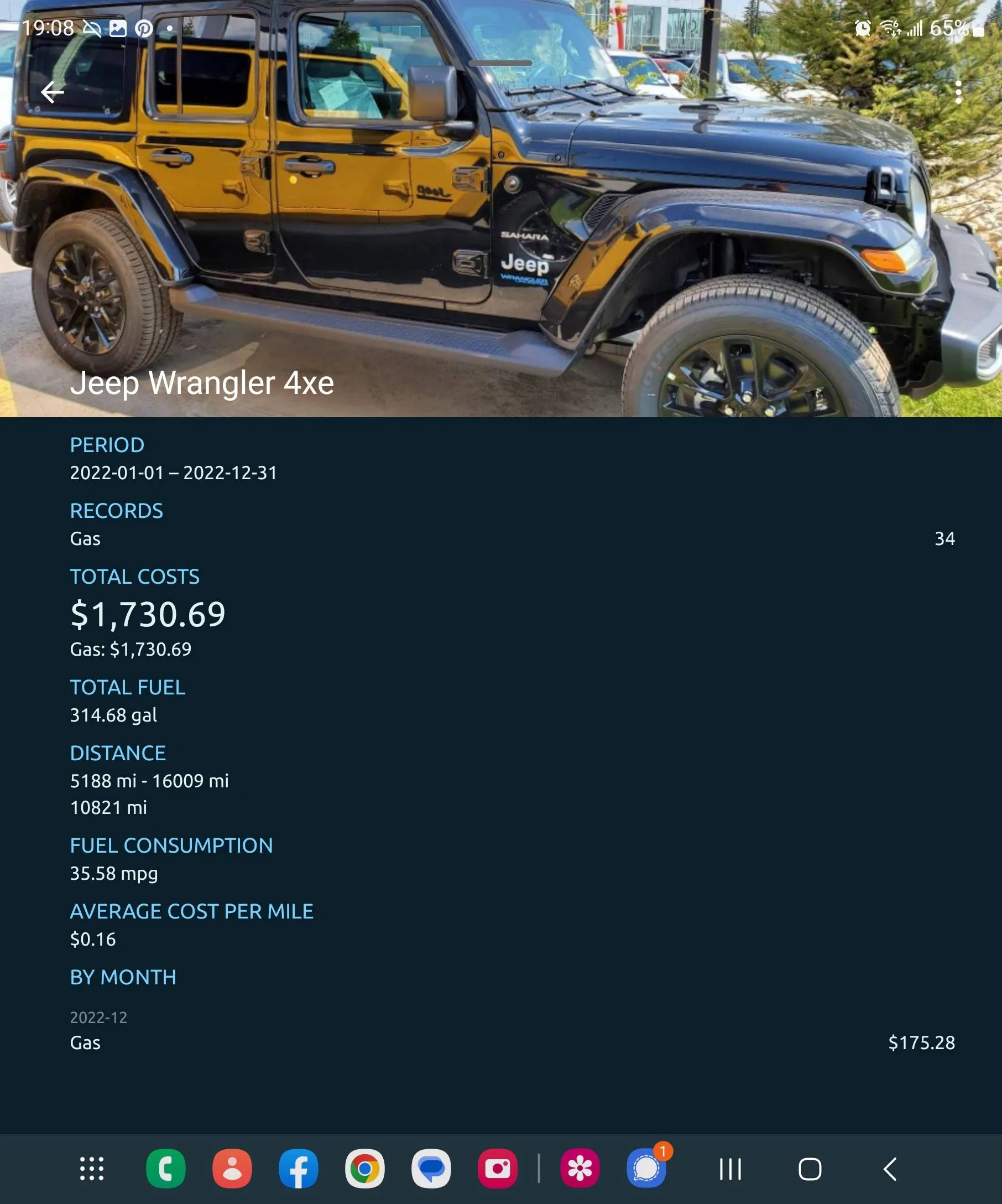

Agree. The 4xe is not perfect but still my average fuel mileage even with form half the year
Jeep Wrangler JL FORM Screenshot_20230208_190841_Fuelio
is great for a jeep.

Pretty impressive! If I didn't commute 20 miles each way and could do more driving in electric mode, I'd probably see similar results.

Yeah i do 6 mile to work. Everywhere i go in my small town is max 10 min drive. So that why I can never clear form unless you drive out of town. But still my average is awsome. I can drive multiple month in the summer without refueling. As long as your average yearly fuel is less then a regular wrangler is, to me that a win. Thw 4xe is also more fun to drive due to the extra weight and power. Also on that picture, that canadian dollar. So even less then USD$. Fuel in Canada is way more expensive then in the US.
