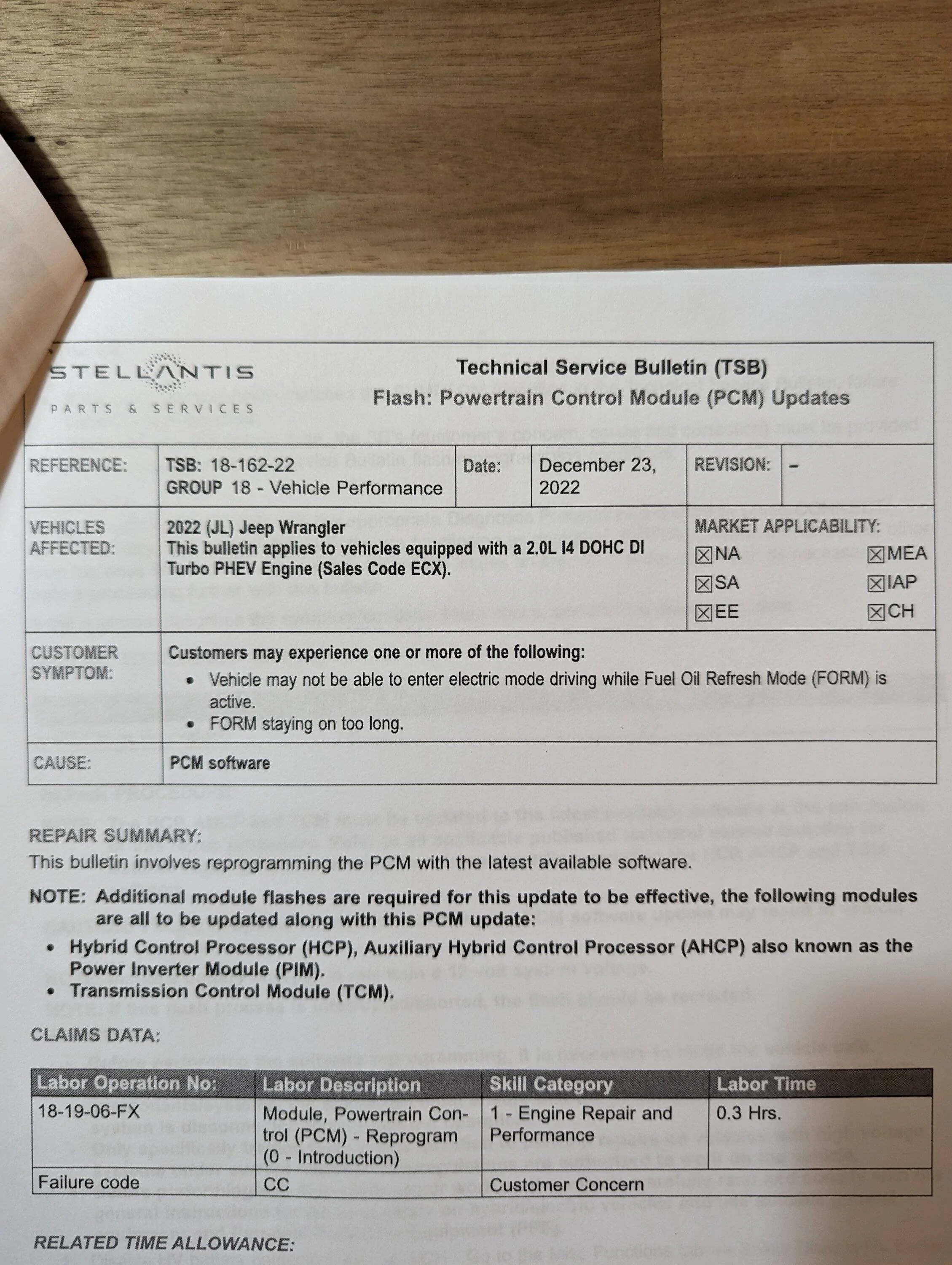

This would be interesting, but I don't see that TSB reference number anywhere on the NHTSA website.

Does your rig stay in electric after shutdown and restart, or do you have to press button again (defaults back to hybrid mode)?

ZB7 is a recall for 21 and 22 4xe

Got mine done a week or so ago, but still no latching. Mine's a '21 which seems to be hit or miss for latching. I was an earlier production model, so maybe that's why.

Got this TSB update done last week
Were you having an issue where you 4XE stayed in FORM mode for an extended period of time? Did this update resolve the issue?
I’ve seen people complaining about this issue a lot, so I’m wondering if jeep acknowledged that there was something wrong in their software that caused the cars to stay in FORM for too long.
