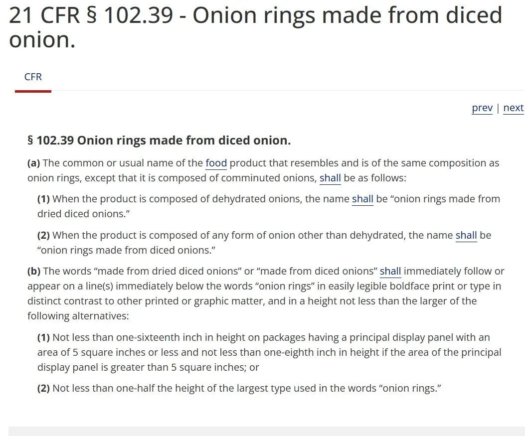

On that note, and a bit of humor, I bring you an actual law. Enjoy. I wonder how many of you think our government is maybe doing too much tomfoolery? We need a poll ;)
Jeep Wrangler JL For the Naysayers: LED Replacement Bulb Beam Pattern onion rings

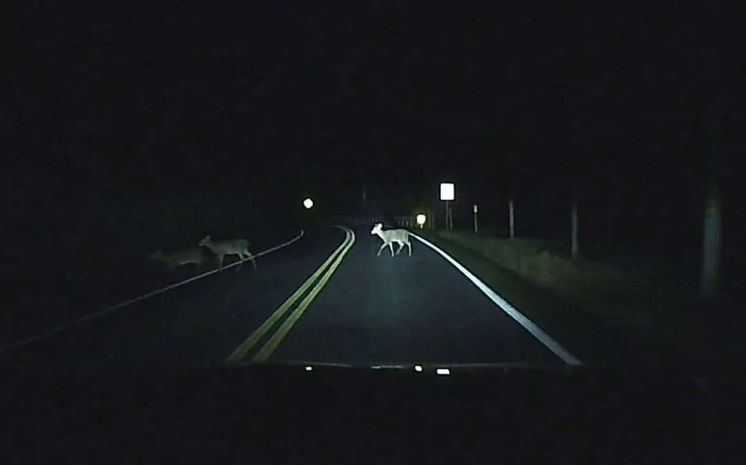

I've LED retrofits in my JLU's OEM halogen housings. It wasn't money or time that I wanted to spend, but the factory H13s are easily the most underwhelming headlights I've ever used. Even after raising their aim a bit, the illuminated down-road distance remained so modest that it was still too easy to occasionally overdrive the headlights, even at non-Interstate speeds.
I was careful to aim the LED H13s so as to create a balance between usability and minimizing being flashed by oncoming drivers. It took some time but a happy medium was finally established. Needless to say, the improvement in forward visibility represents a concurrent increase in driving safely...which is no small matter as the following photo makes very plain.
I care not a whit about the new bulbs' alleged legality or otherwise, and am firmly on the side of the OP here. :beer:
