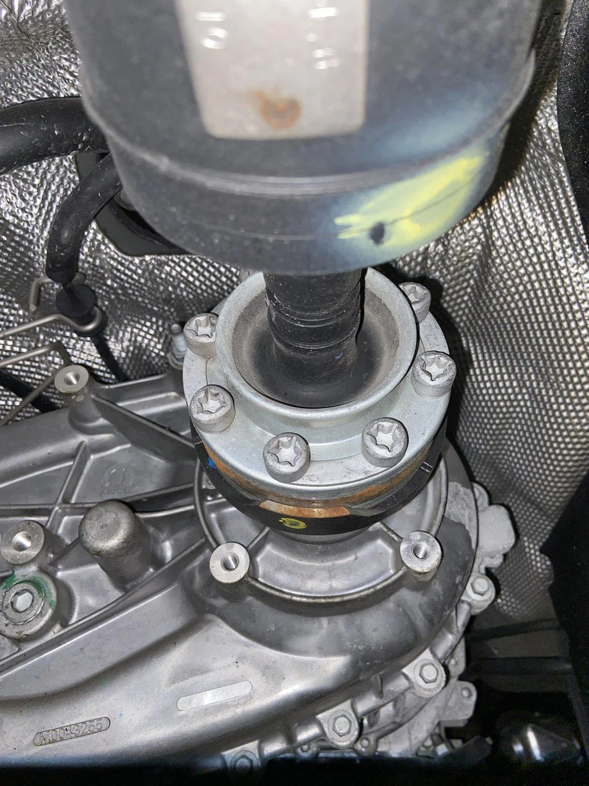

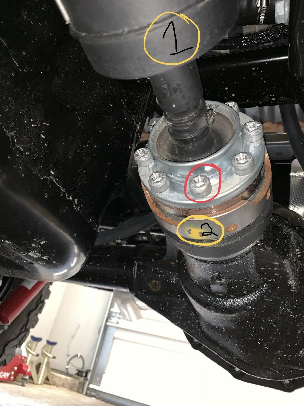

Thank you for all the detail! Does this mean they are being balanced incorrectly from the factory? I wonder if there are issues we can cause by rotating this.Remove all eight bolts (circled in red).
Use a flat head screwdriver to pry the driveshaft apart from the yoke.
With the rears wheels off the ground, rotate the yoke until yellow dot (1) and yellow dot (2) are 180 degrees from each other. The two yellow dots should be lined up from the factory.
Bolt everything back up and take it for a spin.
If that fixed your problem you'll want to take the bolts back out and apply some blue locktite.
