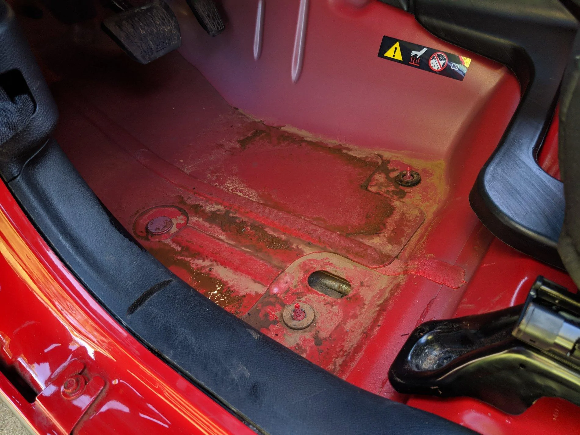

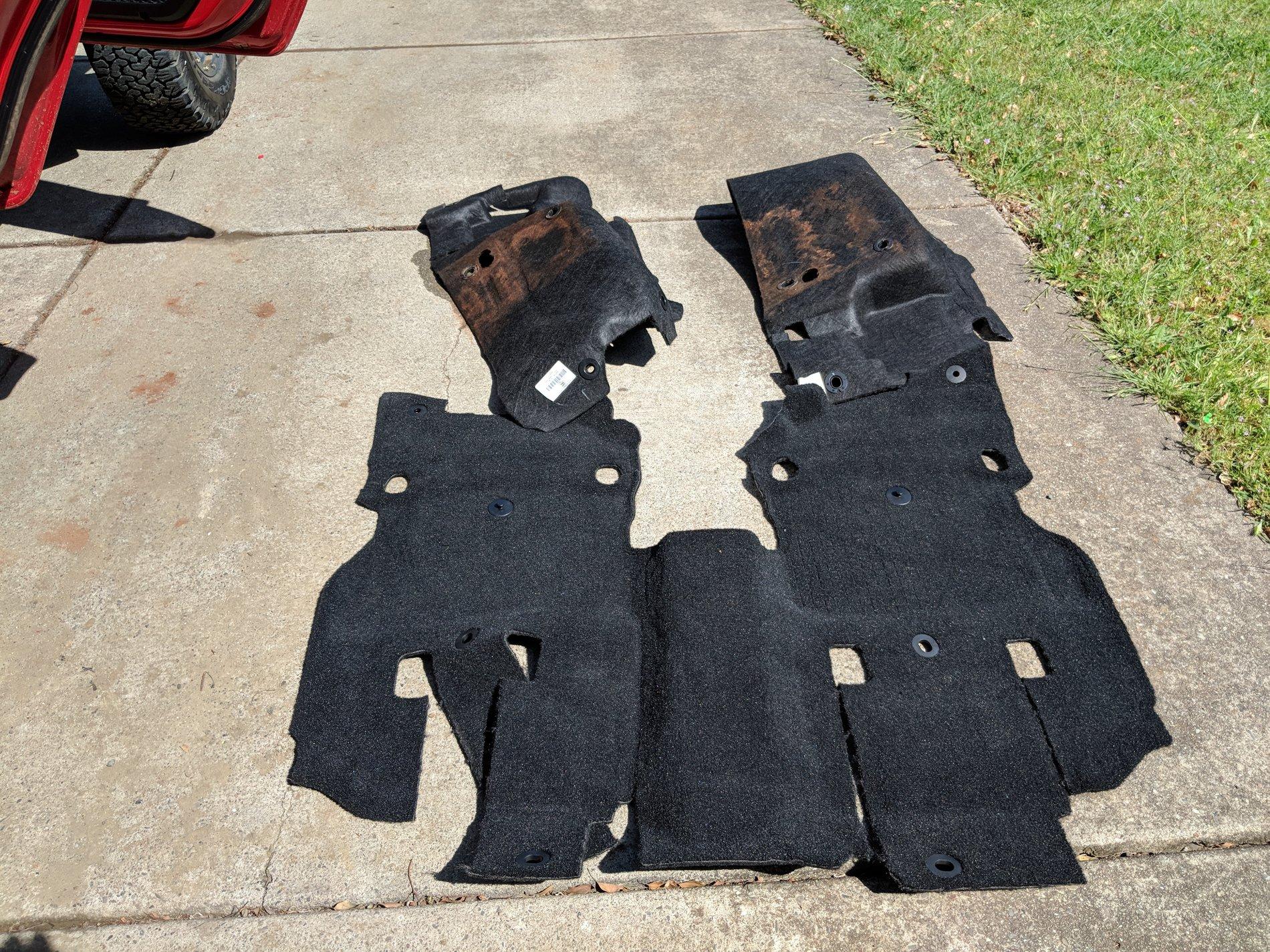

I have the Mopar all-weather mats installed in my JLUR - and utilized the drain plug in the top of the mat itself, as they are designed for,
And I forded about 30" of muddy water a few times in it. The next day I noticed my driver and passenger side carpets were drenched in muddy water. I have since removed the drain plugs from the mats and placed them back directly into the metal floor - and removed the carpet from the front/back of my Jeep entirely. I'd rather have no carpet than to potentially have to clean them again later on.
Here's a few pictures of the mats after removing them.

Interesting. The plug fits into the floor liners just as tightly as it does into the floor tub itself. If one leaks, you'd think the other one would too. If one keeps water out, the other should too. Odd. Are you sure you got the liner pushed down into the hole in the the tub all the way?

Yep - was installed correctly. It clearly leaked around the drain port itself. I got 0 water up on top of the mat - it was all below the mat in the carpet.
The drain port on the mat clearly doesn't provide a great seal in the drain port of the floor.

This is what I would expect. Especially if you take them out once every couple of weeks to vacuum around them. Not to mention that the mat is separated from the floor by a spongy rug. Every time you get in you are moving that area. It’s bound to eventually leak.
