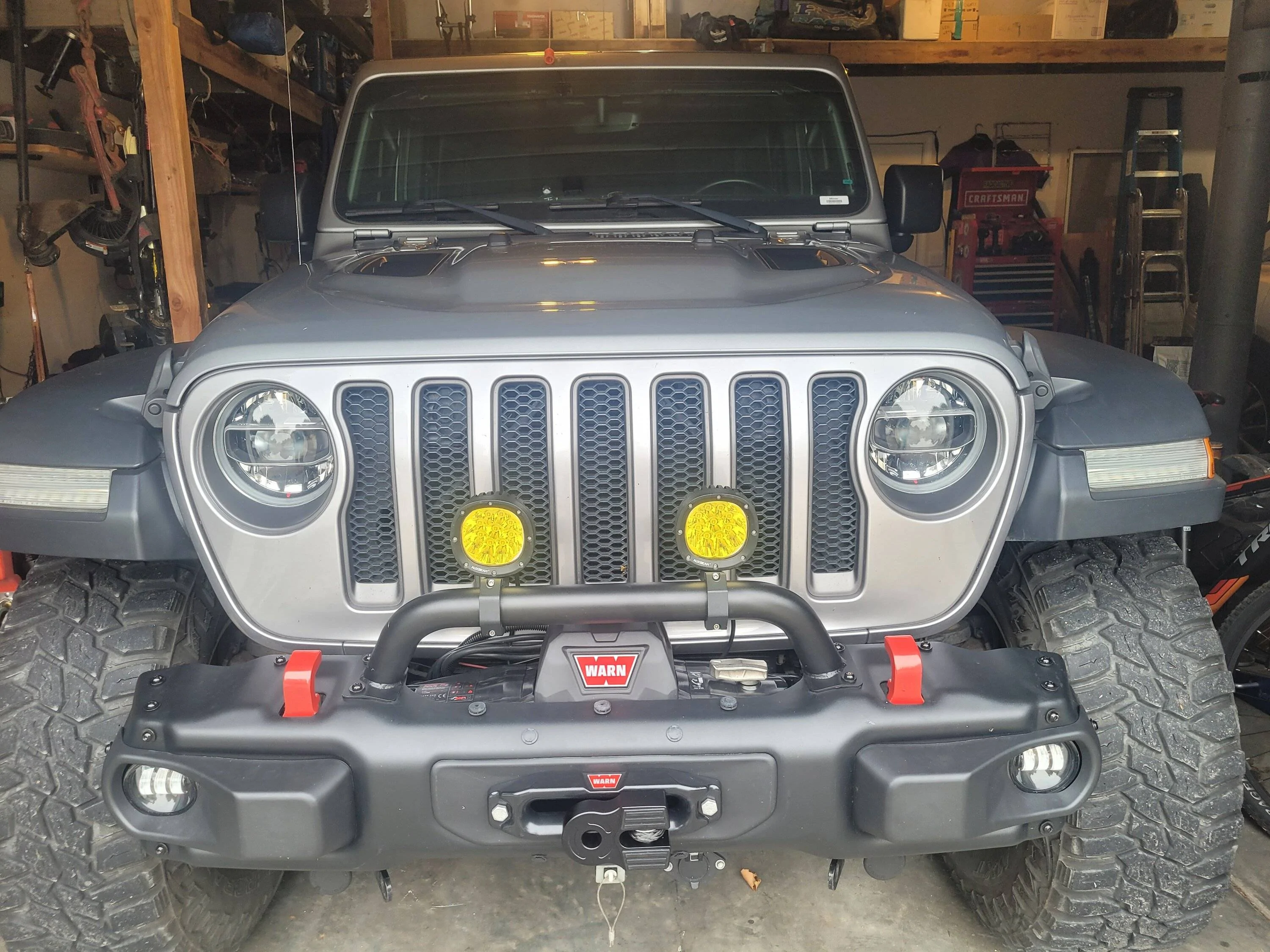

I used the first generation Maximus-3 loops on my previous Gladiator with a Blue Ox towbar. There were problems with the 1st generation. Bending, Jeep frame damage. M-3 changed the design and added a tie rod to the system. Lots of info about this on the forums. I wasn't happy and didn't like the tie rod. Went with Roadmaster direct connect with a modified winch plate on my JLUR. Works great and they don't hang down as far.
