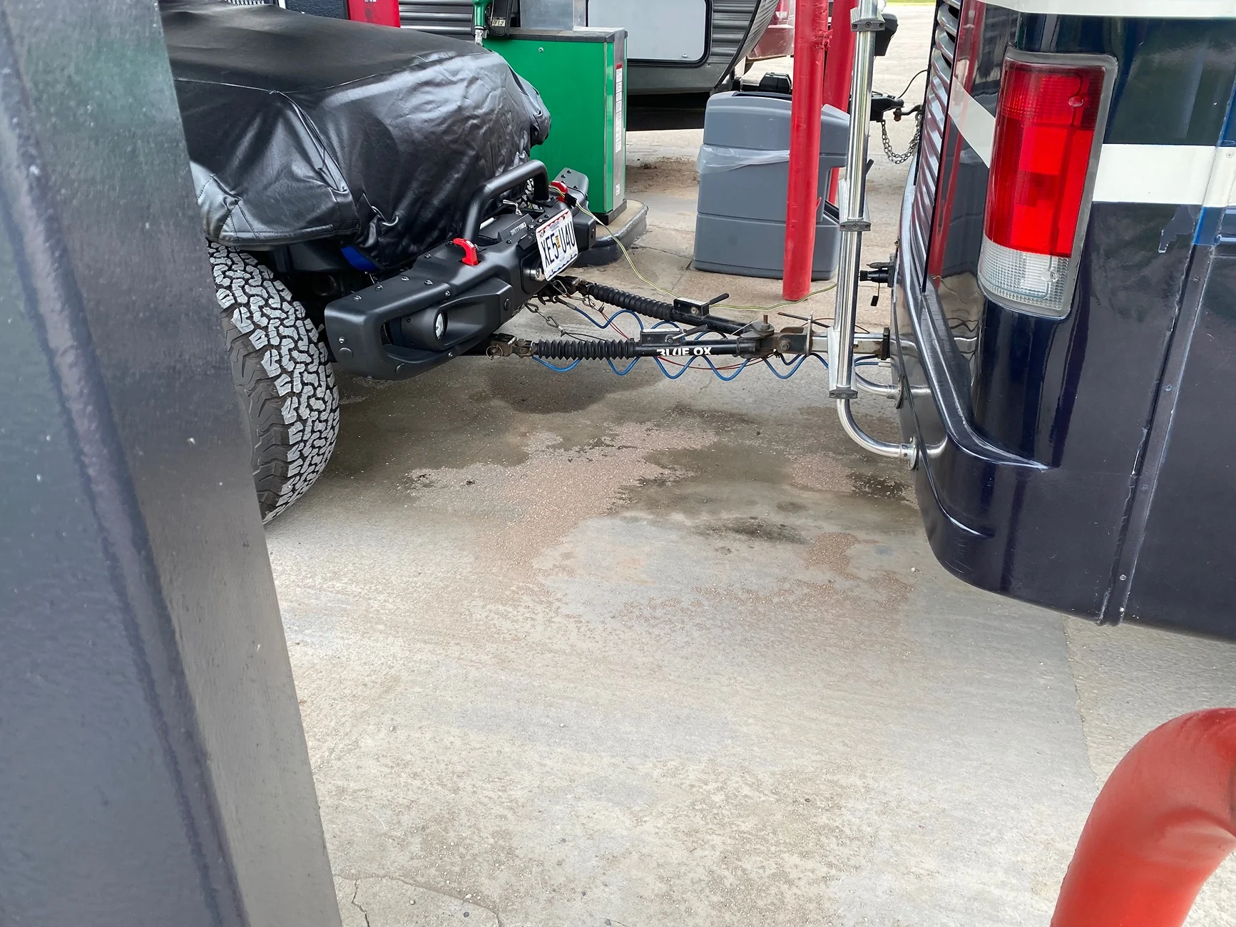

I have a 2021 JLURD w/ LED light package.
4-down is easy and quick.
I use a a Rock Jock base plate. There are versions for factory plastic and steel bumpers. Maybe other bumpers, too. A lot of options out there. Depending on your bumper, you may be able to use the D-ring loops.
I run an obsolete Blue Ox tow bar with integrated braking. Fully mechanical (diesel is limiting). You will need a braking system for the Jeep under tow. There are many options out there.
Tail lights wired up with a Curt wiring kit. Runs front to rear, no splicing.
My setup can be hooked up or unhooked in under 5 minutes. Tow bar stays on RV, other parts in a small storage pouch.
I do run a front cover on the Jeep. That takes another 5 minutes.

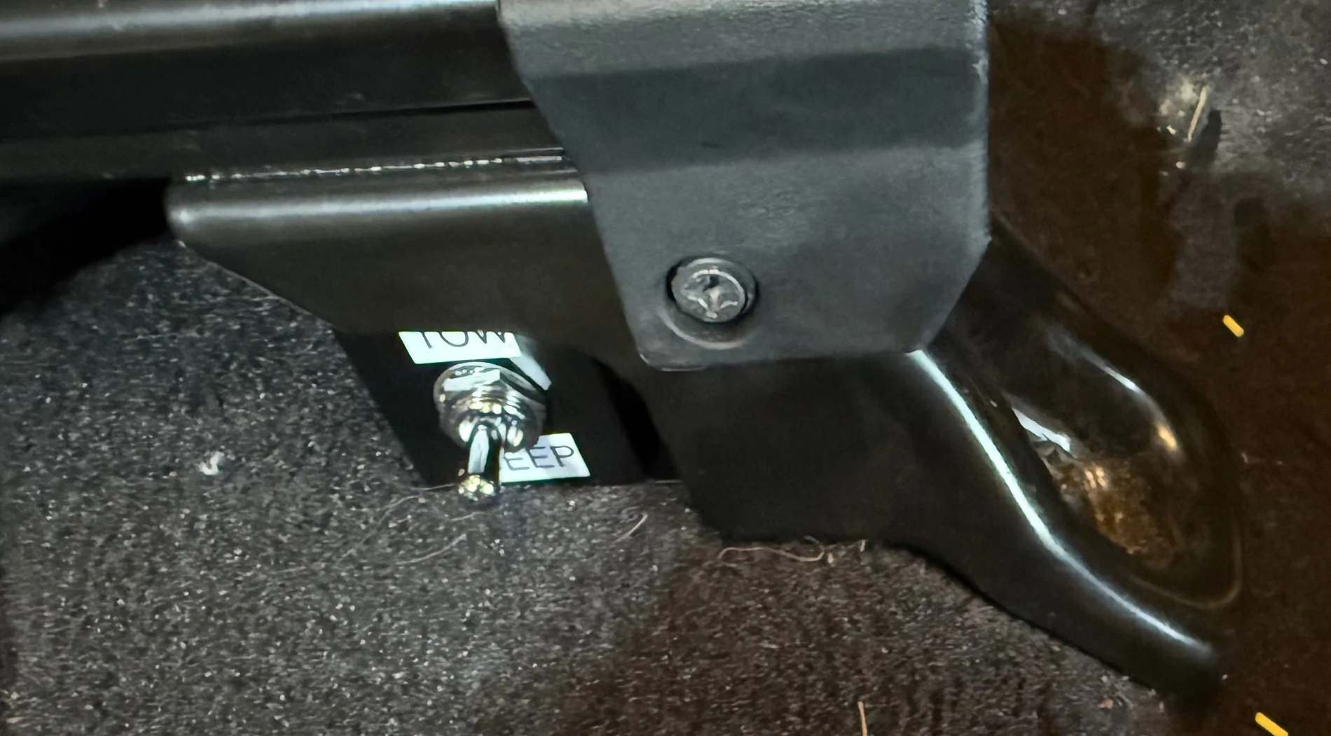

My set-up is:
  • Blue OX non-binding towbar on the motorhome

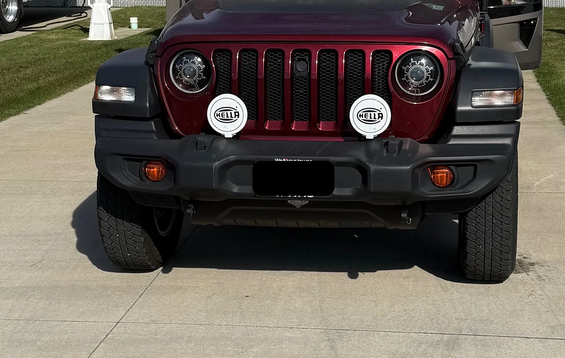

  • Maximus-3 tow loops on the Jeep (basically invisible when not in use- see pic)
  • Cool Tech towing harness for the lights (Flip a switch, and your lights are good to go.)
  • RVi towed battery charger (No dead battery when you get where you're going.)
  • Patriot Brake system (It's a good choice, but wasn't what I wanted. However, since it came free with the motorhome, it's what I use. It works well, and I'm not spending $1500 to replace something that works!)
I installed everything on the Jeep myself, and while none of it is "Plug-n-play easy", it's not really hard if you like working on your vehicle yourself. You might even use it as an excuse to buy a couple new tools!;)
Also, if you are going to attach the towbar to your bumper, MAKE SURE IT'S RATED for that. Many are NOT. The nice thing about baseplates and the tow loops is that they are mounted DIRECTLY to the frame.

My set-up is:
Your installation looks very clean, but there is more than one way to skin a cat. :)

That works too! The "installation of your lights" is a LOT easier than me running the Cool Tech harness, although mines customized to also go to lights mounted on a bike rack on the Jeep's rear hitch. When I do have bikes on it, you can barely see the Jeep's rear lights.
